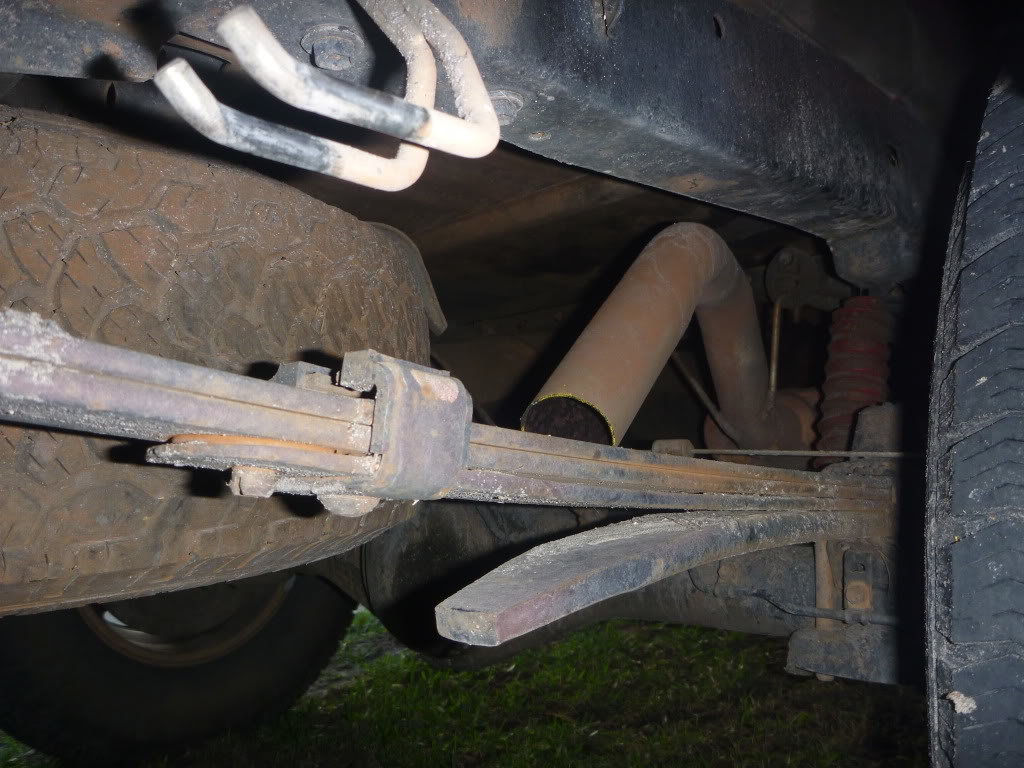

    What'd you guys use to chop off the exhaust? A grinder? All I got at the moment is a hacksaw but I don't think it'd work that well.

    I used an air rotary cutoff tool

    reciprocating saw works well but its harder to get it to tight spots,rotary air grinder is ideal. hacksaw would work but it would take forever and a day no doubt.

    I used a sawzall. You can use a hacksaw, it'll just take a little longer.

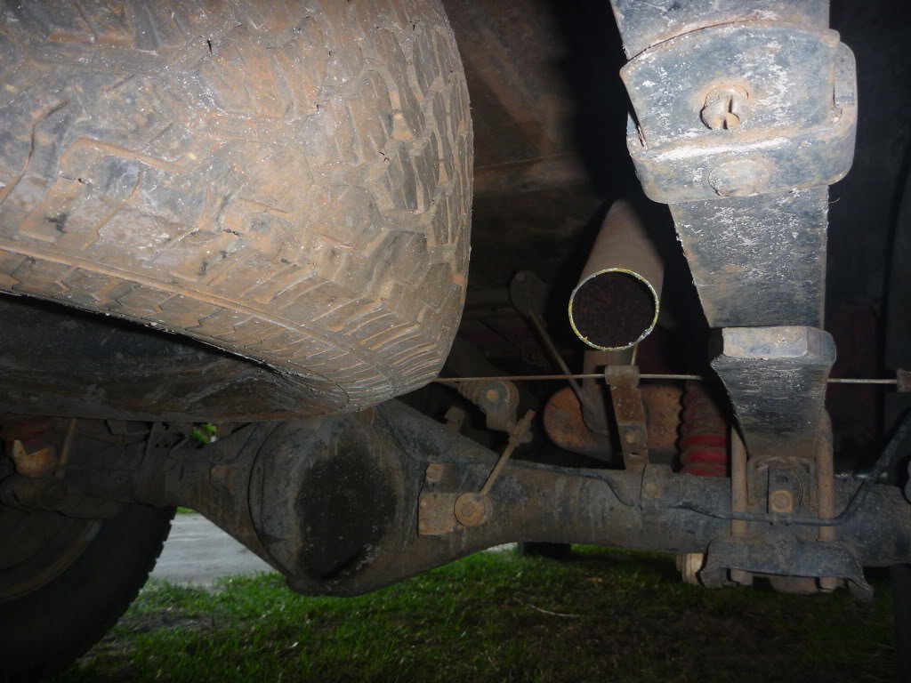

    Reciprocating saw with "metal" type blades worked great...thanks guys.
