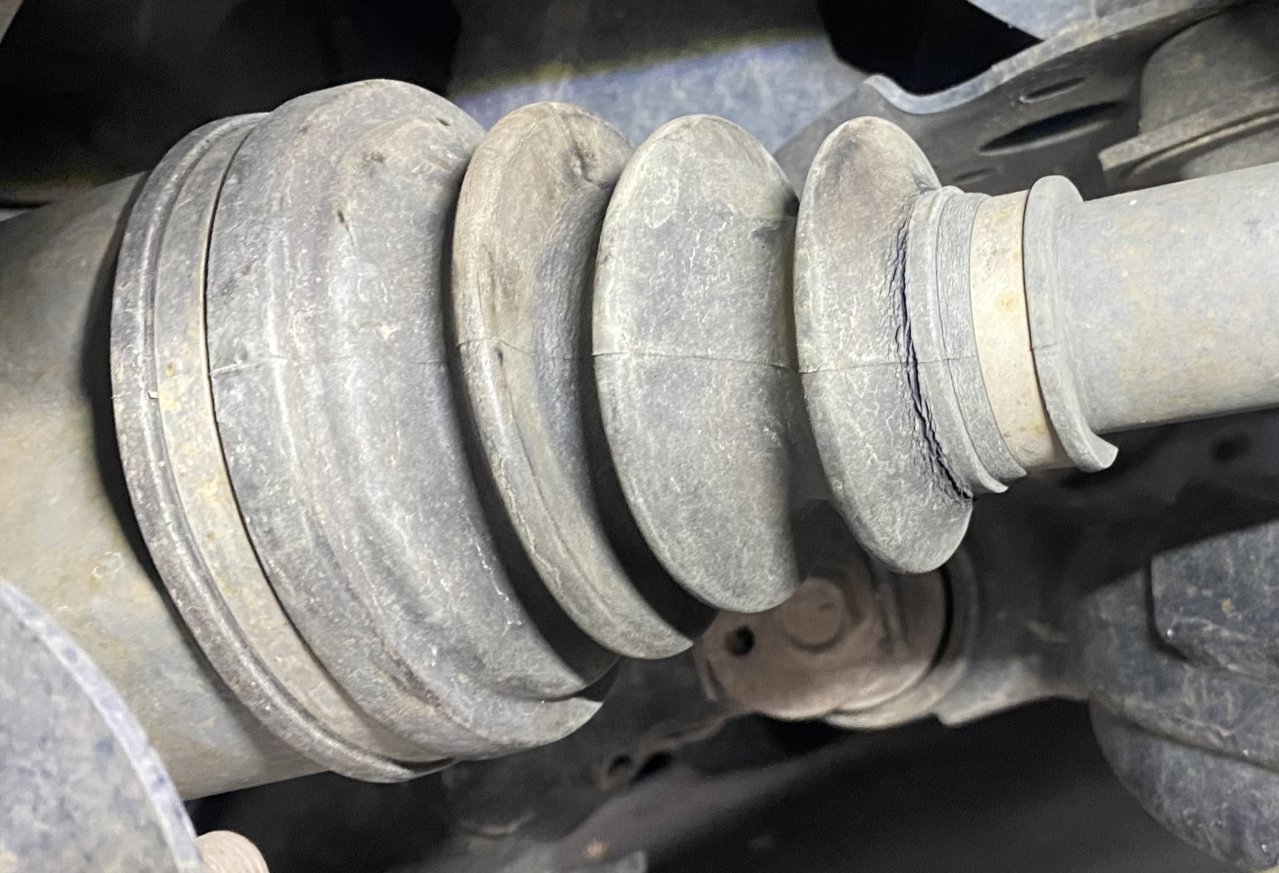

    My experience with Cardone CV’s has been terrible. Within one month, one of the boots tore, and I had to replace it. Now after a year and a half the seal on one boot has failed and all 4 boots (both sides) have serious rubber fatigue.
    I think I’ll be ordering from CVJ.
    I have about 2" lift. I do a lot of easy to moderate off-roading.
