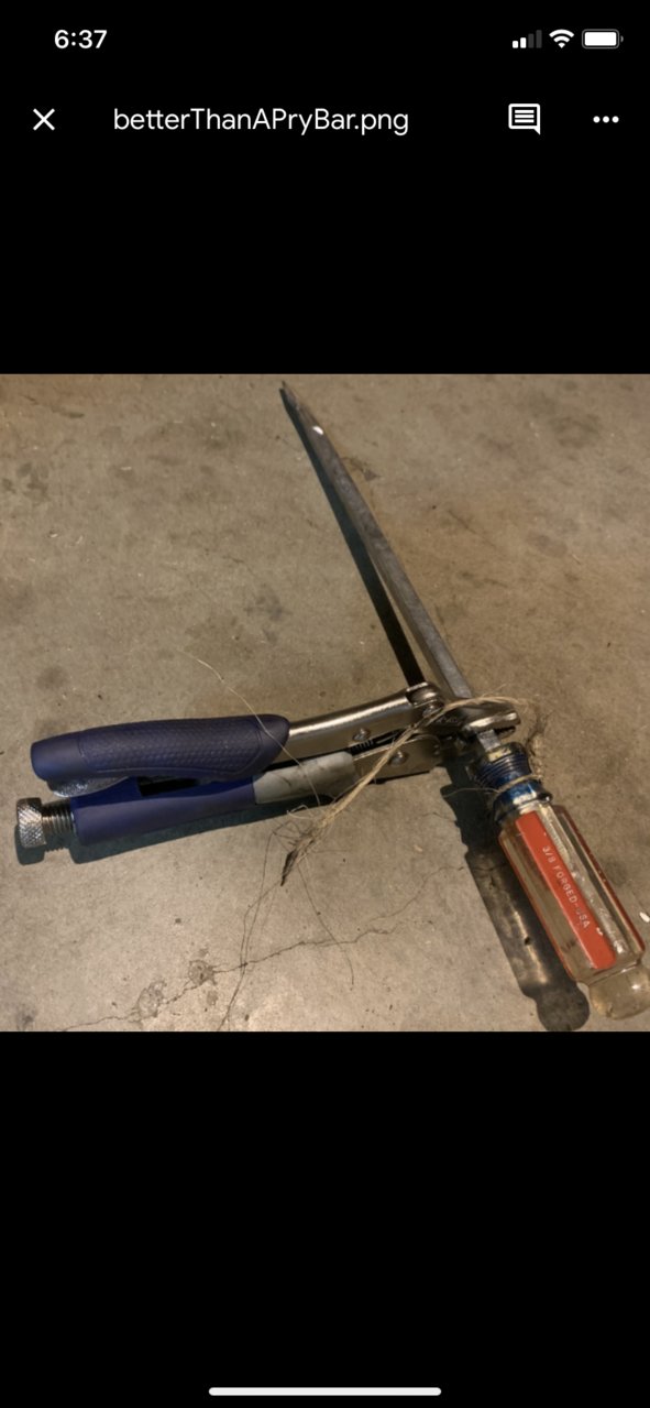

    I had a hard time getting mine out as well and snapped this pic as a future reference for myself lol. The blade of this screwdriver is wide enough to pop it over the snap ring when turned. this approach took all of 2 seconds and didn’t require a big hammer.
    if you’re getting a boot kit you may want to also just get another cv (Napa reman) — use it or return it. I put this one in, rebuilt the original and have it as a spare.
    Good luck. Happy turkey day!!!!
