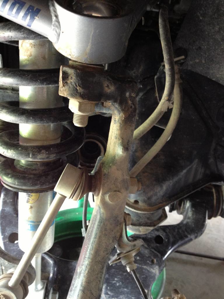

  9. Jun 8, 2013 at 8:34 AM
    #29
    sander1036
    sander1036 [OP] Well-Known Member
    Mar 28, 2011
    #53870
    5,055
    Steve
    Snack Food Capital of the World
    02 SR5 TRD Double Cab 4x4
    THULE Roof Rack, Color matched grille w/ GrilleCraft, Toytec Ultimate, 33 x 12.5 Duratracs, Bushwacker Cut Out Flares, Cvt Mt Shasta, Cvt Awning, LEER Cap

  14. Jun 8, 2013 at 2:05 PM
    #34
    MY50cal
    MY50cal ---- Tread Lightly ---- Leave No Trace
    Apr 5, 2009
    #15613
    4,235
    Mojo
    Camden County, NC
    09 PM RC / 05 SWB AC (RIP)
    Yep.
    Drivers side gets seated all the way in. You'll know when it's seated, there is a lip it will butt up against.
    DO NOT SEAT THE PASSENGER SEAL or you will be doing this again soon. It should be in just far enough to have about 1/8" of outer rim showing. Be carful with these seals, they are finicky little bitches and will leak with the slightest damage or bend in the metal ring. A seal press kit is a good investment, I need to pick up one myself. Also a seal puller from any auto store is like 5 bucks.
    Clip opening facing down. One man job. GL.
    Oh, and Millertime... OP is first gen. This ^ applies to 2nd.
