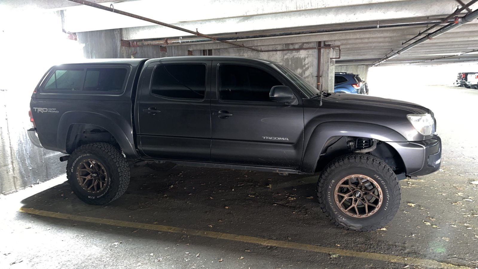

  6. Nov 1, 2023 at 9:55 AM
    #26
    Jordanlacelle
    Jordanlacelle [OP] Member
    Feb 6, 2022
    #389450
    11
    Jordan
    2013 magnetic grey trd off road
    3.5 inch rough country suspension lift. 33 inch BF Goodrich all terrain tires. 17 inch rims
    this is what my taco looks like

  7. Nov 1, 2023 at 9:56 AM
    #27
    Jordanlacelle
    Feb 6, 2022
    #389450
    11
    Jordan
    this was my first Tacoma that I was able to do any kind of modification to. I didn’t know RC lifts were cheap until I had it on and others were telling me…
