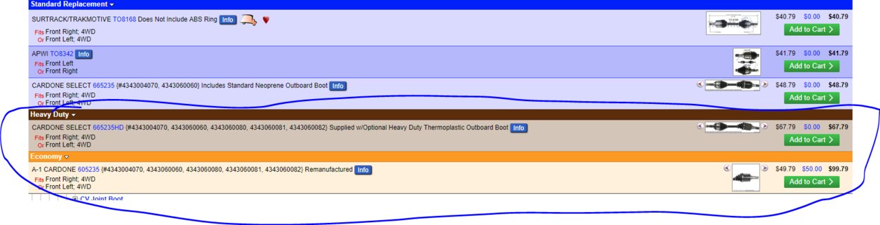

    1) I have torn boots on both sides of my truck and a friend of mine that's pretty handy said it's just easier to buy the new CV assembly rather than rebooting and packing with oil (at least a lot cleaner and timely). I don't do any serious wheeling besides getting through some mud to get to a tree stand or to pick up a downed deer in the swamp. My main concern is getting the boots tidied up, so I am not as worried about breaking a cheaper after market CV axle as I don't believe it'll get to that point in my usage.
    Have any of you bought and compared the Cardone remanufactured vs. the Cardone Heavy Duty on rockauto? Are the remanufactured truly yotas?
    If I get the remanufactured ones how do they reimburse you for the core, just put it back on your original form of payment after they receive it, or do they give you store credit?

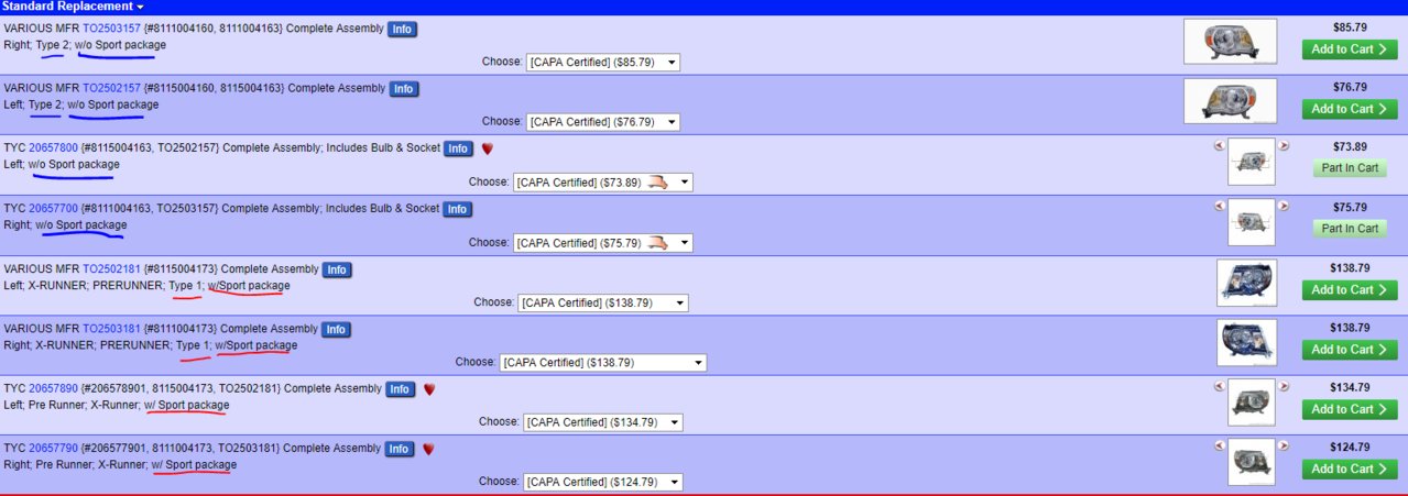

    2) My original headlights are toast, cracked, yellowed, awful looking, (makes the truck look 10 years older than it is), and I want to just by some of the TYC's of rockauto while I am on ordering the CVs. I know, I know, they aren't going to be as good etc. and I should just have my original lights be re-done. I just want to get some new ones on there and be done with it. I'll put some good bulbs in them and I have an LED bar in my bumper.
    I have a two part question I guess.
    a) What is the difference between the "type 1, w/ sports package" and "type 2, w/o sports package"?
    b) I am going to get CAPA (i know it may just be a marketing gimmic), but does anyone know the difference between the "various manufacturers" and the TYC's that are CAPA, preference?

    No input on the axles, other than the core charge part - yes, they refund the core charge to the method you paid with.
    As far as the headlamps go; "sport package" is the darker chrome bezels, "w/o sport" is the bright chrome bezels. The bulb reflector portion is bright chrome either way.
    "various manufacturers" means you get whatever brand RockAuto can acquire for cheap enough to resale at that listed price and still be profitable to them. If it states a brand, that's the brand you're buying (e.g. TYC).

    I would recommend CVJ axles for your CVs. You'll pay $455 shipped for two of them, but you'll get $190 back after core refund, a grand total of $255. They only accept OEM axles as a core, and all the axles they send out are OEM rebuild.
    I would either do that, reboot (I've done it and it's not that bad), or buy OEM for the reason that @Mighty Blue Taco said. Leaking at the diff isn't all uncommon.
