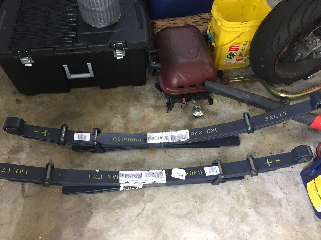

    These will be going on Sunday.

    Spray the piss out of em with a clear coat or something similar. They rust fast

    Wish I had known this prior to install. It was like a week and I could already see rust :annoyed:

    Shitty part is I never got to do it before I installed. Will do it before I take it wheeling though.

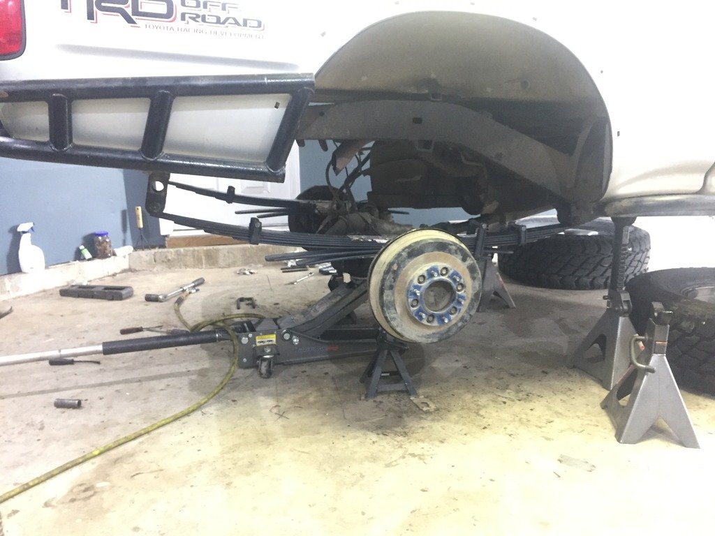

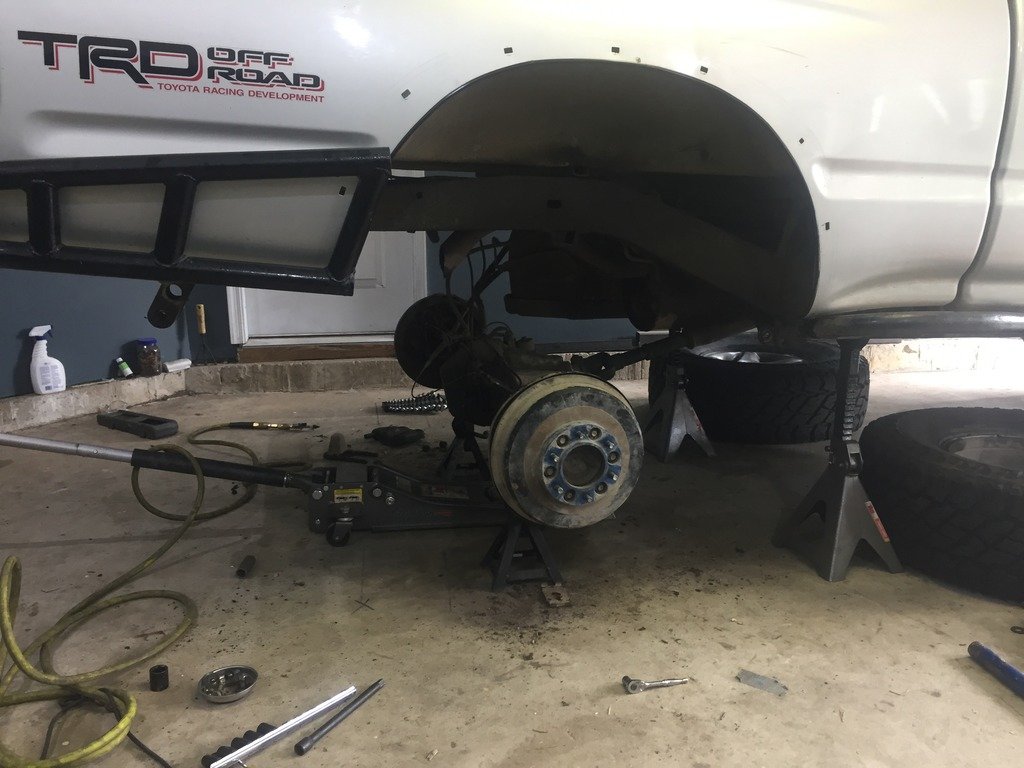

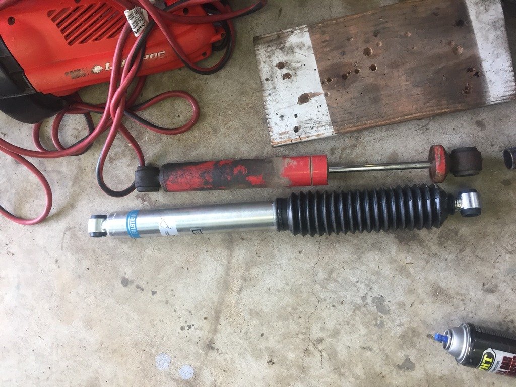

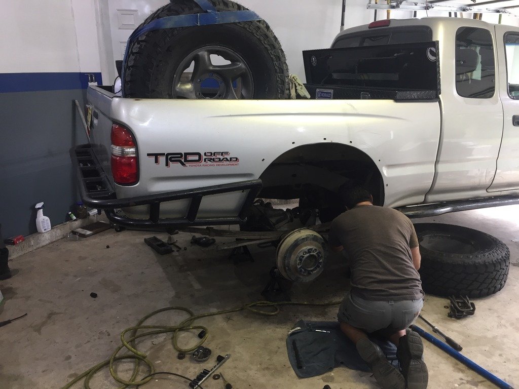

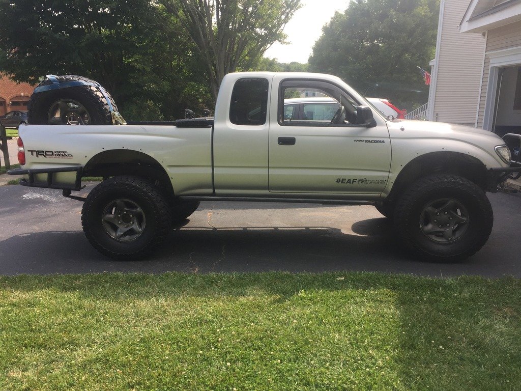

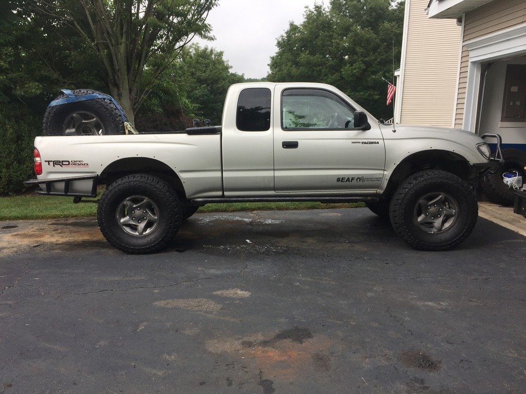

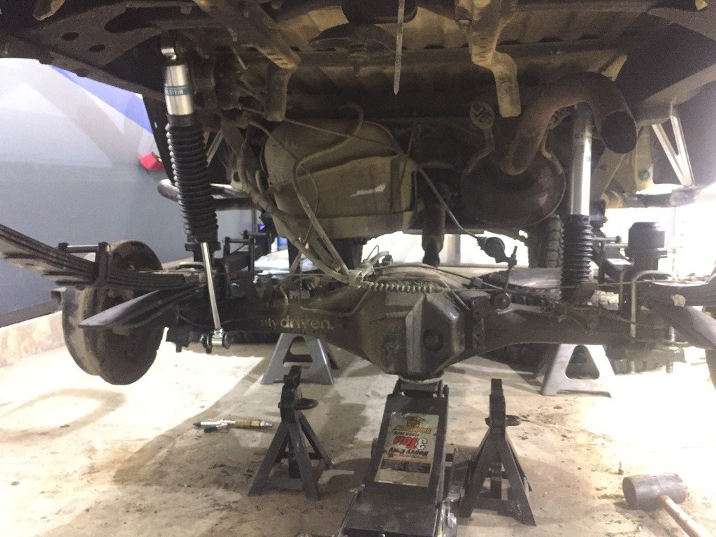

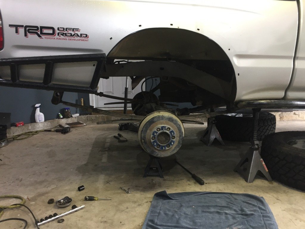

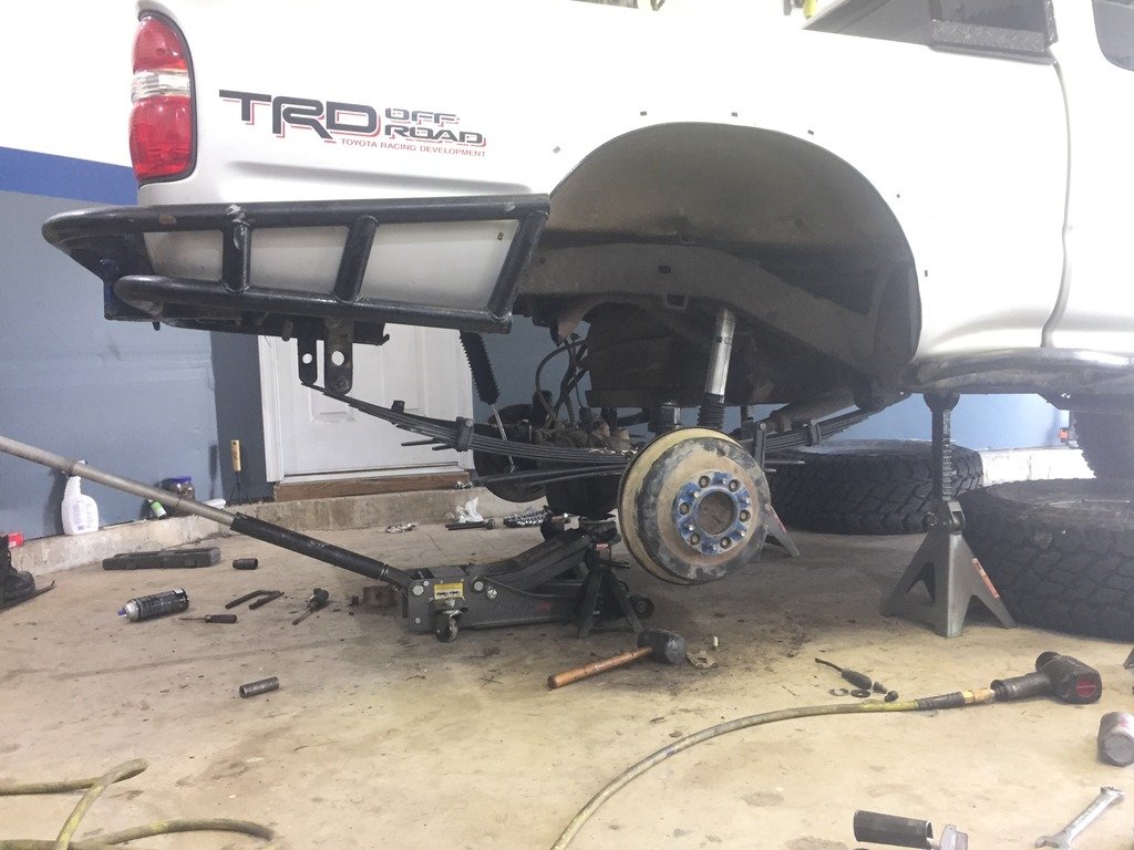

    Got them in on Sunday with the help of @planters15, so much rake! :D:bananadance:
    Before:
    After:
    Random install pics:

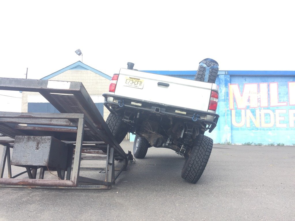

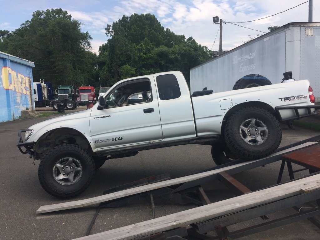

    Test flex:
    I gotta run up a ramp to test and make sure bump stops are good length.
    Full setup is OME Dakars, greasable main eye bolts, daystar greasable 1.25" lift shackles, 9" travel 5125's, all pro axle relocation plates, bamf bpv bracket, and wheeler's super bumps.
