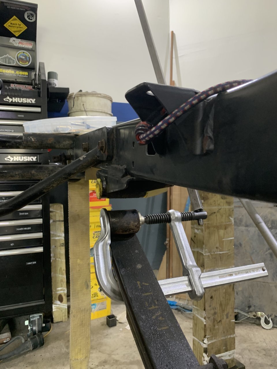

    So thanks to @Reh5108 advice I got the sleeves back in place with liberal heat and a beefy c clamp since my press got lost by fed ex.

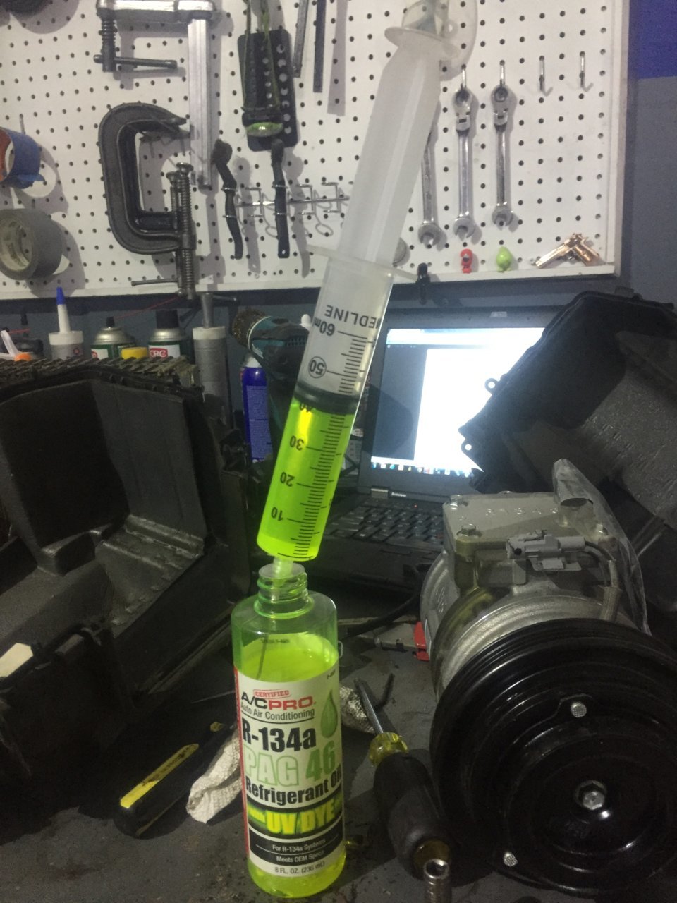

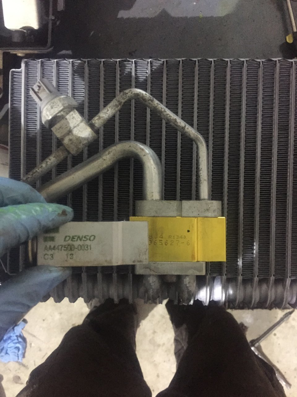

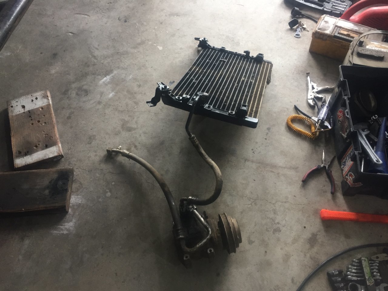

    Mike, when you did the AC project didn't the compressor come pre-oiled? The manual that came with it said it had the factory amount of oil in it already so I didn't add anymore, and the old compressor was bone dry, so I just added some to the drier. How much did you put in there if you remember, was it 40cc?
  10. Jul 2, 2019 at 6:26 AM
    #1610
    cynicalrider
    cynicalrider [OP] #NFG
    Jul 25, 2012
    #83399
    17,161
    Jersey
    01 SR5 TRD 4x4, '23 Bronco Wildtrak, 2017 HSQV FE350
    Drop bracket lift and booger welds
    I went back and forth between this thread and the FSM:
    https://www.tacomaworld.com/threads/1st-gen-a-c-system-replacement-how-to-seized-compressor.293204/
    I actually drained my compressor and put the same amount back in with the dyed oil.
    Looks like I put 20cc in the dryer according to that thread.
    125cc for compressor
    20cc for the drier
    40cc for the condenser
    40cc to the evap
    But I also had a fully bled and replaced system.

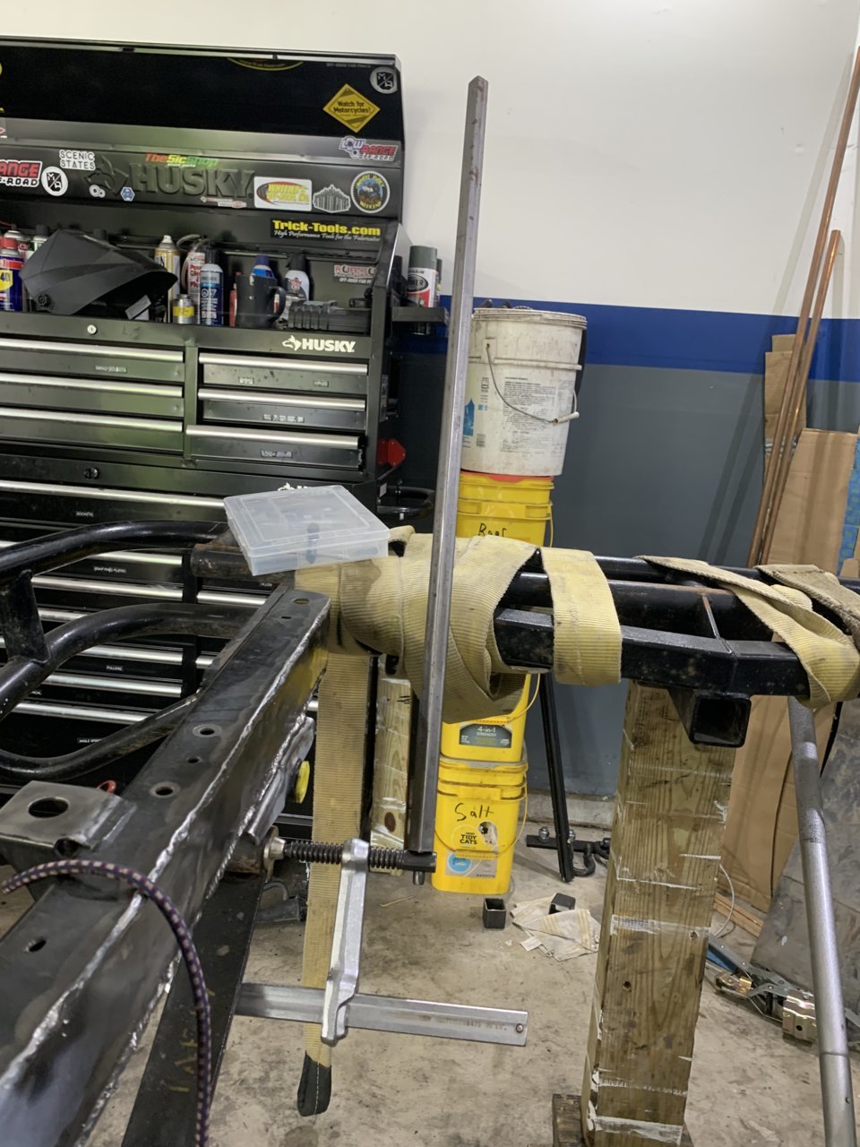

    Big update, went fucking HAM when we got back from vacation. And I need to because I leave next Tuesday for a trip.
    I cut a piece of square tube and welded it as the back most brace. My stick is pretty good flat, but its garbage vertical and overhead.
    [​IMG]Untitled by Michael Halat, on Flickr
    This I got a good penetrating first bead but got some slag holes and hit it with a couple other beads. Not pretty but it should hold.
    I tried the back and bottom of the tube with the stick but they came out like ass. So when at BPF Craig ground them for me and I hit them with the MIG.

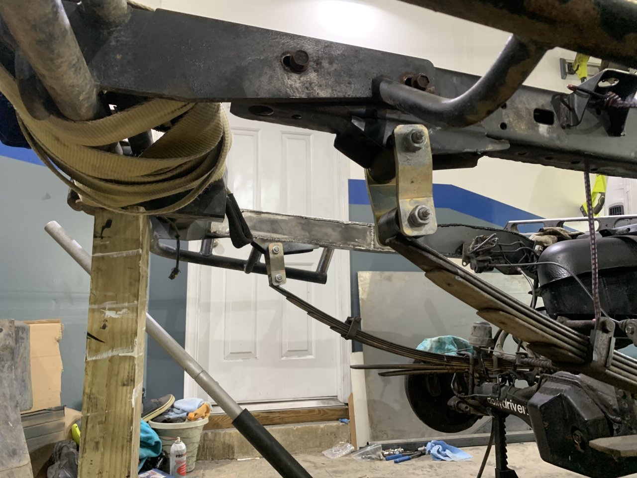

    After that was all set, I was ready for the BPF appt. In the mean time I did other prep for the trip. This included reinstalling my skids with all new hardware, marking the LBJ bolts with proper torque paint that @jubei recommended, and put on my new license plates. :cool:
    https://www.youtube.com/watch?v=dis8S2-ZLJY
    [​IMG]Shock relocation by Michael Halat, on Flickr
    After that I was ready for a terrifying hour drive with no shocks.
