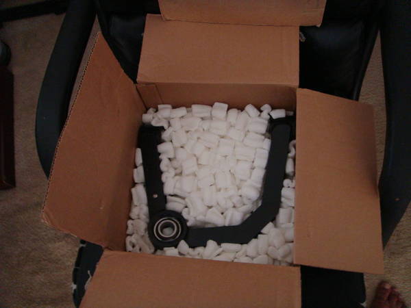

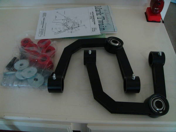

    check these out, got it for father's day present, now i'm looking for a good set of suspension to go with it, that will hold my arb bumper and winch combo.

    Nice. R they from DSM?

    yes they're from DSM. i got them for $525 shipped to my door, it's a much better price than the other ones, by looking at these, they are very solid with ss ball joint. i'll post a review after i drive the hell out of it.

    OOO DSM'S!
    Please give us a review. I want a set. :D

    hey fellows, does anybody here knows why the factory uca spindle bolt has a castle nut and a pin but the DSM or any other after market uca's doesn't? should i drill a hole on the bolt and slip a pin in it, is that a good idea?

    The stock upper ball joint has the cotter pin and castle nut as an extra safety measure to prevent loosening of the nut.
    I recommend you use some loctite blue 242 and torque it to the correct ft/lbs. But do not drill the bolt, you will probably screw up the threads or weaken the bolt. Bolts with the hole in them are usually drilled before they are threaded and heat treated.

    i was just surprised why they didn't put a cottor pin on their bolt, I guess i'll be using some loctite and torque it to 100ft/lbs per specification from DSM pdf. Now what's the 242 blue loctite? I know what blue loctite is what does the 242 mean? thanks for your help

    Its just the number they put on the bottle. They have a different number to identify each type of loctite. 242 is just the regular blue loctite.
