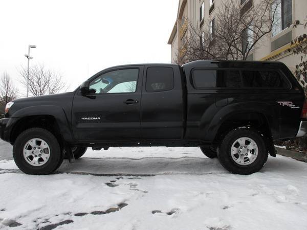

    Got my Dakars on Today!!
    I am measuring 23 (from center) in front with ome 884 and 24 (FC) in Rear. It looks great and rides great. The Dakars are the full pack and are so much beefier then the Stock!! Cant wait to tow on them!!

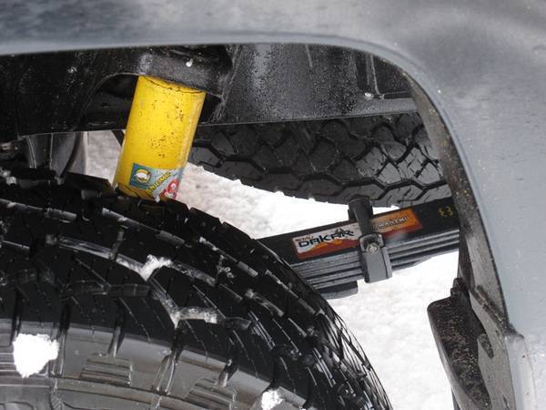

  12. Feb 21, 2010 at 12:25 PM
    #32
    mexpilot
    mexpilot Active Member
    Feb 11, 2009
    #13516
    30
    Moab, UT
    My truck gets me to my runways.
    OME 884 and Dakar Springs, Leer Camper Shell, Custom shelf bed built in back.
    Ok Sorry took me forever to get some pics but here you go.
    :D
