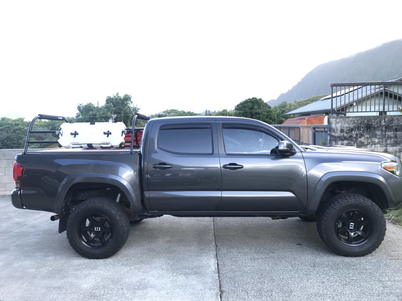

    @littlefish this is what I look like right now with only my racks and bed cover on and 888 coils up front (which are sagging). Considering slapping small spacers to gain more lift up front while I decide on coilover setup.

    I'm fine with rake. I'm more afraid of vibes than anything else from being too high in the rear. When you're empty how high are you?
