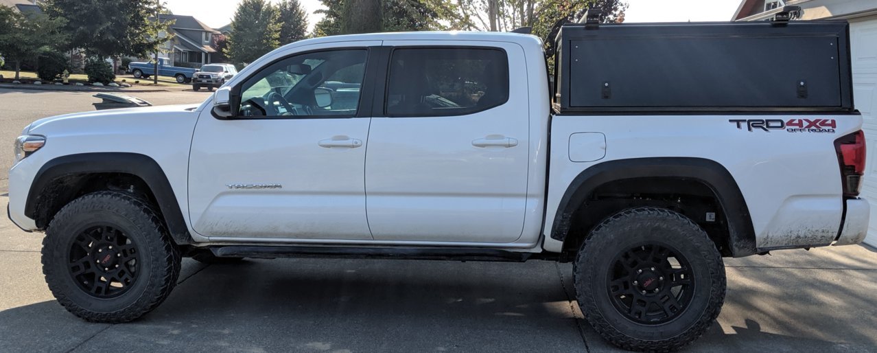

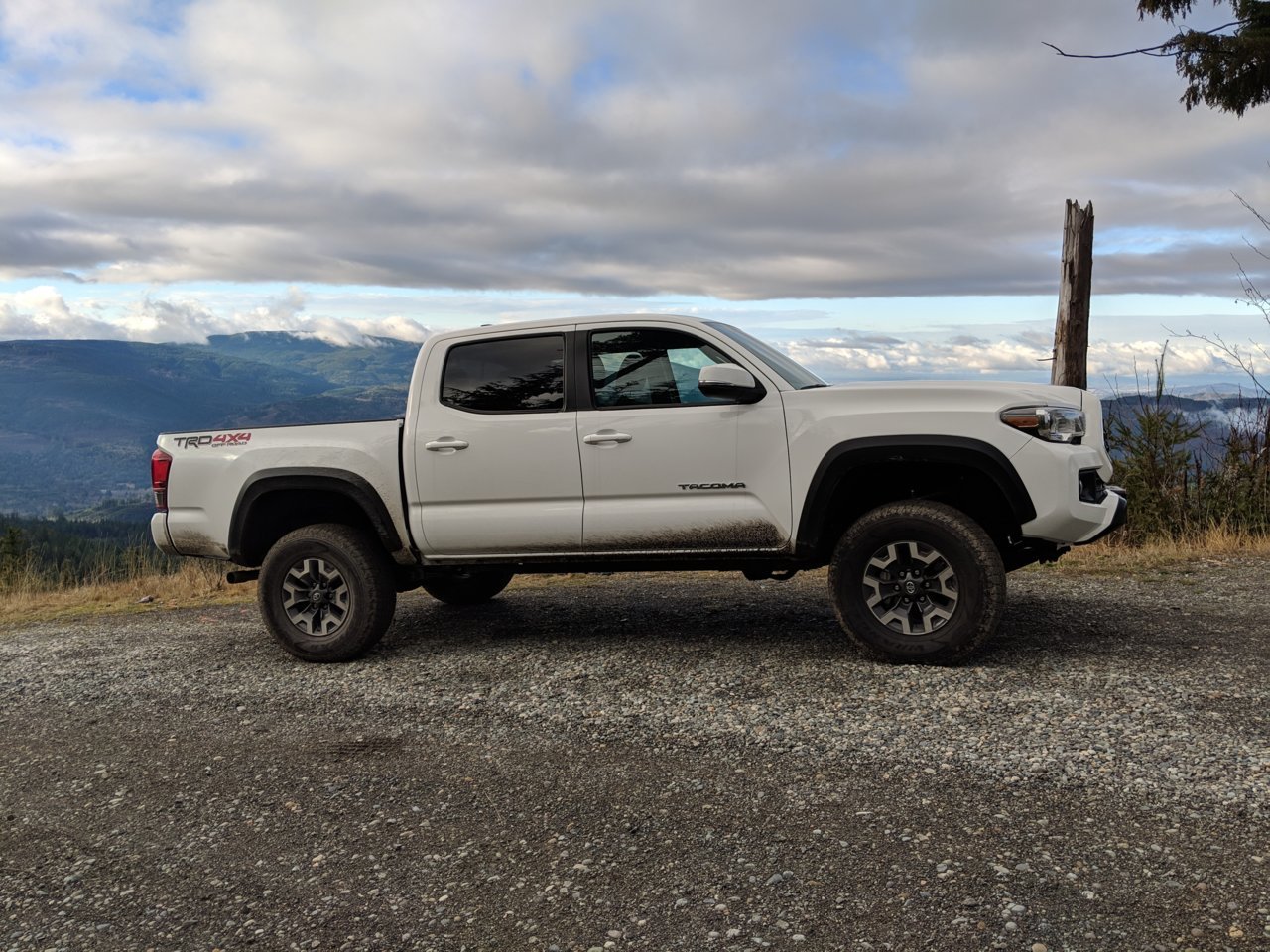

    My md dakars have settled a ton and it hasn't even been a year. This is with sliders and an alucab canopy which is pretty light. I'm hitting the rear bump stops pretty easily. It doesn't seem right and I'm in contact with arb to see what's up.
    I'm on 33s in the pic with the canopy so they fill the wheel well a bit but you can still tell how much everything has settled. Top pic is on a slight downhill towards the front so the front looks especially saggy.

    What’s the weight of that canopy? How high was the lift after install and what has it settled to?
    I’m starting to think that the MDs really can’t carry much if any weight without losing a considerable amount of lift.
