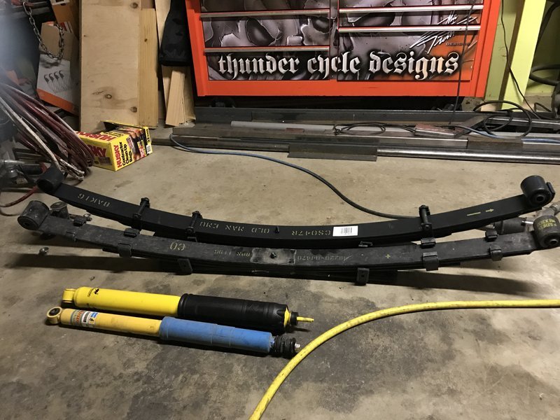

    Well I finally got the Shocks. Weather was holding them up somewhere. The control arms still aren't here so I only did the back.
    Original measurements
    Ground to wheel well plastic arch
    36 1/2" Passenger side
    36 1/4" Drivers side
    Center of wheel to plastic arch
    21 5/8" Drivers side
    21 7/8" Passenger side
    With OME Dakar full spring pack
    38 3/4 Drivers side
    38 3/8 Passenger side
    24" Drivers side
    24 3/8" Passenger side
    Now its going to settle and I will retorque and remeasure after I drive it a few times loaded.

    Nothing Broken. The old springs are labled "Made in Mexico."
    The ride is way better than factory. The diff isnt flopping around having axle wrap anymore. IMG_0092.jpg
