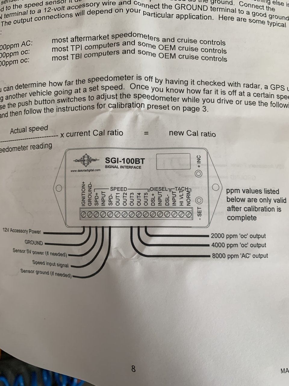

    EDIT: After further investigation, module does not appear to be correcting speed. Got it up to highway speed and changed the calibration via app, no apparent effect.
    I don't think this module will work on the 2012, I'm going to take it out and replace with hypertech.
    Did this over the weekend, forgot to take pics.
    Pretty easy, seems to work just fine on my 2012 6spd MT.
    I ended up using double sided tape and sticking it to the vent. Tapped into the same wires, using the posilocks (which were expensive but worth it).
    I used, ign, gound, speed input, and Out2.
    Running BFG 285/70R17 with stock gearing, 1.04 (+4%) correction seems to be spot on. The BT app makes changing the calibration SUPER easy.

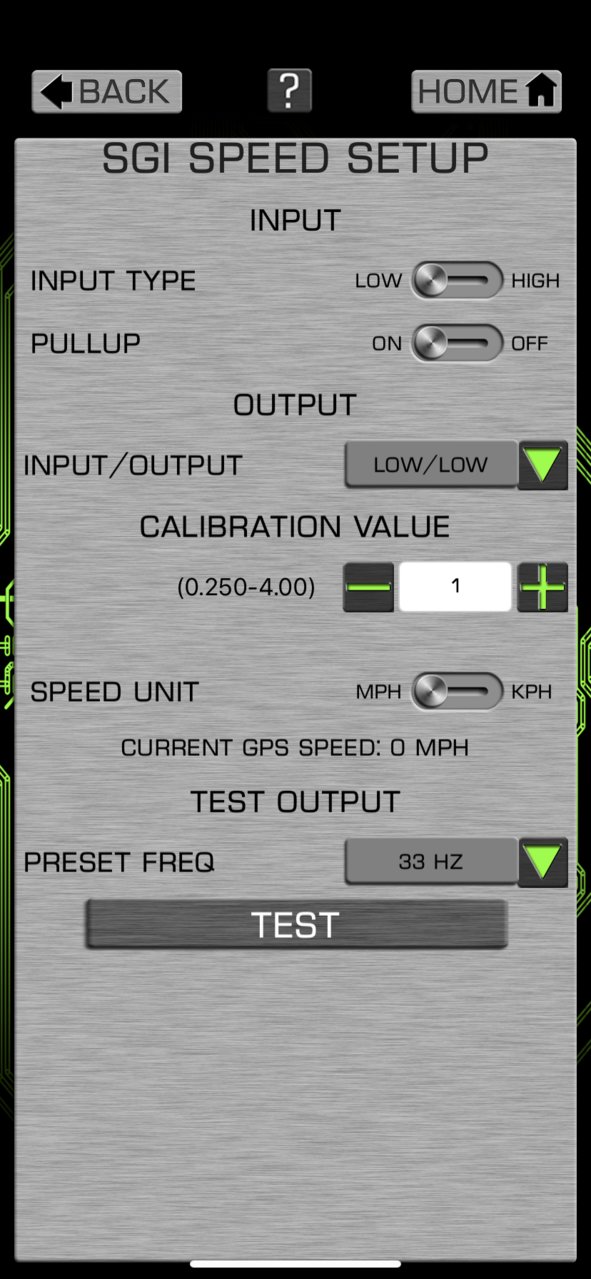

    I just edited my post. I investigated further, and the output the app is showing is not reflected on my speedo. I don't think it's gonna work for the 12-15. I'm going to take it out and replace with hypertech.

    Yeah, I thought it was spot on at lower speed, but realized once I got over 40 the error was still present.
    I then tried making larger adjustments in the calibration and realized it was not changing my displayed speed at all. I did not check to see if it was correcting odometer.
    Perhaps it was my settings. I took a screenshot after I changed the calibration value back to 1.
  16. Aug 31, 2020 at 11:47 AM
    #56
    EatSleepTacos
    EatSleepTacos [OP] Well-Known Member
    Mar 24, 2015
    #151688
    59,835
    Randy
    West Valley, AZ
    2017 4Runner
    Try high/high. That's what I had to have mine set at. I would imagine we would need the same settings even though you have the BT version.

    No delta. Running High/High didn't change what I'm seeing on my speedo.
    Hypertech is in the mail and on the way to me. I bought the dakota digital on Amazon, so will likely be returning.
