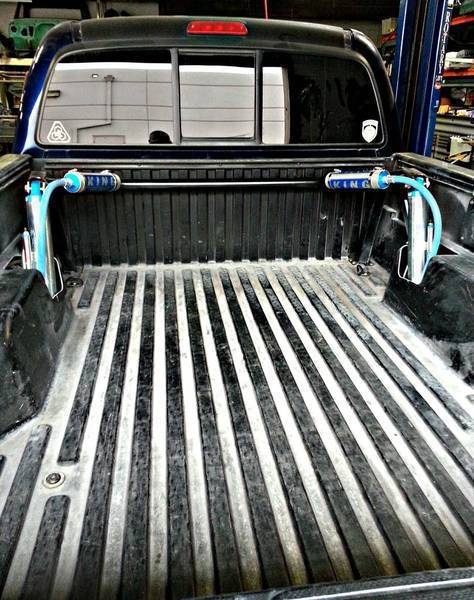

    The reason LT goes with Spring Under Axle is to increase the uptravel. It moves the 4-5in leaf pack to the bottom of the axle, allowing around 4-5in more uptravel, depending on shocks and bumps. and most lt rear have to cut into the bed to utilize the full travel of the leafs. You can keep it under the bed but you loose some travel
    LT that goes into bed (stfu510)
    LT under bed (Fixed TRD's old truck)
    EDIT: sorry for threadjack i can delete it if you want dakota..

    Oh okay that makes sense now, thanks!

    No need to delete lol, we're all learning here. Its good info
    I'm never cutting that composite bed. Fuck. That. Shit.
    LT under the bed FTW
