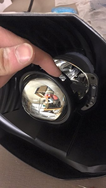

    Front halos are rock solid with the bread tie method!!
    Now do I just run the wires thru here? Do I need to worry about them melting?
  5. Jan 19, 2016 at 8:17 PM
    #2285
    gray223
    gray223 Well-Known Member
    Nov 6, 2013
    #116062
    3,439
    SE Missouri
    2014 Tundra Limited
    that ring goes on the shroud. look at the back of the shroud. It should be self explanatory.

    Guess they're just gonna not interfere with the projector and go beneath out the hole I drilled in the back of the bowl. Thanks!
