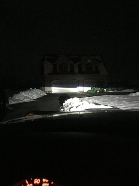

    Ok I'm retarded. Got my headlights adjusted and much better. They're 40.5" at the cutoff on the lowest point. Good since my left projector retardedly slopes slightly up towards the left (on coming traffic)
    But I didn't think about the exponential beam of light. If its higher than your projector (which are at 42" ish ) from 25 feet away it will go up and up blinding people. Much better now. And the high beams work perfect unleashing the beast when no one else is on the road.
    These suckers are definitely getting switched to 4500k. It's not horrible warmed up, but its still such a cool white. No me gusta. Espesically at 27 degrees these suckers are Honda Civic Hatchback Ricer Blue©

    Ive got some of the two wire Delphi Weather Pack connectors at home. Waytek you have to order a min of like 20 so i ended up with a bunch of extras. Could make them up with wire so all you had to do was solder the wires to the fogs.
    Otherwise I like this guy on ebay. Includes everything you need ot make one connector plus an extra male and female in case you mess one up. Plus he is cheap with free shipping.
    http://www.ebay.com/itm/New-Delphi-...672495?hash=item35d7f8c8ef:g:pZAAAOSw7I5TrdU7
    As for aiming them....i keep mine low. Id say comparing yours on your garage door mine would be more at the top of the bottom panel or slightly above. But i dont like blinding people as happens frequently when i drive my car. Even with them aimed a bit low they still light up a nice area (way better than stock). Plus if i need more light I have my LED fogs. And if i need more than that i have my 20" lightbar. Plus as you mentioned even with them aimed where they are they still light up beyond that height just not as intensely.

    Well the eBay thing is exactly what I need. I appreciate the offer man but it's probably not worth the money to for me to drive there or ship them. Thanks so much for the link though! Will be going with that.
    As far as the HIDs go. Well after the adjustment I still got flashed twice. I think the reason is this:
    My stupid passenger projector is doing the opposite of what it's supposed to do. I also think it needs to be adjusted to the right but that's hard to tell/do when you only have one headlight.
    When I replace the bulbs I'm going to try to reach in and turn the projector a little to the left.

    Well this is freaking stupid. There's got to be something I'm missing here with the way a beam exponentially travels being on a lifted truck.
    So I parked the truck at 25 feet again. Adjusted 5" down to 36" cutoff line. Now I'm outdriving my headlights like crazy. Worse than stock. I don't know if I was just spoiled by the way my stock headlights were pointed up, but never got bothered because they didn't have nearly the intensity? Obviously I blinded the shit out of the sheriff in his crown vic, but my little sister in the GX470 had no blinding issues when I pointed it at her.
    TRS said "yeah they should be at like knee level" Bull shit! Maybe in a BMW 3 series. Ugh, guess I'll keep messing around with them. Next I'll try like 38"... If I really have to be at this height to not blind others then it's not worth it. I mean the high beams are but not the low beams.
