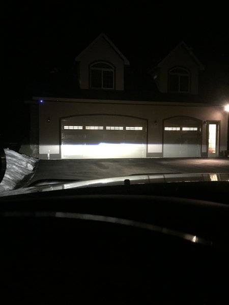

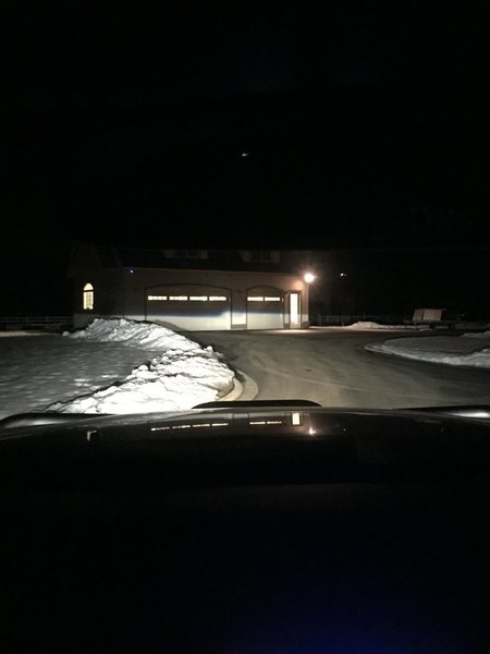

  19. Feb 6, 2016 at 10:11 PM
    #2459
    dakotasyota
    dakotasyota [OP] Just a Fringe of the Ging in your Minge
    Jun 11, 2013
    #106099
    7,938
    Dakota
    Ellensburg, WA
    06 Access Cab, Manual, V6, 4x4, TRD Off-Road
    Total Chaos +2 LT w/ 2.5 x 8 Kings, 700 lb coils, Chevy 63s, BAMF Shock relocation, 12" King Smoothies, Locker Anytime Mod, 5% Tint All Around, 4xInnovations full skids, Custom Made Rock Sliders, 4xInnovations HC Rear Bumper w/ Tire Carrier, SOS Original Plate 2 Front Bumper, 130 w KC Slimlites, Homertaco Raptor Grill, Bestop Supertop, Smittybilt 9500 lb winch, Flowmaster 40 series, JVC deck w/ 12" Rockford Fosgate T1 in custom box, and lots more!!
    Well my headlights are finally completely done right.
    Resealed with retro rubber
    2 silica packs per headlight
    1 gortex patch on each headlight
    80 mm boots for perfect sealing off on the back
    4500k bulbs. - These are amazing!! Nice white color. A little blue at start up but a perfect warm white under the cutoff. Ugh I love them!! Such an awesome upgrade.
