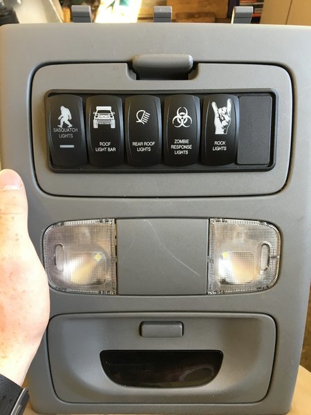

    Progress has been made. Time to start tucking and bridging wires.
    Notice the fat scratch between the map lights... Somehow I made it through the dremeling safely and when cleaning up the burrs with a file I slipped :frusty:

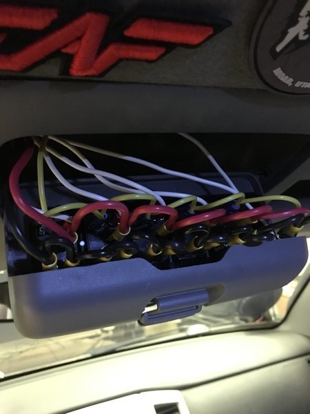

  12. Sep 5, 2016 at 10:41 AM

    Lol well crap my original Sasquatch switch doesn't match the layout of the others. That's gonna drive me insane

    NorthwestCruiser
    NorthwestCruiser Well-Known Member
    Nov 20, 2013
    #117000
    13,081
    Brian
    Snohomish, WA
    1996 Land Cruiser
    Custom 3 link, 40's etc..
    Overhead switches ftw :woot:

    Well after putting everything together I can't close it. Starts popping out the whole panel. Not quite sure what to do at this point. Any advice from people who have done it would be great. My only idea is 90 degree disconnects if I can even find them...
    I guess I could maybe make my wire loops smaller? That didn't really work out well because I already had two pull out trying to force it closed. Eff.
    AR15xAR10 and Whitecloud like this.

    PPansini10
    PPansini10 Well-Known Member
    Apr 15, 2012
    #76975
    1,019
    Paul
    NJ
    09' DCSB 4x4 TRD Sport
    Gotta make the loops smaller... that happened to me the first time i did it too, really sucked but it had to be done

    Whitecloud
    Whitecloud Cloudy-fabricator of things
    Feb 24, 2010
    #32031
    4,422
    Johnathan
    Albuquerque, New Mexico
    Superwhite 06 DCLB
    ICON Extended travel Coilovers, Custom leaf pack, custom sliders and F&R bumpers, 295 75 17 Toyo Open Country MT's, On-Board air with F+R connectors, On-Board water with quick disconnect shower.Trimmed fenders and body mount chop. LOTS of wiring, dual battery setup, Solar charging system, with some random lights spread around here and there.
    I had to make smaller loops and I took out some larger pieces of the back of the panel. I left the screw area a little larger and removed the majority of the rest of the back section. You'll never see it anyway!!
    ^^^^^^Exactly.

    dakotasyota
    dakotasyota [OP] Just a Fringe of the Ging in your Minge
    Jun 11, 2013
    #106099
    7,938
    Dakota
    Ellensburg, WA
    06 Access Cab, Manual, V6, 4x4, TRD Off-Road
    Total Chaos +2 LT w/ 2.5 x 8 Kings, 700 lb coils, Chevy 63s, BAMF Shock relocation, 12" King Smoothies, Locker Anytime Mod, 5% Tint All Around, 4xInnovations full skids, Custom Made Rock Sliders, 4xInnovations HC Rear Bumper w/ Tire Carrier, SOS Original Plate 2 Front Bumper, 130 w KC Slimlites, Homertaco Raptor Grill, Bestop Supertop, Smittybilt 9500 lb winch, Flowmaster 40 series, JVC deck w/ 12" Rockford Fosgate T1 in custom box, and lots more!!
    FUUUUUUUUUUUUUCCCCCC
    UGH
    Ok. I think it's just the power wire thats a main issue. I don't see me being able to get the grounds looped any smaller. Stupid 12 Gauge...
    Where did you guys come in with the wires? Just the back left like I did? I felt like they were holding stuff up as well...

    #2980
    velillen
    velillen Well-Known Member
    Dec 14, 2013
    #118589
    5,857
    Nick
    Wyoming
    2011 Access Cab 4x4
    I cut the backing out to give a bit more room against the roof. You wont see it anyways. Wire wise i have a lot more wires (take it you are using an spod?) and can close mine. But I ran basically three sets of wires to mine. One set of "from fuse", one set "to ACC" and one set that contained the illumination, ground, power, and two spare wires. All three sets i ran from parking brake area, up the pillar, and across the headliner. One set i came in from the left of the rear view mirror, one set comes in sort of even with the mirror, and the third from the right on the mirror.
    Its a tight fit so just play with it and push wires back when you can.
