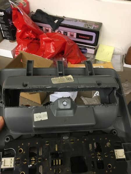

    Damn guess I need to pull the console out and cut the back out, But leave a chunk where the mounting screw goes :notsure:

    Well I cut out my panel more - good

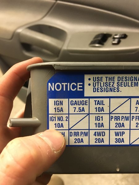

    So i ran out of 14-16 ga disconnects making the new piggybacks so I decided to work on my locker switches. I bought all OTRATTW switches for the lockers so they match. Anyways I just used a tester to "attempt to determine" what wire was what on the factory locker. Welp, I thought I had it figured out but I just jabbed some wires in there to the new locker switch and flicked it to test it and the switch blew. Illumination on the new switch doesn't work anymore but the led on the factory switch does....
    But now the factory switch no longer has any power going to it. Can't get the relay for the locker to click. No locker power and I haven't found a fuse yet soooo...

    update: new rear locker switch actually is fine and functional. So it just appears I blew the factory locker fuse....
    EXCEPT THAT FUSE DOESNT EXIST

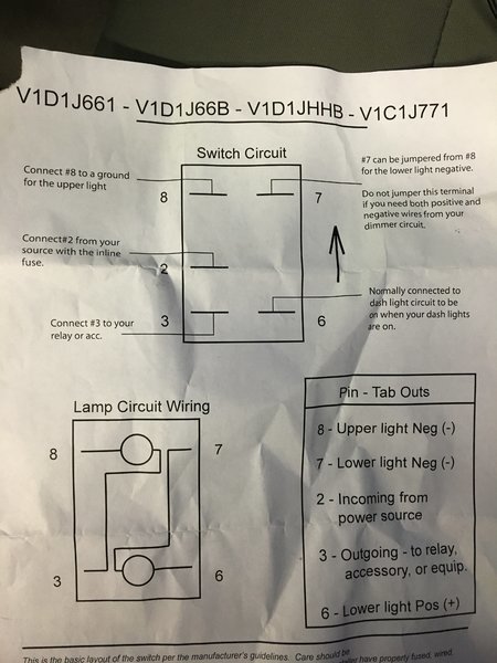

    In the mean time can you wizards tell me how to wire this? Not sure what I did wrong, maybe it's related to note about jumping #7 to #8. I did Do that and it appears the factory wiring has a + and - illumination wire....

    YES!
    If anyone is curious this is your locker fuse

    #2996
    dakotasyota
    dakotasyota [OP] Just a Fringe of the Ging in your Minge
    Jun 11, 2013
    #106099
    7,938
    Dakota
    Ellensburg, WA
    06 Access Cab, Manual, V6, 4x4, TRD Off-Road
    Total Chaos +2 LT w/ 2.5 x 8 Kings, 700 lb coils, Chevy 63s, BAMF Shock relocation, 12" King Smoothies, Locker Anytime Mod, 5% Tint All Around, 4xInnovations full skids, Custom Made Rock Sliders, 4xInnovations HC Rear Bumper w/ Tire Carrier, SOS Original Plate 2 Front Bumper, 130 w KC Slimlites, Homertaco Raptor Grill, Bestop Supertop, Smittybilt 9500 lb winch, Flowmaster 40 series, JVC deck w/ 12" Rockford Fosgate T1 in custom box, and lots more!!
    This is what really makes my brain hurts.
    With the key on
    Pin 4 - which the diagram shows as the IGN does not show power...
    Pin 3 - which the diagram shows as the wire to the relay *shows* power...
    Seems backwards to me. Ugh help.

    We're back in business the locker does indeed work again lol. All the switches are fine. I just blew a fuse.

    Panel looks good. That is as much as I cut mine. Were you able to source more of the connectors?

    Sweet good to know. I'll pick some up today. Do you have any advice on wiring my locker switch?
