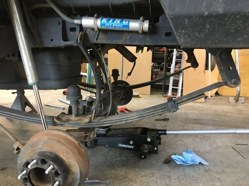

    Wish this shackle angle was better....

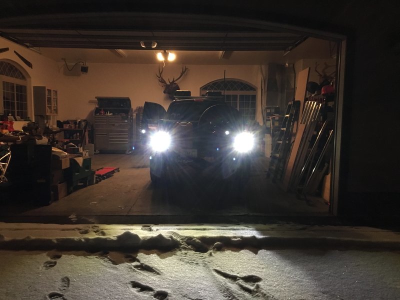

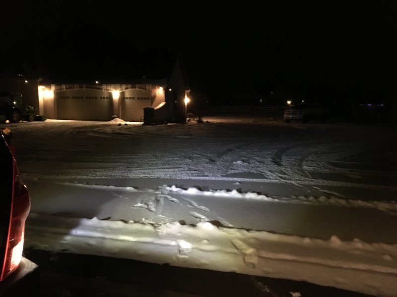

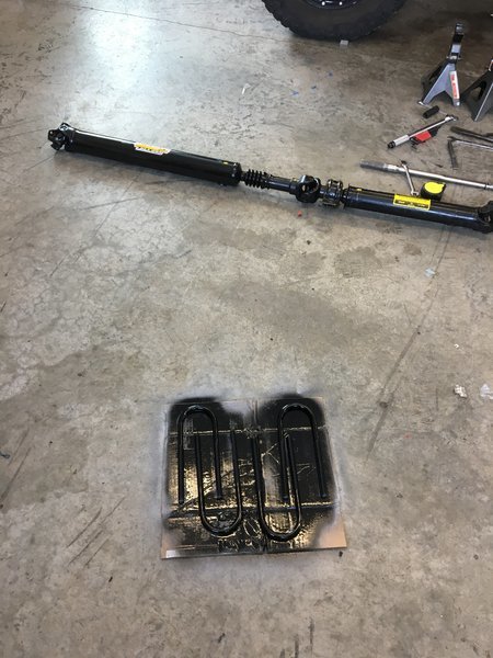

    This makes me happy. So sad it'll be ruined just by the time I get out of the driveway :(IMG_4461.jpg
    Ok also guys.... these are kickass! I mean holy hell are they bright!!!!!!

    Whitecloud
    Whitecloud Cloudy-fabricator of things
    Feb 24, 2010
    #32031
    4,424
    Johnathan
    Albuquerque, New Mexico
    Superwhite 06 DCLB
    ICON Extended travel Coilovers, Custom leaf pack, custom sliders and F&R bumpers, 295 75 17 Toyo Open Country MT's, On-Board air with F+R connectors, On-Board water with quick disconnect shower.Trimmed fenders and body mount chop. LOTS of wiring, dual battery setup, Solar charging system, with some random lights spread around here and there.

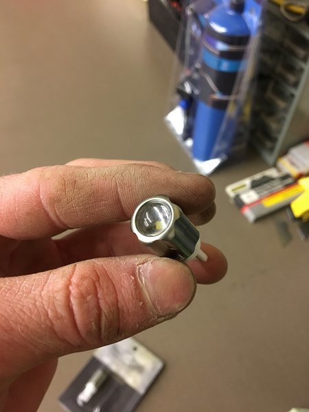

    Where'd you get the bulbs?

    The retrofit sourcd

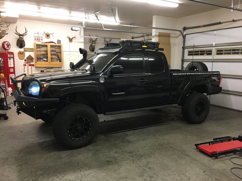

    Soooooo. Ok I was being lazy and didn't measure Caster properly. Thinking I probably should now. But basically I just wanted to get as much as I could and get the camber in spec. So this is what I got. I have the back cam maxed "longer" for maximum caster. And the front cam almost maxed all the way the other way to get my camber to -1.... I measured my caster by turning my wheels 1 full rotation instead of measuring 20 degrees out. Think that makes that big of a difference? @jberry813
  20. Dec 19, 2016 at 8:00 AM
    #3560
    SconnieHailer
    SconnieHailer PutterClutch
    Aug 26, 2012
    #85590
    9,765
    Marc
    West Central Wisconsin
    2012 TRD Off Road Double Cab V6 6Speed
    I'm pretty sure one full rotation of the wheel will net you like 10°. But I haven't measured it on my tables so not sure. Probably why your numbers are half what they probably are.
