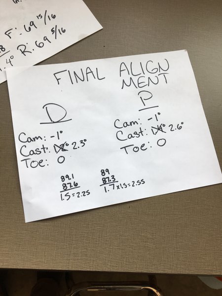

    Just snuck home to do some actual measuring with my jobsite digital angle finder. Looks like measuring does make a difference.
    What do y'all make of this... seems odd. I know when I've had it aligned before they've gotten 4 degrees castor... weird.

    Firestone consistently gets me 3 but Toyota got me 4 when I took it in and it was amazing. The go cart steering went away.

    Hmmm. I wasn't unhappy with the way it drove last time. We'll see. Maybe I just need to try maxing the fronts for optimum caster and then dialing in camber with the backs... idk. We'll see.

    I told les schwab to do 4 degrees and when I picked it up they said "we got as close as we could" which was 4.5 degrees.

    Hmm. Yeah Schwab gave me over 4 last time too

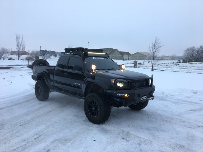

    Awesome truck! #truckgoals

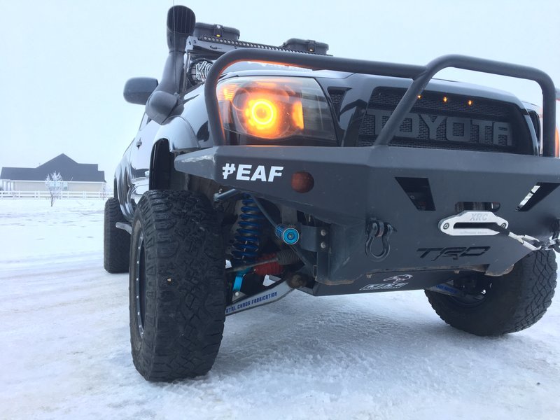

    Speaking of my truck. It completely works now. Great to have it back. Although I never drive it anymore lol. Vibrations are little to non existent. Shims really do help. Overall I'm a happy Dakota.

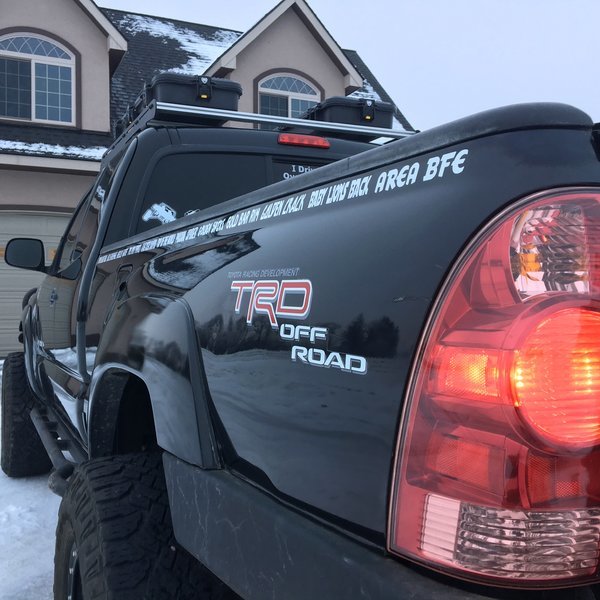

    I miss the rainbow bedside

    It looks like a bible verse from a distance....ain't nothing holy about you flameheads
