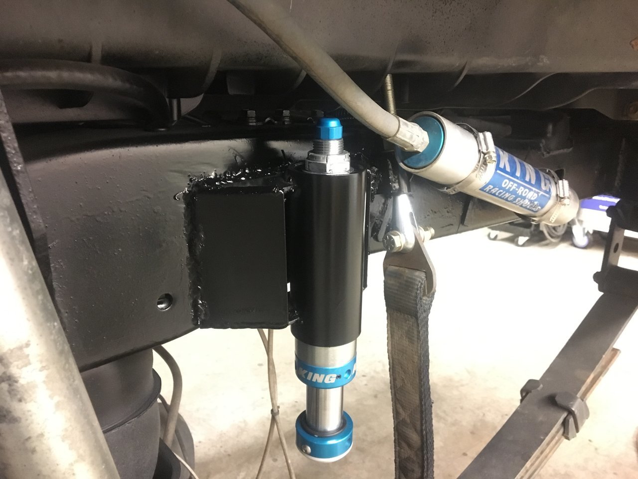

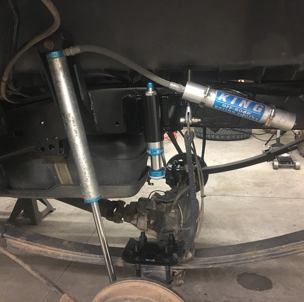

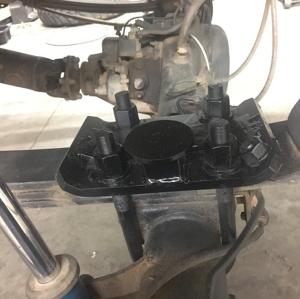

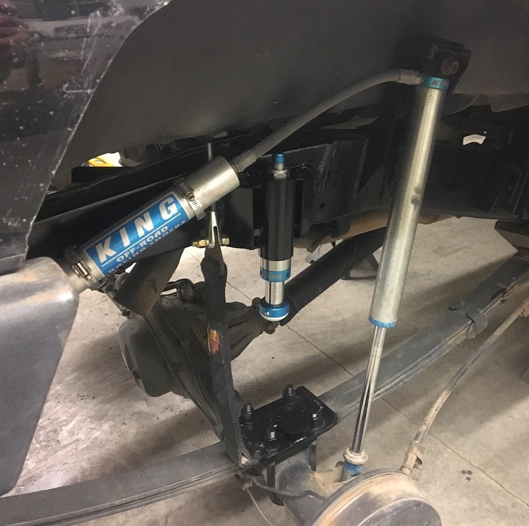

    Ok guys... what do y'all think? Originally I was thinking I needed to move my lower shock mounts down an inch to gain an inch more of shock shaft at ride height. Now I'm reconsidering with the new shackle position. Where it sits at ride height I have 4.5 of useable shock uptravel. That would give me 2.5 of uninterrupted travel and 2" of bump travel. Measured from the fender to tire (I know I know) that's pulling 8" of uptravel. Before I was riding on top of my superbumps... like maybe 1/2" till contact. I'm thinking I could probably leave it the way it is and just set up the bumps. Thoughts? I'm also already going negative arch too. The only other issue I see is the bump mounts I fab'd will only be halfway on the frame... unless I can space down the bump in the sleeve with washers....
    [​IMG]IMG_7257 by Dakota Hamlin, on Flickr
    [​IMG]IMG_7258 by Dakota Hamlin, on Flickr
    [​IMG]IMG_7259 by Dakota Hamlin, on Flickr
    [​IMG]IMG_7260 by Dakota Hamlin, on Flickr
    [​IMG]IMG_7262 by Dakota Hamlin, on Flickr

    All done! Just one problem... limit straps are too long... so we gonna pick some up on the drive down to Moab. I replaced the radiator too.... let's see if that fixes the problem. The old one was PACKED with mud.
    But man what a project! Can't thank @utroda enough for his help. Feelin' pretty good about how my fab skills have improved....
