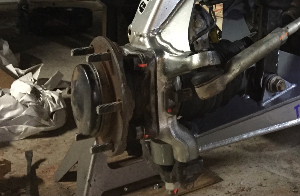

    Update:
    Snorkel attached to A piller.
    Coil bucket gussets welded up and painted.
    CVs painted.
    OE cam tabs all off and ground down flush. Only had two left to weld up and I ran out of wire :facepalm:
    Cam bolts come in tomorrow but I have plans tomorrow night so I'll throw them in probably Wednesday. Hoping to be driving this thing by Friday.
    Still left to do:
    Install cam bolts.
    Paint cam gussets.
    Install LCA, spindle, and coilovers.
    Install new brake lines and brakes.
    Trim fenders.
    Allign it and throw on the rear wheel spacers.
    :woot:
    Oh I'm gonna anti seize the piss out of them!
    They're definitely darker but still purdy!
    Mademan925 likes this.

    Cam tab gussets are finally completed and welded on.
    EFF
    THAT!
    Like seriously I need a car lift. Got lots of new burns and my inside welds look like crap but who cares! They aren't going anywhere haha.
    So glad to be done with welding. I don't want to touch that thing for a while hahaha
    But anyways, seems like I'm kinda on the home stretch. God I hope my CVs don't leak...
    I also have no idea how to replace my brakes but I've figured out everything on my truck thus far so I'm sure I can do it lol

    The cam tab gussets sucked welding on, i did mine with the truck on normal jackstands also. I feel your pain! Are those flux core welds?

    Yeah they sucked. No I'm using a mig with .035 wire.
    Really? Ugh my welds on them were not pretty lol. Sweet I'll check it out! Thanks man :cheers:
