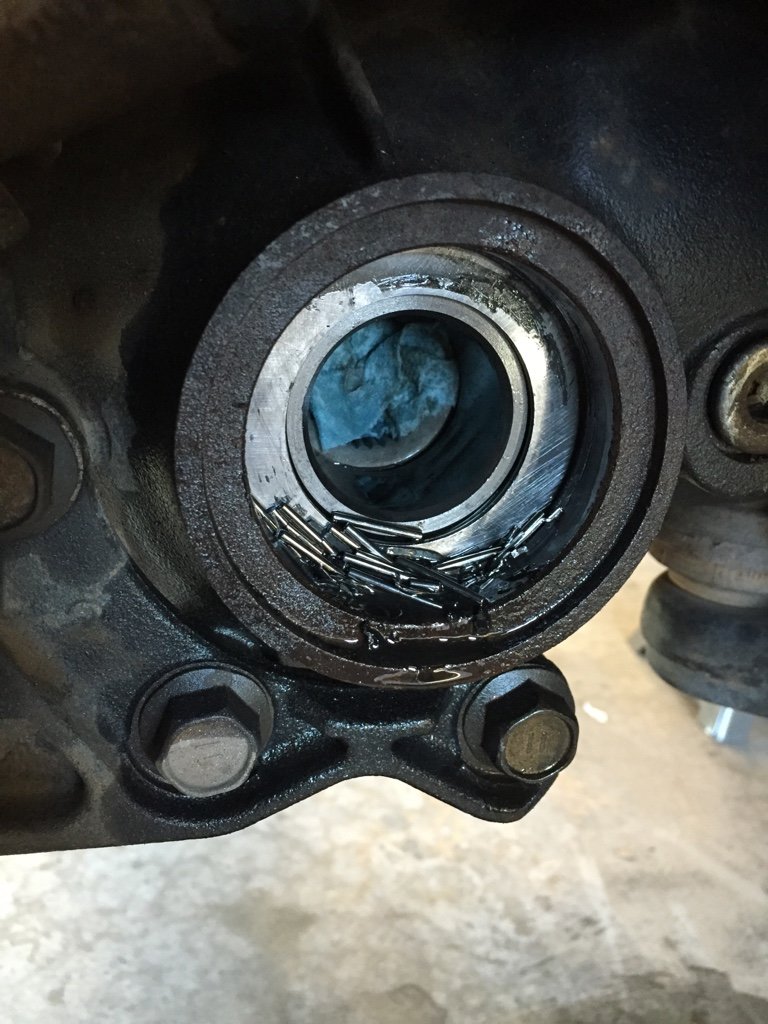

    Cept what's up with the little metal rods?? Those don't look like part of the bearing...

    Those are the needles from the needle bearing you just pulled out. Check your CV for extra wear.

    Yikes... CV looks alright. I couldn't believe how much play it had in it :eek:

    Slip that ecgs bushing on the CV and make sure its good. Also get some Emery paper or steel wool and rub down the surface that contacts that bushing to make sure it doesn't premature wear on that new bushing

    Ok will do... I'm still concerned about this seal haha... Idk even how to get it out...
    I've also heard of putting gasket sealer around the outside of the seal before tapping it in... Good idea? Bad idea?

    Holy shit! I can see why the seal failed...

    :eek: Now thats needle bearing failure!!!

    Lol yuck! Yea I put some of that red toyota gasket on the outside of mine when I punded it in

    Got everything put back together around 2 in the afternoon yesterday. Drained the diff (changed oil about 7k ago) it was pretty dark and had a few pieces of metal and "metal sludge" on the magnet...
    Oh well, 4.56s are coming soon. The noise and vibration are gone. Drove it in and out of town a couple times and to the rodeo last night. No puddle of oil yet... :fingerscrossed:
