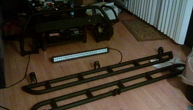

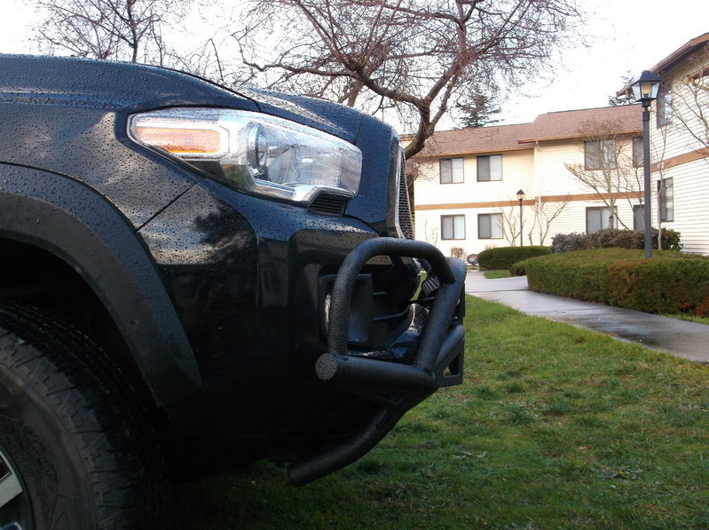

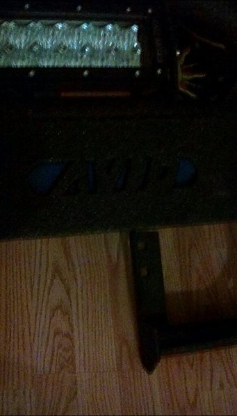

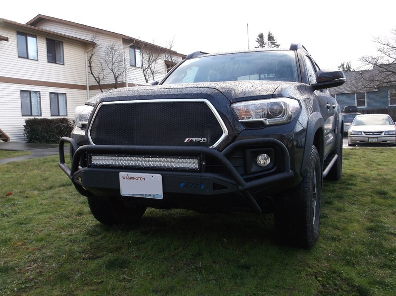

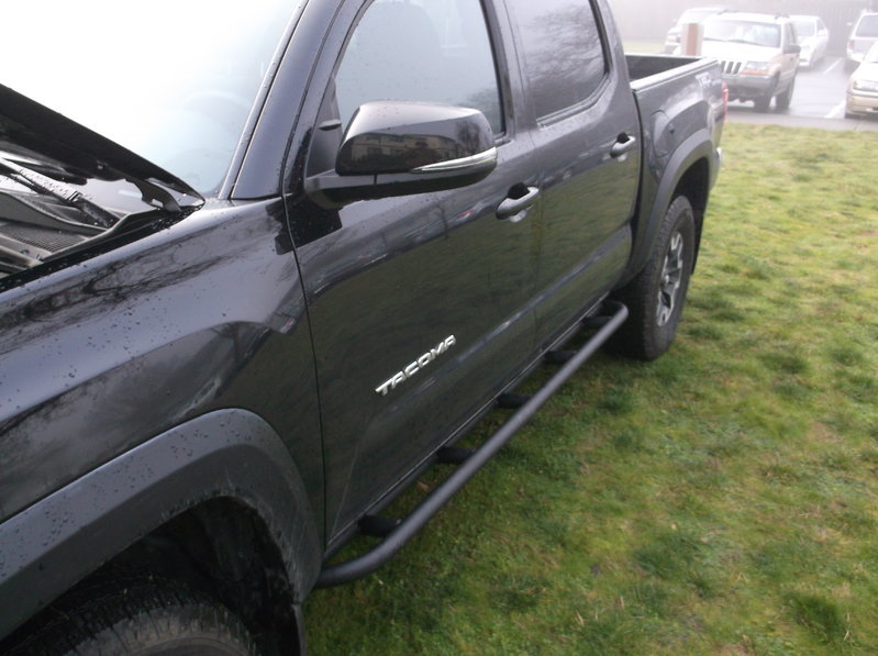

    Sooooo, this is gonna happen over the weekend!!!
    And no, that is not standard powder coat. That, my friends.... is Line-X. :p
    I added a small, painted aluminum plate behind the avid logo. To get it to stay, I just epoxy'd the shit out of it. Also mounted the Cali Raised 5D combo bar.

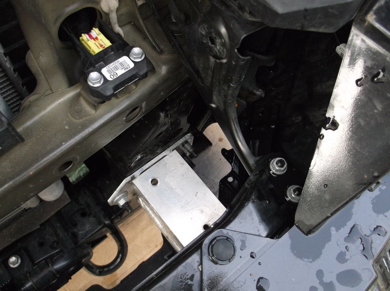

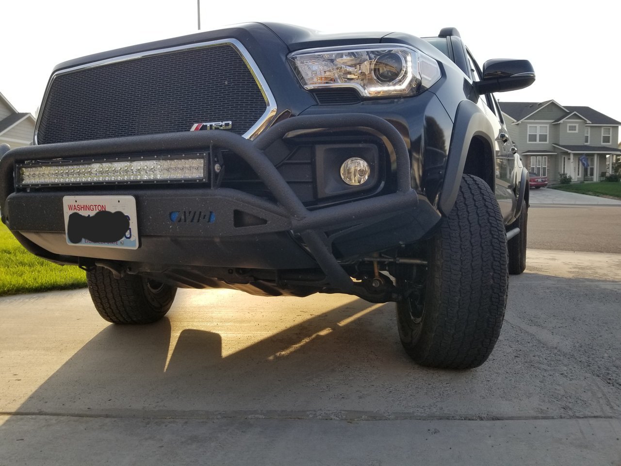

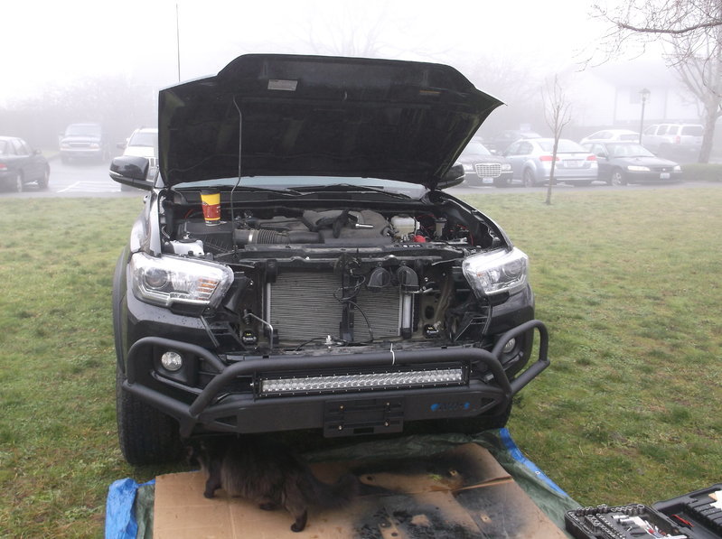

    Some frozen fingers and countless amounts of coffee later.....
    By the way, it is MUCH easier to install if you pull of the grill and radiator air deflectors!

    Truck looks great.. what rock sliders did you go with and are they a direct bolt on?
  12. Jun 26, 2017 at 6:29 PM
    #52
    Metalhead514
    Metalhead514 [OP] Darth Taco
    Jun 1, 2016
    #188494
    529
    Nate
    Washington State
    '16 TRD Off Road

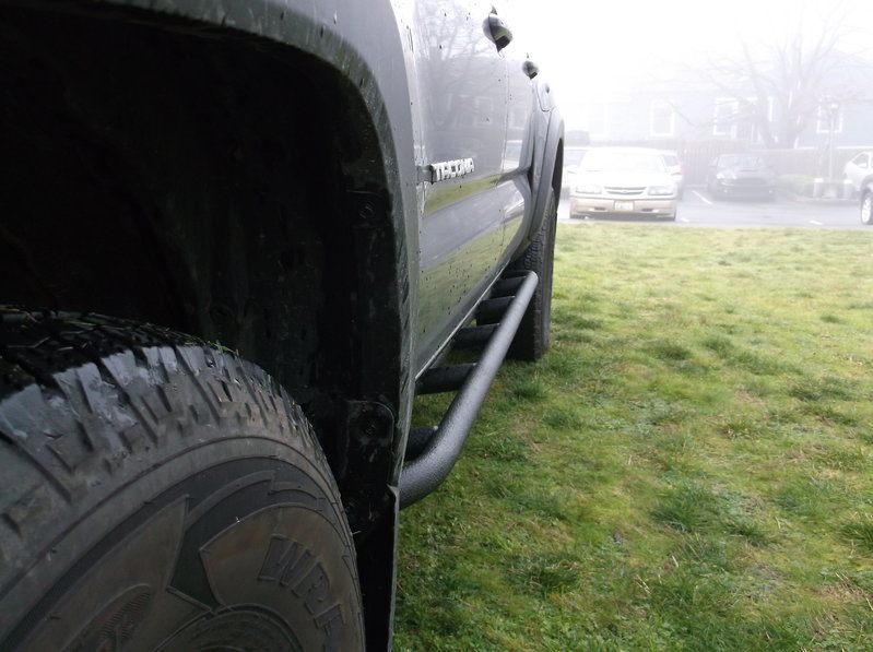

    MBRP catback, Magnuson TVS 1900 Supercharger, Injen Evolution intake, Race Louvers RST hood vent, Avid front and rear guards and side steps, Cali raised front/ rear LED's, TRD Pro Skid plate, custom aux fuse box, Bak Flip tonneau.
    They are the ones from avid off road. They are direct bolt on and use the stock running board mounts. Because of that, they won't support the weight of the truck and can't be used as a jack point. But they do offer good side protection. I spent a pretty penny coating them and the bumper guard in line-x too.

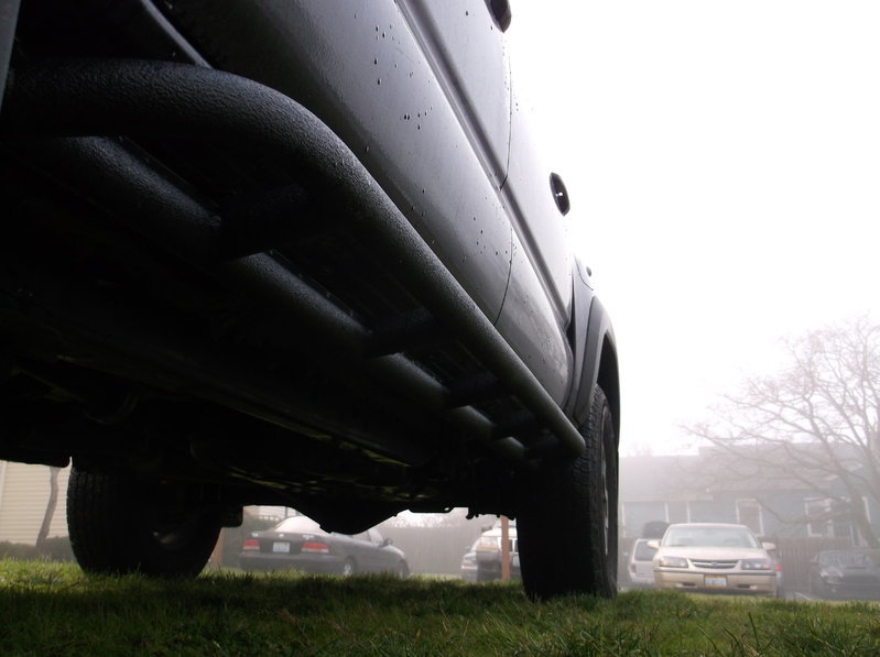

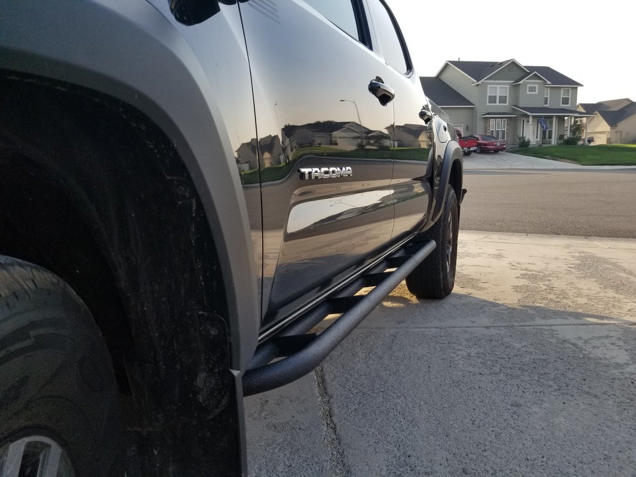

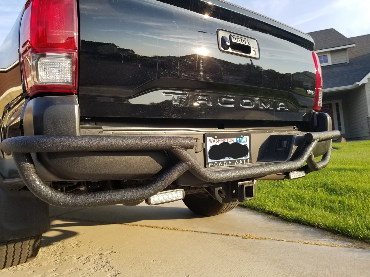

    Finally I have the full set!!!!!
    Avid gear in front, back, and sides! Took some redneck engineering to get the rear lights re mounted but it looks great! All parts have been coated in line-x for maximum awesome!
    Installation was pretty straight forward. I coated the brackets in spray-on bed liner for extra protection. I had a second person, but the install could be done with a jack stand as well. Overall, the guard is pretty solid!

    The rear bumper looks mean. How was the install ? Any cutting or drilling?
  15. Sep 9, 2017 at 3:00 PM
    #55
    Metalhead514
    Jun 1, 2016
    #188494
    529
    Nate
    Washington State
    '16 TRD Off Road
    Nope. The guard fits right over the stock bumper.

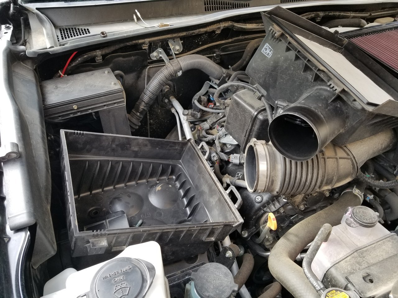

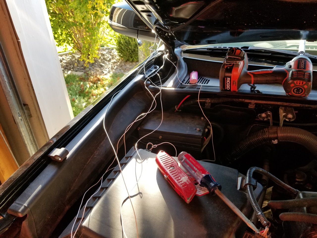

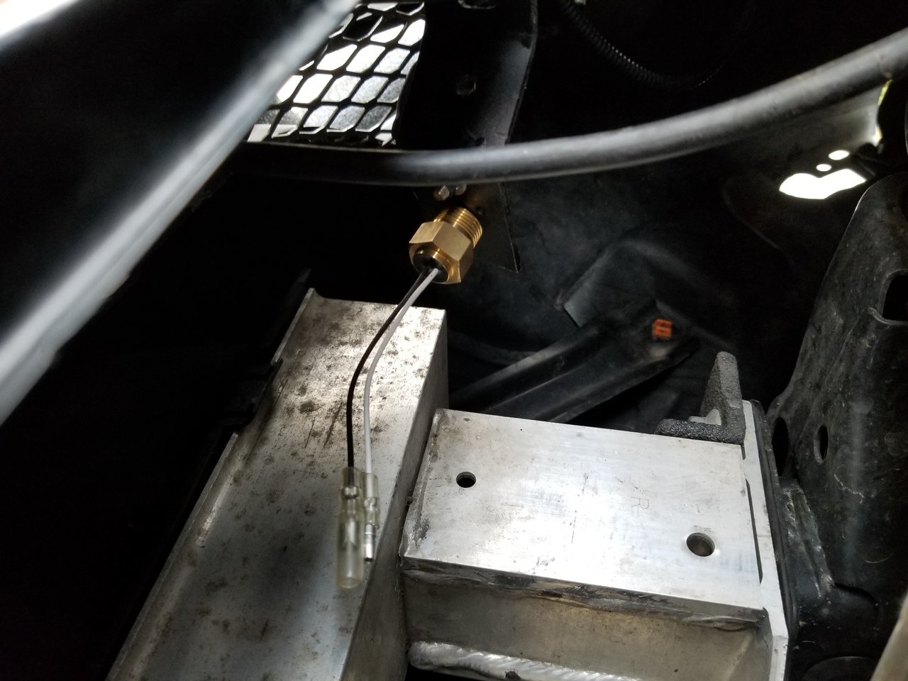

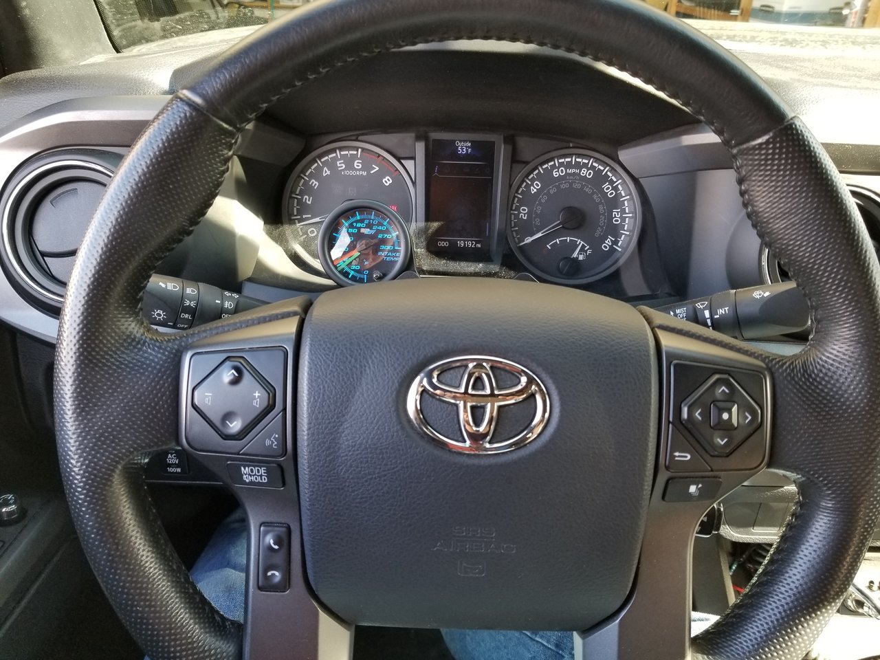

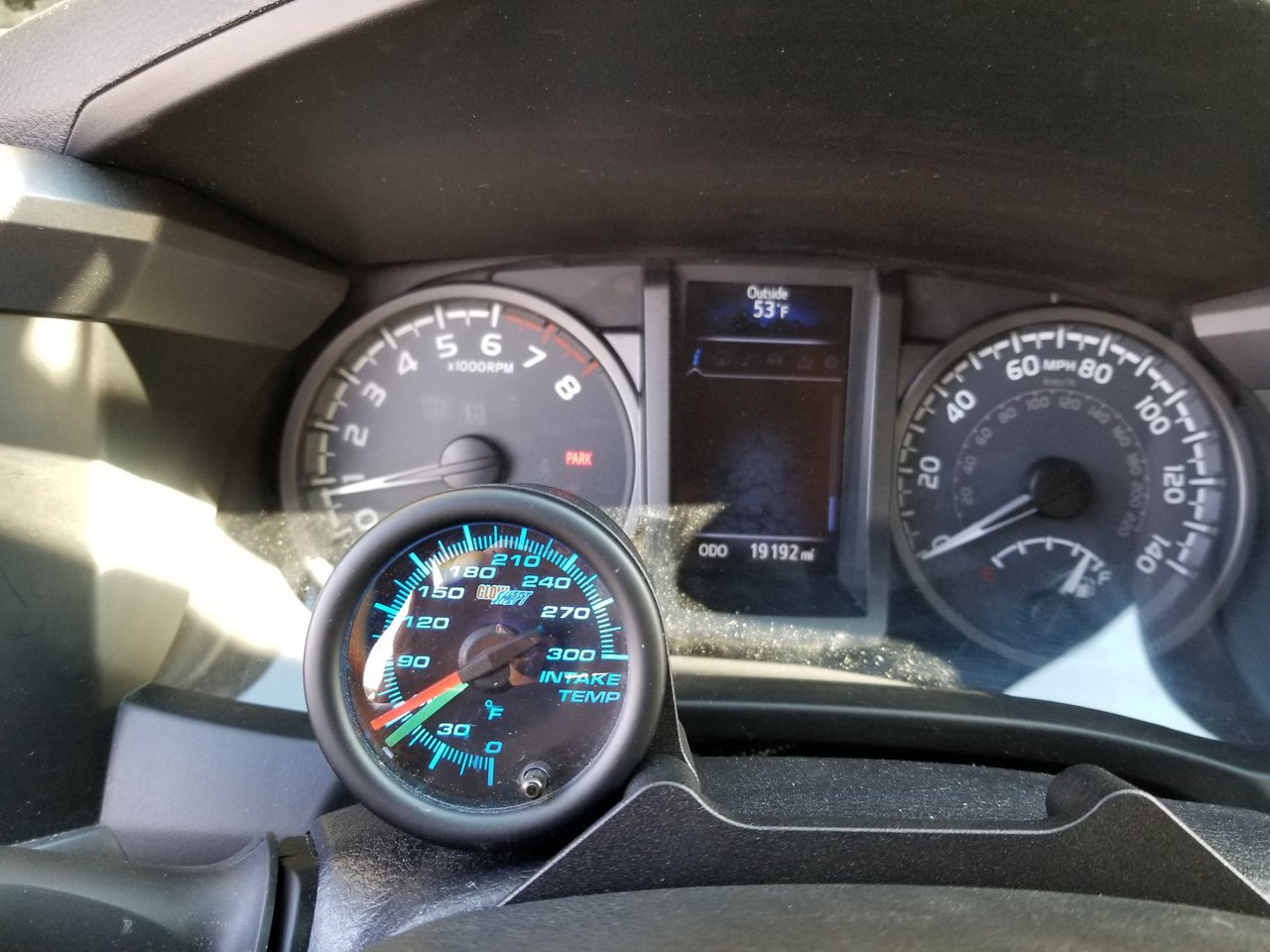

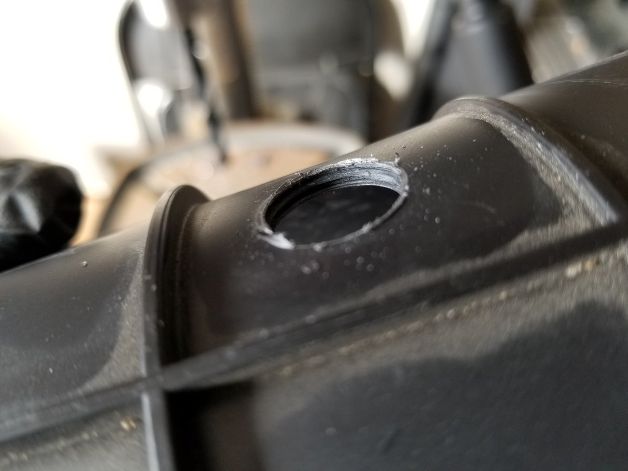

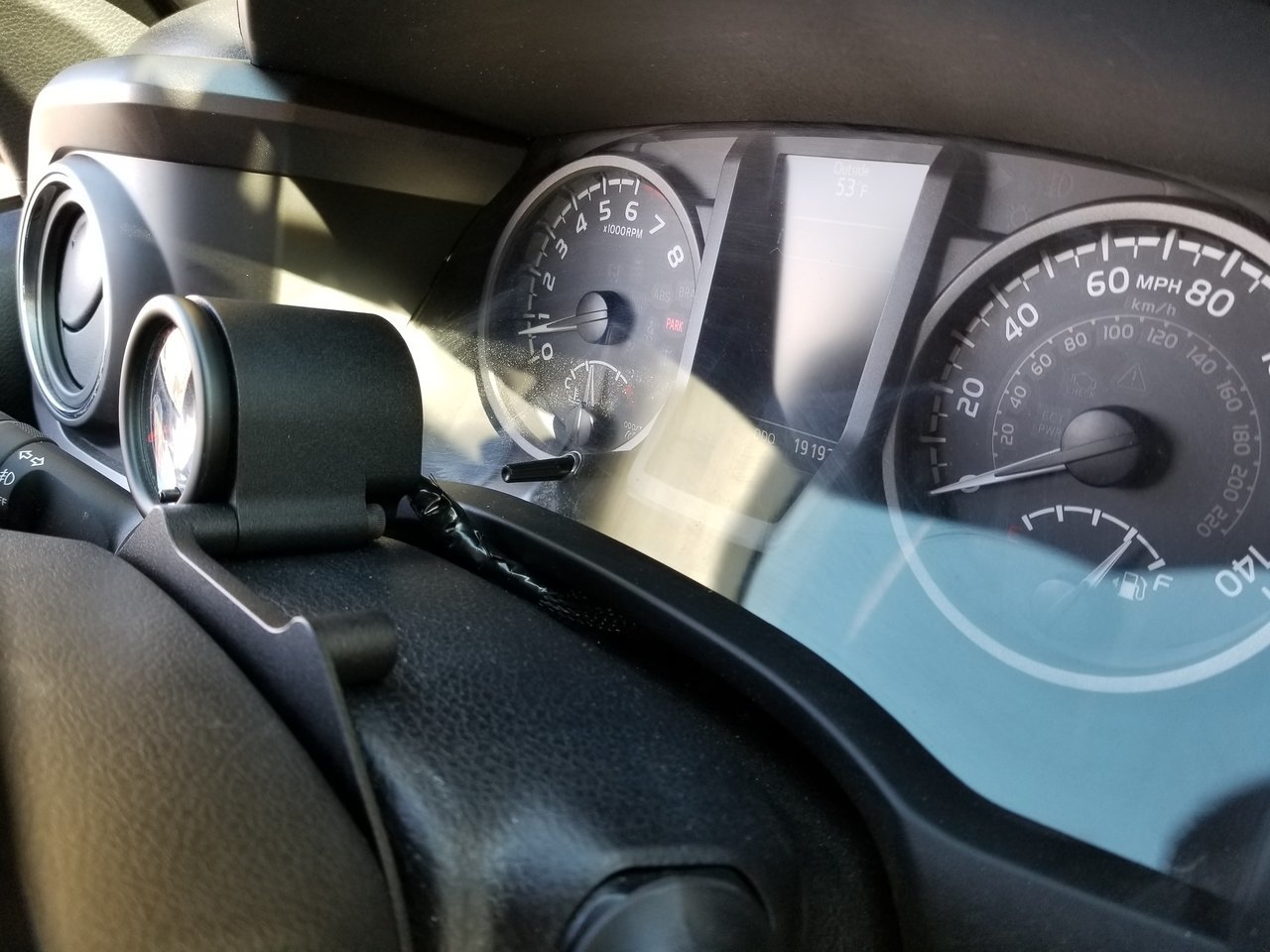

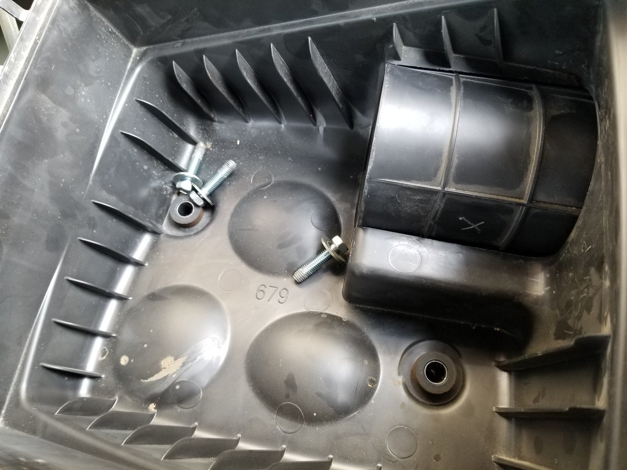

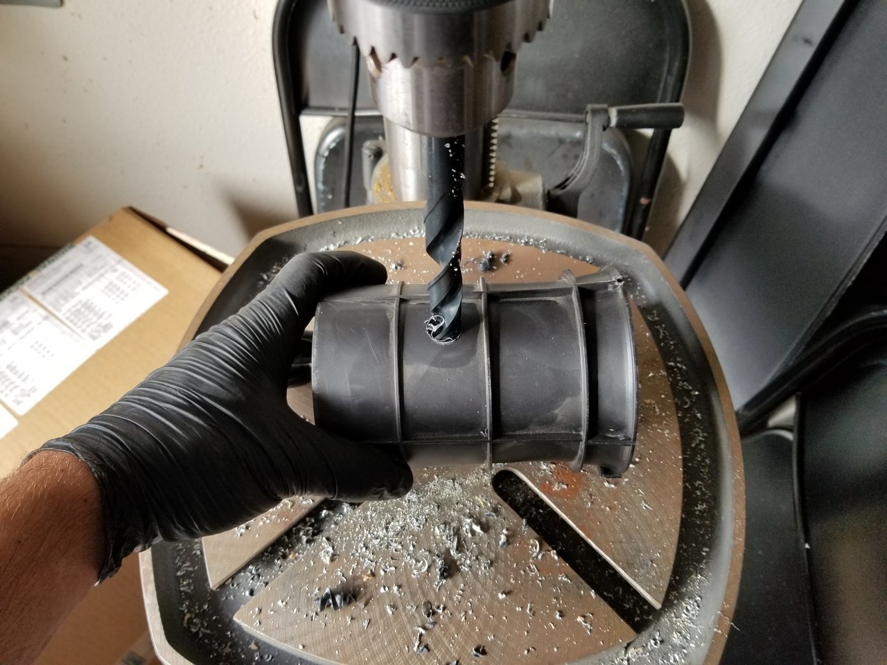

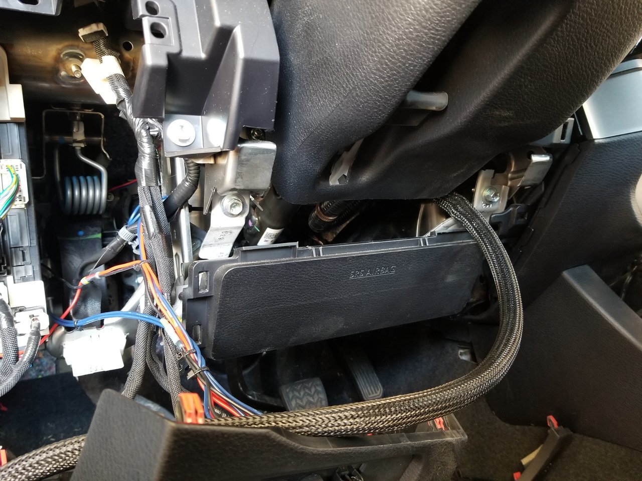

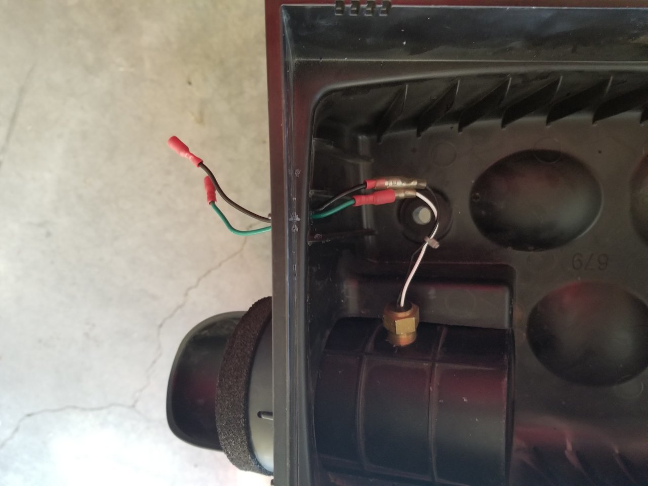

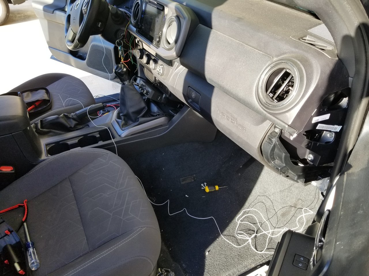

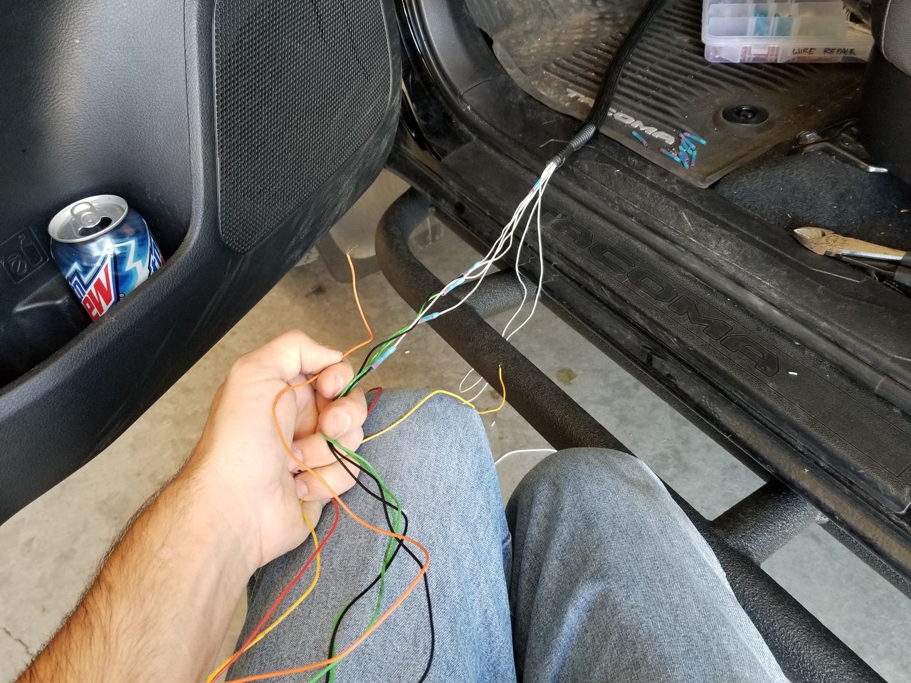

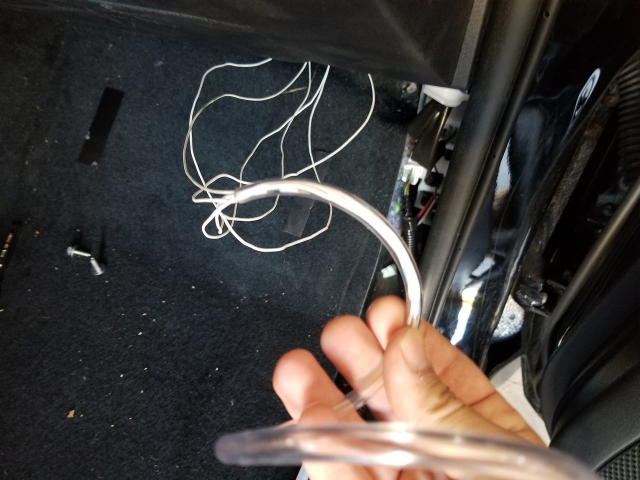

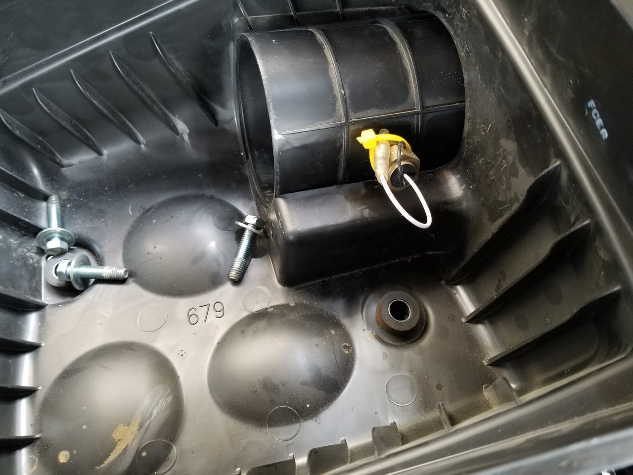

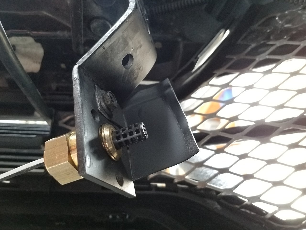

    My newest project: Installing an air temperature setup that I had in my old truck. The gauge is from glowshift and had two needles for separate sensors. Usually, this would be for a forced induction system (one on the hot side and one on the cold), but I have it set up for ambient and intake. As you can see in the pics, One sensor reads "ram" air from a custom grill part in my bumper and the "hot" is measured from inside my air box. I have done my best to upload the pictures in order.

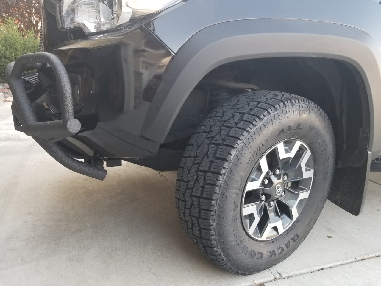

    Finally dumped the old stock shoes and got some pretty new ones!
