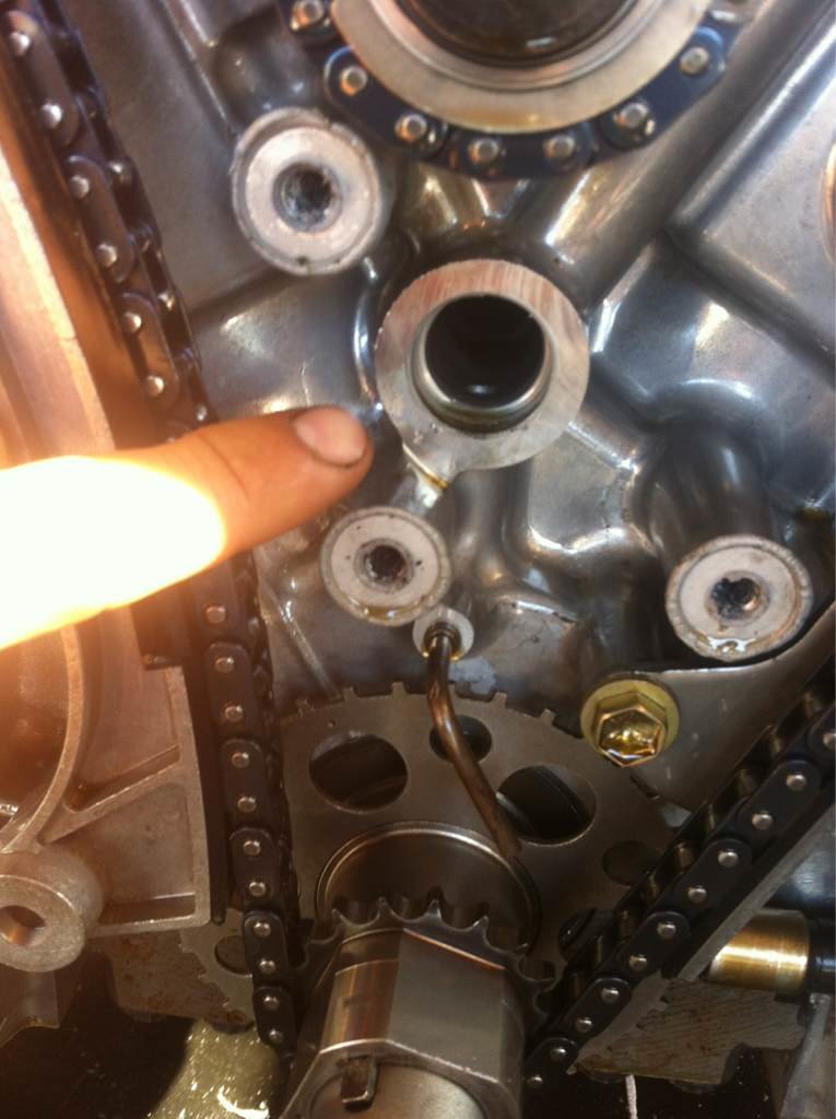

    Nevermind found out why my engine oil pressure went also need 2 take it all the way down an send it 2 darton for them 2 redo bearings

    Oil galley plug popped out of the engine lost all oil pressure found number 6 bearing worn down didn't spin but may need a crank so tor lol do you have a stock one layin around

    So I need a crank Jim called me an said its not repairable.

    BTW, do you have a picture of where the oil plug came out?

    Omg! No wonder. :(

    Yup oil galley. They are gonna make a retainer so that never happens again. Also gadget might give me a crank an David Allen is gonna see what he has an call me back
