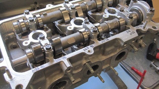

    Copied over from my build thread. Updated the first page also. :thumbsup:
    The fabled Kelford cams! [​IMG]

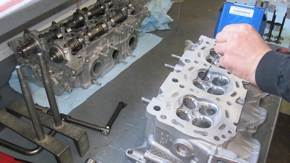

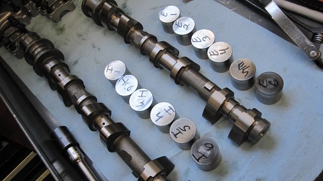

    I should also add, that a new set of dual valve springs (SuperTech) was ordered because the original set, from when LCEngineering originally built this engine, was binding when the valves were at full open. New SuperTech springs are in and work as intended. :thumbsup: All of the intake bucket shims lashed out perfectly in spec, but a few of the exhaust bucket shims were out of tolerance. Those were ordered and will be in soon.
    Here are the specs of my camshafts, for a point of reference:
    Kelford Camshafts Stage 2 Turbo cams.
    Total duration 265 intake, 270 exhaust.
    Duration at 1mm valve lift, 225 inlet, 231 exhaust.
    Total valve lift with lash set, 10.55mm inlet, 10.75mm exhaust.
    The OEM total durations are 232 intake, and 236 exhaust.

    Still working just fine. They did require a lot of removal head material for lobe clearance. There is a Kelford camshafts group buy thread. Those members purchased camshafts more recently, which were more drop in. All of them require upgraded springs.
