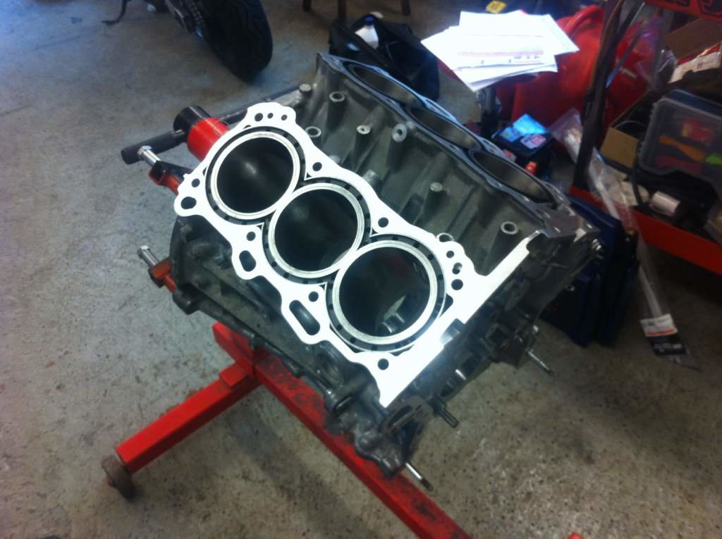

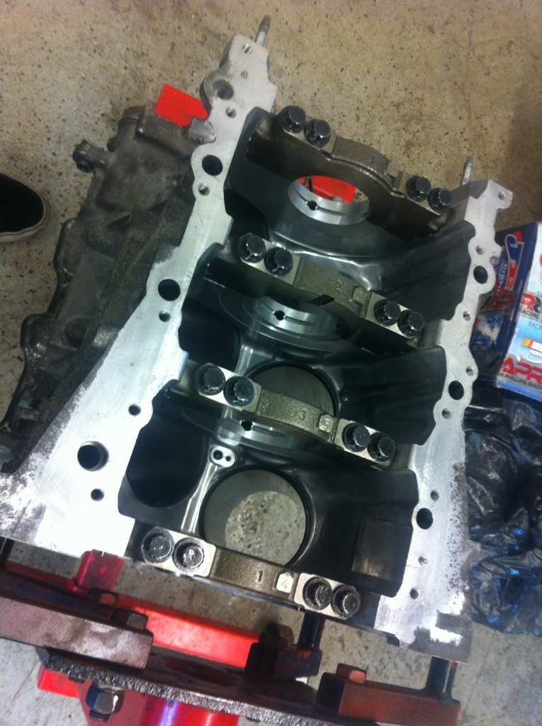

    y4a5ytyj_037b7ac9e545968e08b33678d9a542b5b380b529.jpge7a7u3e8_94beca93f20551199f1d6a1bd331731afaa59e22.jpg
    I already have the crank installed I'm gonna take a pic later I'm waiting to hear back from someone on which direction the pistons get installed since they wer machined for the valves 2 clear but other than than ill be rolling

    ::starts googling FPRs::
    And drooling over those block photos and waiting for the rest...

    Phew!!! That looks schmexy!!!
