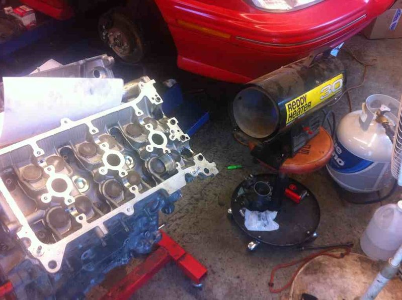

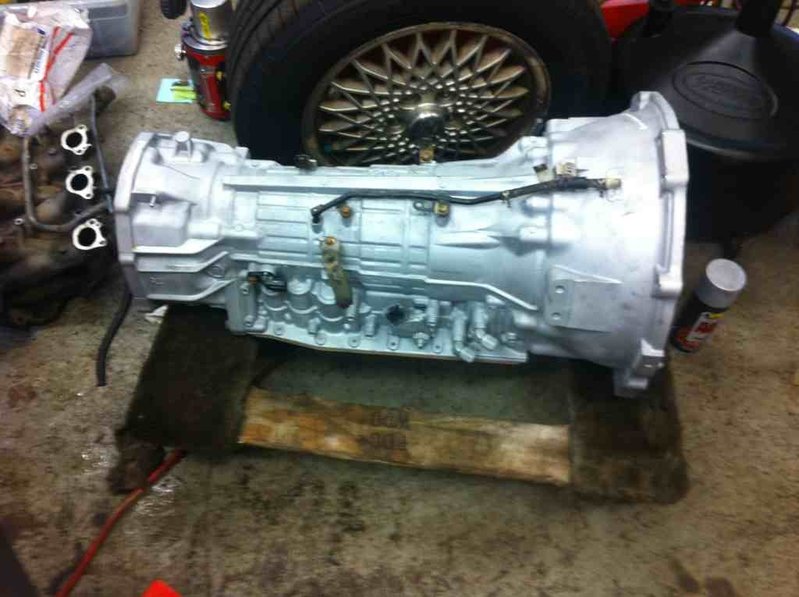

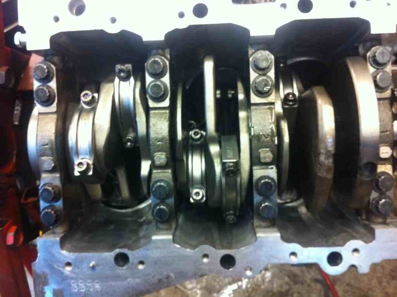

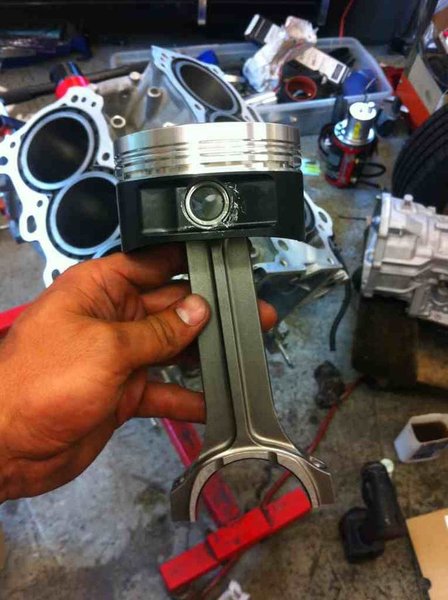

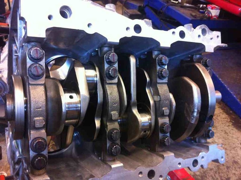

    Update for y'all [​IMG][​IMG][​IMG][​IMG][​IMG]bottom half is 2gether [​IMG]trans is done

    Are those metal shavings near the wrist pin or scratches in the coating???

    Scratches. The clips are a pain 2 put it

    Those wrist pin rings can be a severe pain in the ass if you don't have practice.

    Ya I got it down after the first 2 it's been a while since I've done them

    not that it really matters but I would try masking them off with some tape before attempting to get them in. I know they are hard, but I would be so anal about not scratching something I just paid several grand for :p

    It's no biggie doesn't affect anythin ImageUploadedByTapatalk1375037051.206828.jpgImageUploadedByTapatalk1375037070.688521.jpgImageUploadedByTapatalk1375037745.686383.jpgImageUploadedByTapatalk1375037761.535881.jpg

    No worries. I had the same problem on my JE's as well. Even had one sucker shoot out towards my face. Lol. Glad I had safety glasses on. :cool:

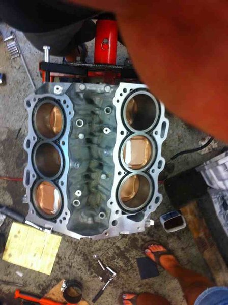

    So I'm warming up the engine to 200degress so I can torque the head studs properly it's a extra step that is necessary with copper head gaskets [​IMG]

    Yup my goal is 2 have a assembled engine by the end of the day an start puttin the Trans an engine in 2moro

    Did you get the copper head gaskets with the engine, or from somewhere else?
