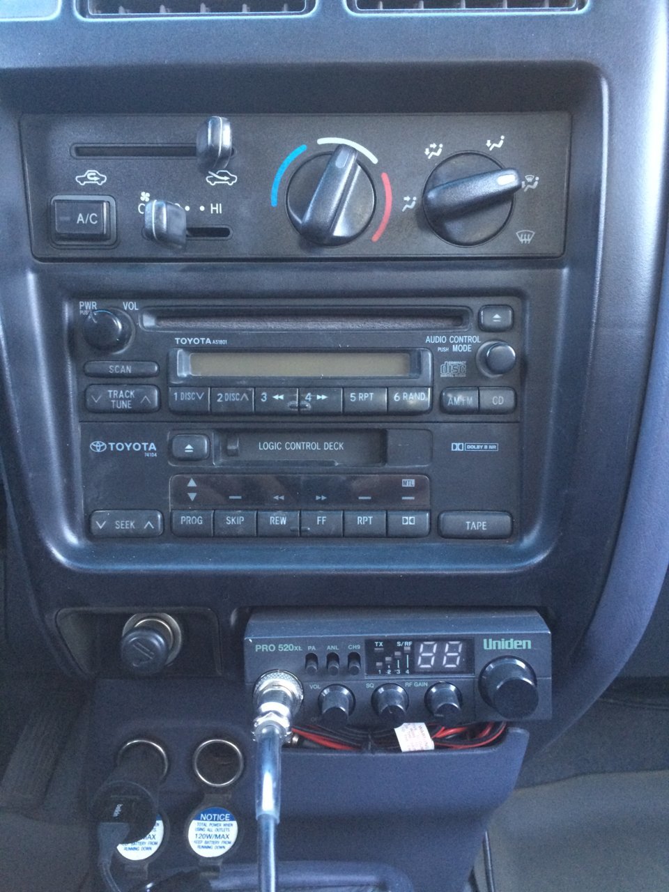

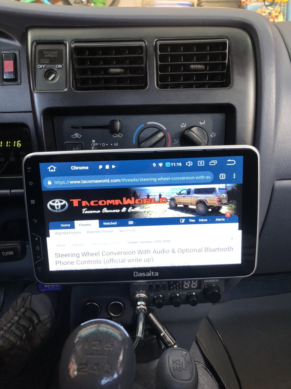

    Over Thanksgiving, I upgraded my 1999 Tacoma with some 21st century electronics.
    A Dasaita HA2186-MAX6-CP
    Before:
    After:
    Huge upgrade for me to now have all the features the Dasaita Head Unit provides.
    Some thoughts:
    I am not a sound aficionado, I still have the stock speakers. The head unit sounds as clear or maybe a little better compared to the stock stereo to me.
    I like the touch screen position on the 1st gen because reflections are not an issue. The driver looks down at the screen and any reflections will be of the floor or passenger seat which are typically dark. The screen is viewable with polarized sunglasses. At night the screen's brightness is comfortable - not too bright but easily viewable.
    I like how the screen is closer to my hand compared to the stock radio controls. I do not have to reach anymore.
    The bad thing about the lower position is that it averts my eyes from the road. I have to make sure I do not stare down at the screen.
    I wonder how this Chinese head unit will handle bouncing around on dusty trails in the hot summer? I will find out soon.
    I inserted the styrofoam that came with the packaging between the display and the head unit. The display is cantilevered to the head unit with a ball joint that has a tiny bit of play. The styrofoam should distribute the display load on the head unit faceplate, acting as a shock absorber when bouncing around on the trail.
    The display is a little bit in the way of the HVAC controls, but I can still get to them easy enough. It doesn't bother me. If I ever remove the CB radio I can move the display lower.
    You can checkout details of the installation in my build thread.

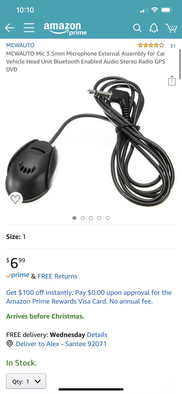

    What size is the microphone input on the back? It's not 3.5 mm from what I can tell.
  12. Dec 15, 2019 at 10:11 AM
    #912
    EastCountyTaco
    EastCountyTaco Well-Known Member
    Sep 5, 2019
    #304450
    92
    San Diego, CA
    2019 SW DCLB TRD OR
    Mine was 3.5mm... below is the microphone that came with my unit.
  13. Dec 15, 2019 at 10:13 AM
    #913
    crashdb
    crashdb I break chainsaws
    Aug 16, 2017
    #226954
    9,709
    Dave
    Manassas, VA
    2008 Toyota Matrix
    Rollin' hydrocarbons!
    Weird. Is there anything smaller than that? I have a mic that came with my pioneer and the plug is too small.
  14. Dec 15, 2019 at 10:47 AM
    #914
    EastCountyTaco
    Sep 5, 2019
    #304450
    92
    San Diego, CA
    2019 SW DCLB TRD OR
    Microphones are either a 2.5mm or 3.5mm. I believe pioneers come with a 2.5mm, Dasaitas use 3.5mm.

    Of course. Thanks. Off to get a new mic.

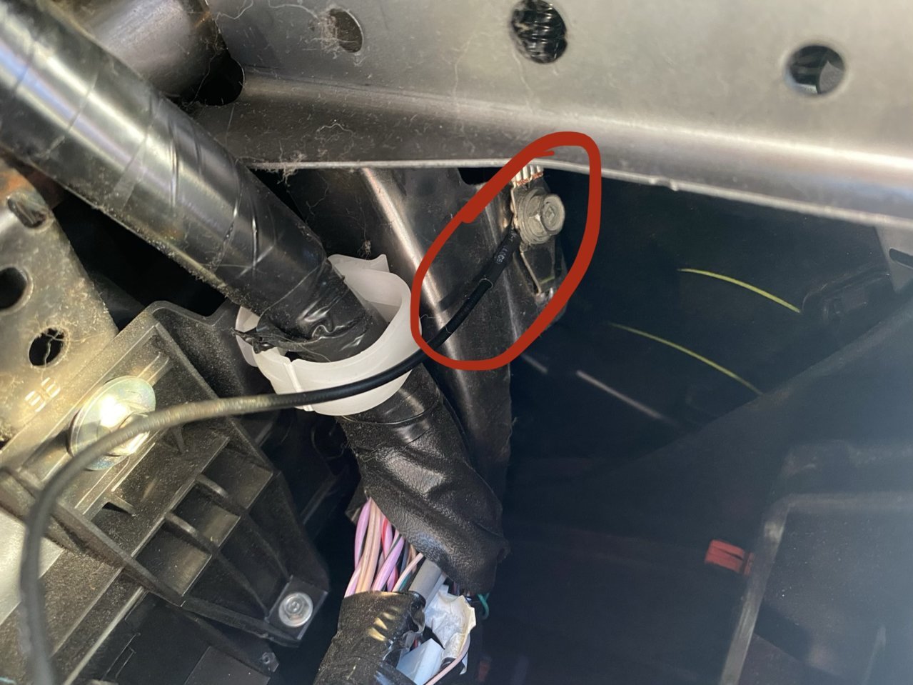

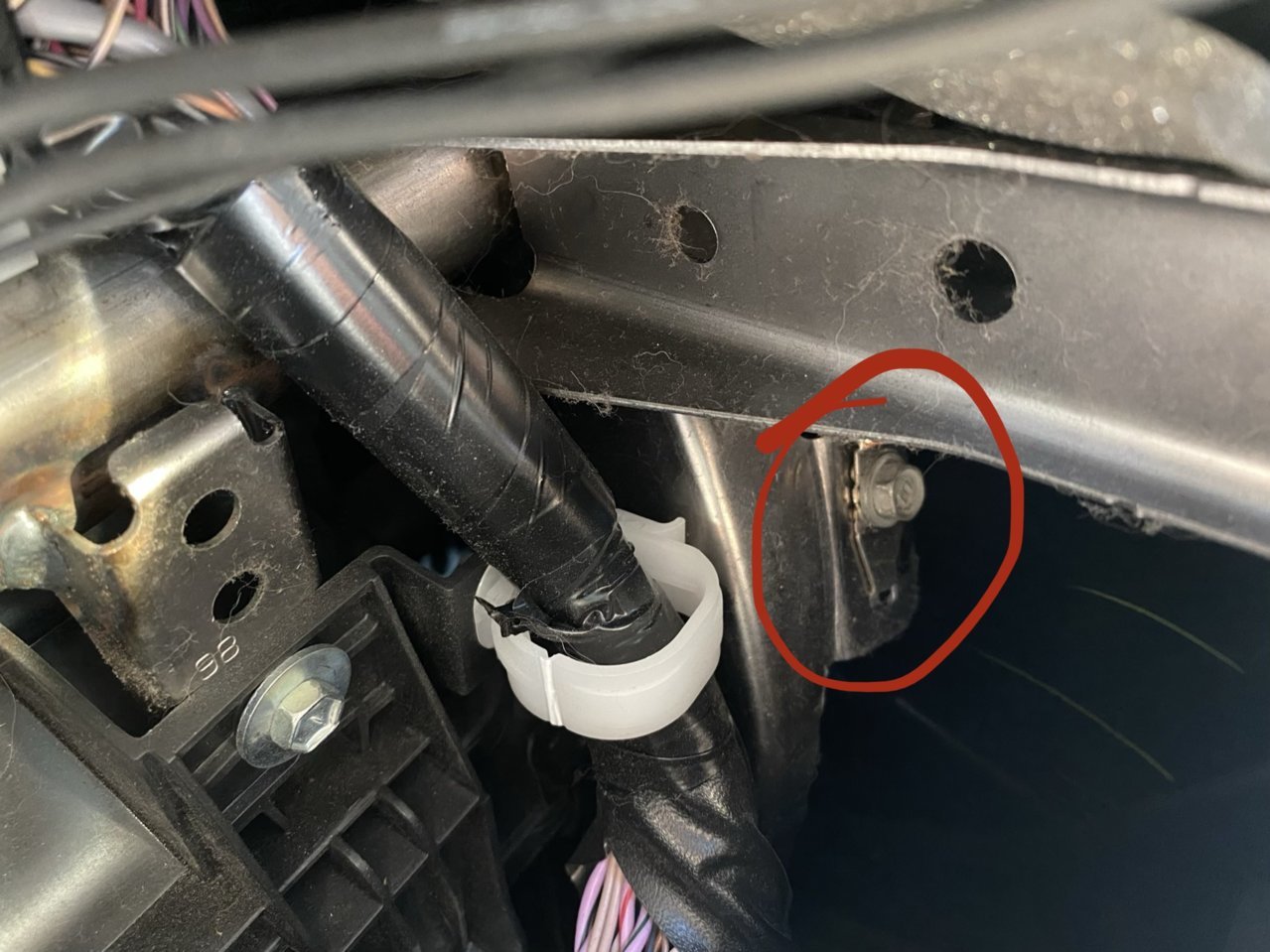

    So I took my radio out again today to install the gps adapter that came in the mail. Was a perfect fit and now gps location works great. Order the adapter in OP’s post!
    i took a few pictures of the inside to confirm the ground points. Is this it? Seemed like there was two other wires going to this point as well.
    8BA9C2BB-A3F4-4E8D-82A1-E76E40CA7DAE.jpg 7E501E68-DDAE-4B8D-A01D-37911366C771.jpg
    This is after attaching the ground wire from the radio9130BA2E-C463-469D-85E0-C17B680568F2.jpg

    One to the left works, too. And a little easier to get to.
