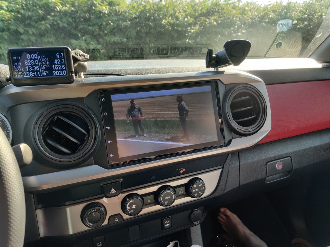

    Had a drive before everything went to poop, and my wife watched Into the Spider-Verse from Plex on our 3 hour drive on this thing, pretty awesome imo.

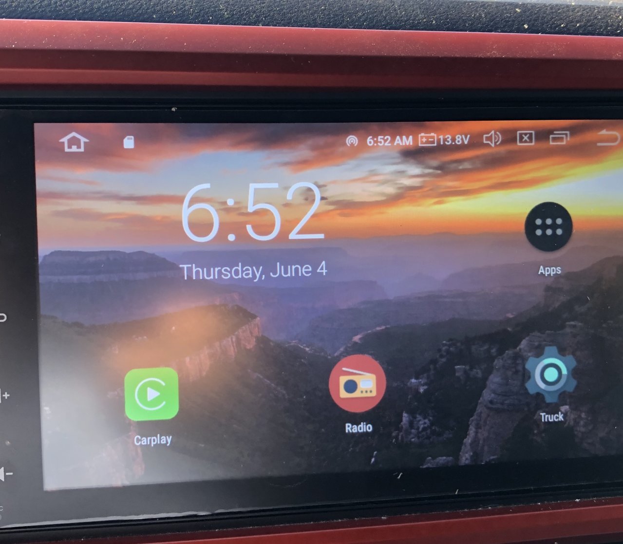

    Did the factory reset, seemed to resolve the connectivity issues. Zlink still says "Please connect internet Synchronization time, then activate" I figured it was the wifi/hotspot but no dice. Attempted to google it, seems its an android thing?
    I did factory reset -> 04232020 update maybe I missed a step? I just want stinking carplay to work lol

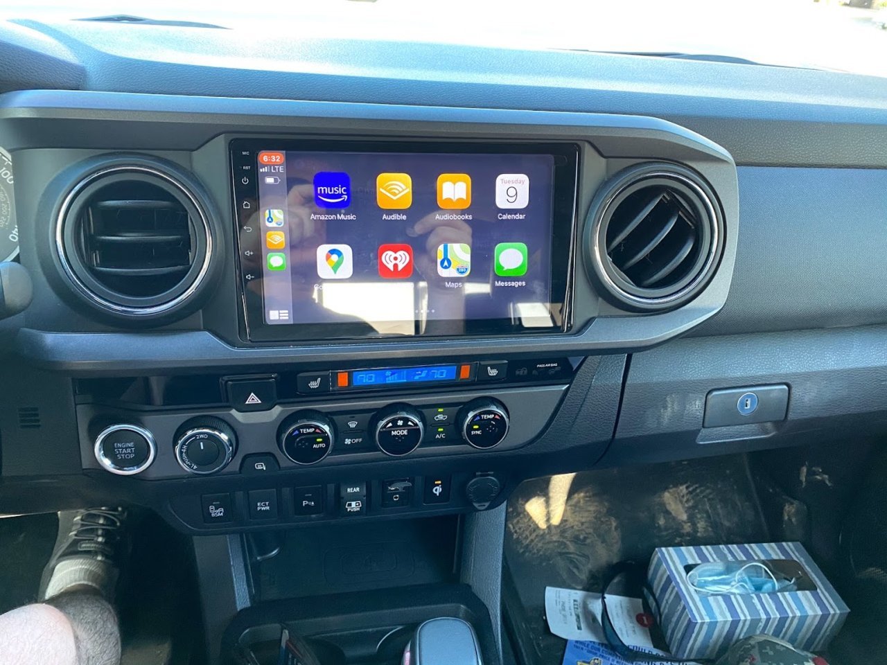

    Finally received my PX6 and got it installed. Like it so far, some issues with getting the wirless CarPlay to work but usually just have to do a quick reset and it is fine. Have not done much more with it.

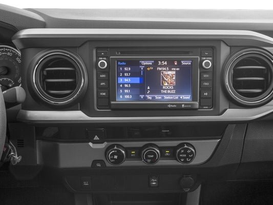

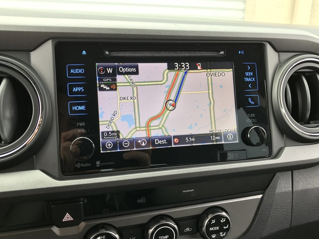

    If your radio looks like the first pic you will need a new trim piece, if it is like the second one you wont

    appreciate this, so yeah im good. got the second one..
