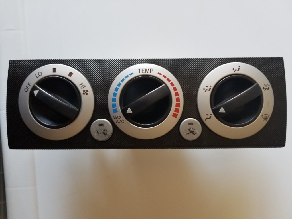

    Came out good! Now all you need to do is the black climate control swap so everything will match :)

    Yeah. Thanks for the encouragement. I know some have painted the A/C controls but I have no clue how they sand/prepped the surface for paint when it's textured (dimpled).

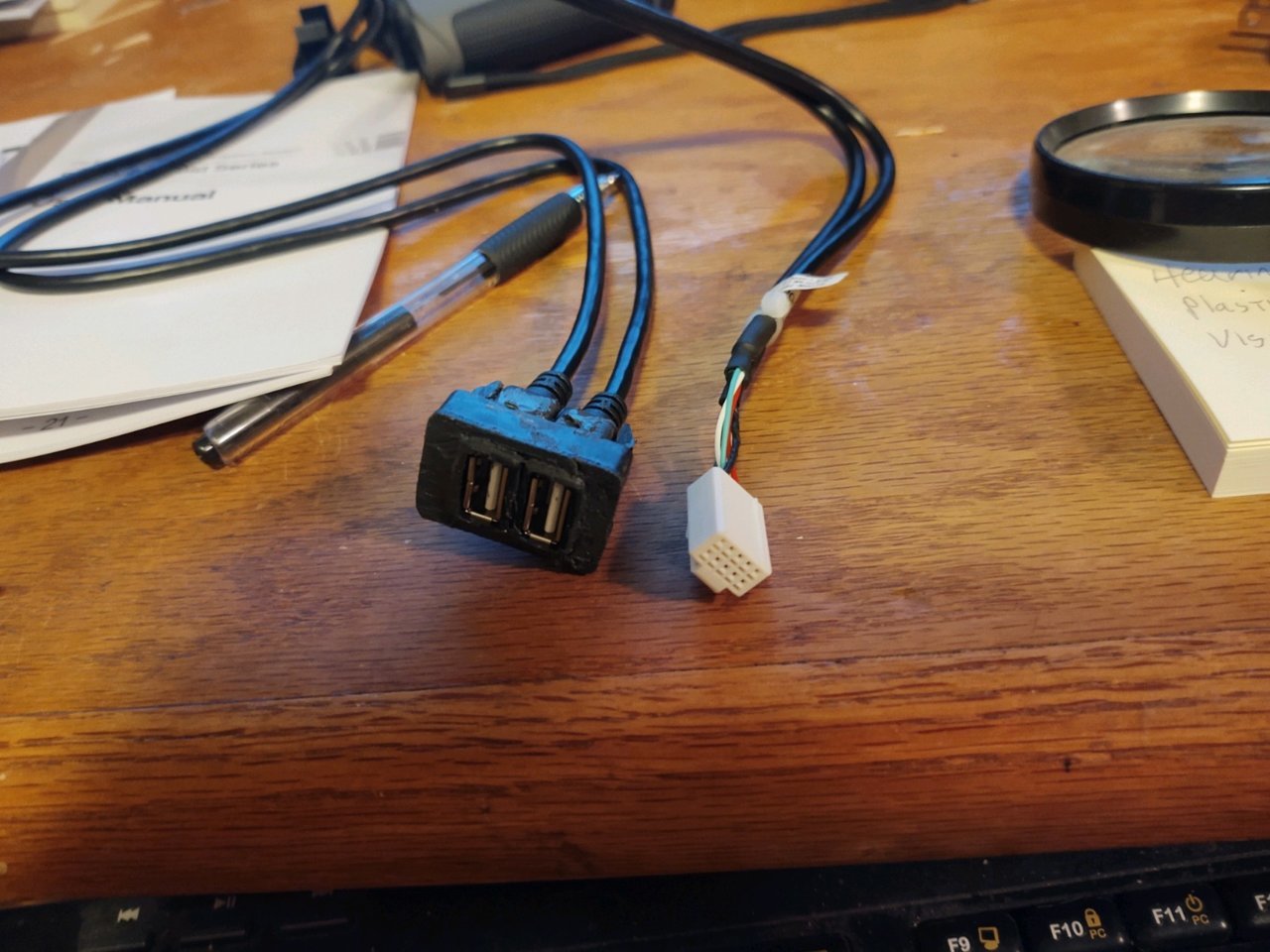

    So got everything hooked up and everything works (GPS, radio, WIFI, Phone/Bluetooth, Navigation) except steering wheel controls (2014 Tacoma). I went into settings and it showed a screen with reset and save tabs and it said to press the steering wheel controls. Tried them all and nothing works. Am I doing something wrong here???
    Left over OEM plugs (one is USB but not sure what other two are).
    Left over Dasaita plugs (two white ones and two small black ones).
