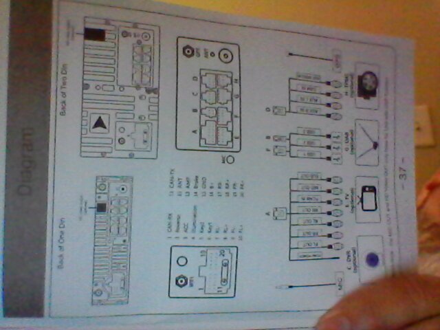

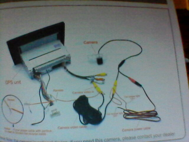

    So now I have a few questions that I hope the group can help me with.
    1. We're is the best spot to pick up the reverse power signal for an aftermarket camera?
    2. Where should I bring the camera wiring in to the cab at? Is there an easy penetration point?
    3. I have the old style XM standalone head unit that uses the FM injector through the antenna, does anyone know if it will work with the Dasaita unit? My initial thought is why not, but hey, lots of my thoughts end up in the trashcan.
    I've read the entire thread, and may have seen the answers to the above, but, old and in the way.
    Thanks for all your help!
  9. Feb 4, 2021 at 12:44 PM
    #849
    TheTacoAbides
    TheTacoAbides Well-Known Member
    Nov 4, 2017
    #235007
    127
    Randy
    2013 Black Tacoma SR5
    Rough country 3" lift and level. Tuff AT 20" rims. Nitto Terra Grappler G2.
    1). The standard wiring harness picks up reverse at pin 2 of the main connector (there are 8 more connectors plus the optional CANBUS module that can add in much more). I'm reasonably certain you won't need CANBUS for the 1st gen. I'm not certain if the 1st gen feeds pin 2 so that you could tap in there. On my 2nd gen with the backup camera in the rearview mirror, the reverse lead still gets power down in the head unit.
    2). Nothing I can add
    3). If it's the flavor I remember then it gave you 3 options for where you could tune on the FM dial to get the XM station output. The external device is where you did all the tuning to select your desired XM station. The dasaita (and virtually all the Chinese android head units in the space) has a traditional RCA style antenna input. The XM adapter should be able to fit inline at that point. Now on my 2nd gen, there was an adapter that plugged in to the Toyota specific antenna harness and created the RCA style adapter for the radio. I imagine it would be the same flavor for the 1st gen.
    Here's the pinout diagram from my (meager) owners manual.
