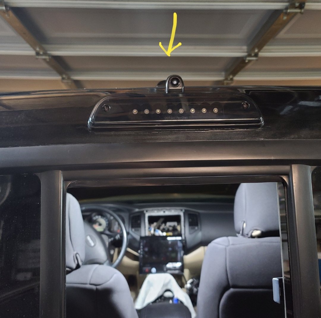

    Are there any instructions to where exactly the rear camera video sources is by the driver side kick panel?
    I already ran a wire to the reverse signal, but I don't know where the video source is. Any help is appreciated - I don't want to install/wire a whole new camera!

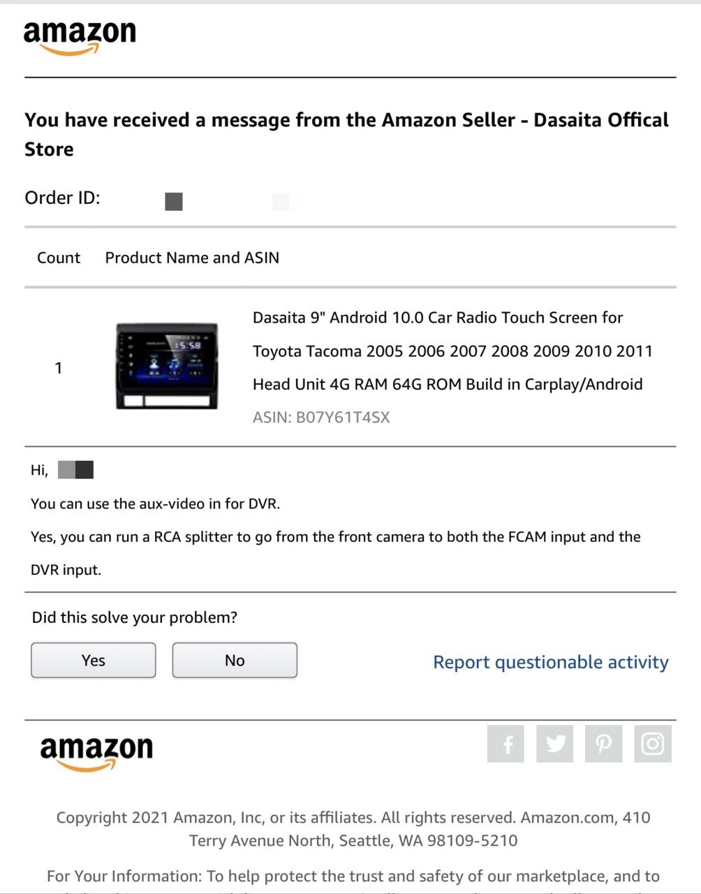

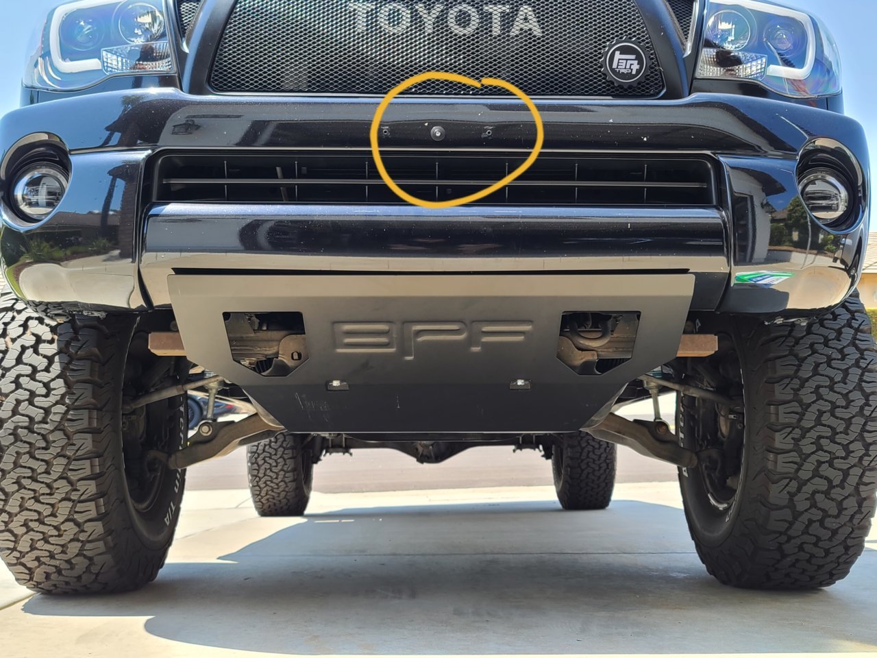

    Hey all - So I installed the front cam to the FCAM input on my Dasaita head unit. The camera works great, good reception and it comes on manually when I select FCAM on the Home Screen. I noticed the Dasaita has a DVR option - I asked Iris if I can use the FCAM to link with the DVR and she said no... so Im wondering, 1) does anyone know which input the DVR runs off of? and 2) If I ran an simple RCA splitter from my front camera RCA to the FCAM and whichever input the DVR uses, would that work (theoretically?) It's been about 20 years since I've done any real car audio / electronics - so Im a bit rusty.

    FYI, received this from Iris. May give it a try to see if it works.
