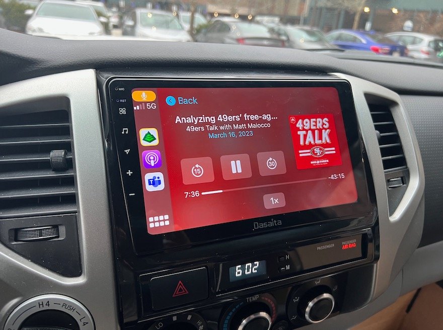

    Following up on my install. There was more to it than I expected, but it's installed, looks beautiful, and sounds great. Some issues:
    • Trying a few things, I was able to minimize the gap I referenced above, but not eliminate it. Did my best and slapped some black foam tape behind the gaps and called it good.
    • I followed this procedure to make my hazard insert work.
    • I'm getting playback stutter when I play audio from my iPhone to the unit via bluetooth. USB is fine.
    • The Android weather app won't load weather conditions even with a WiFi connection.
    I think I'm happy, but Dasaita really should do better regarding the hazard bracket. It's ludicrous to have to buy/scavage a used radio to solve to this. The gap issue is annoying as well.

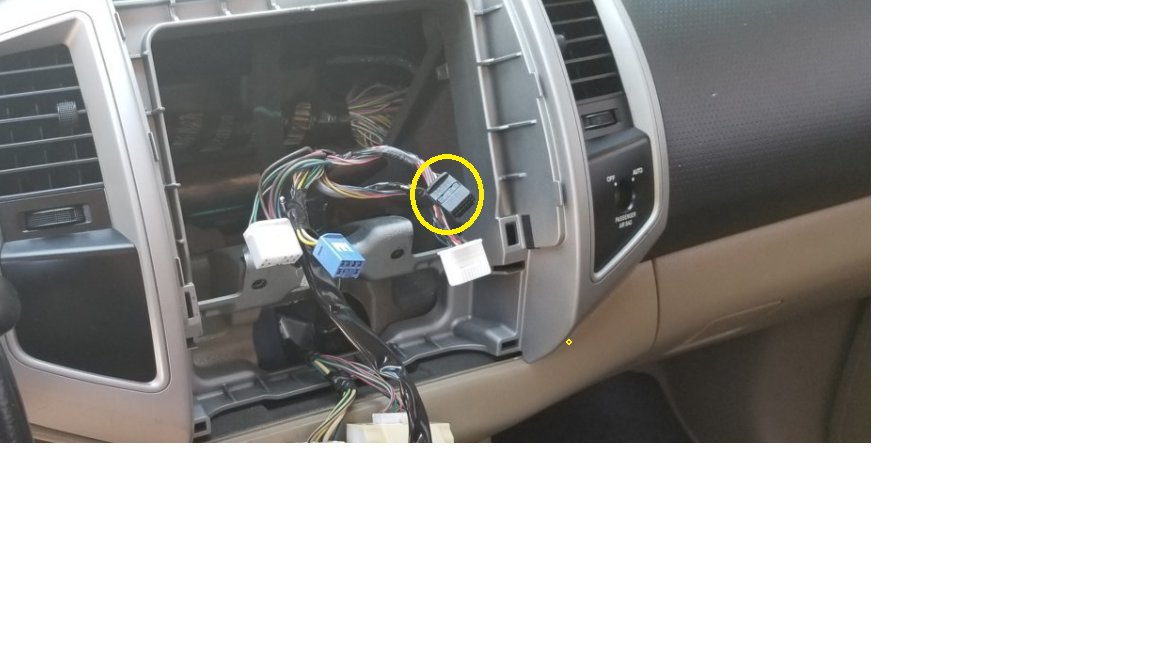

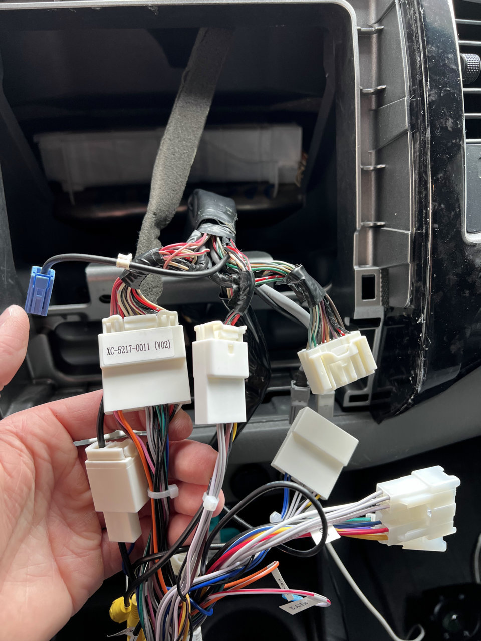

    San Jose, CA (Nor-Cal)
    2010 SSM DCLB

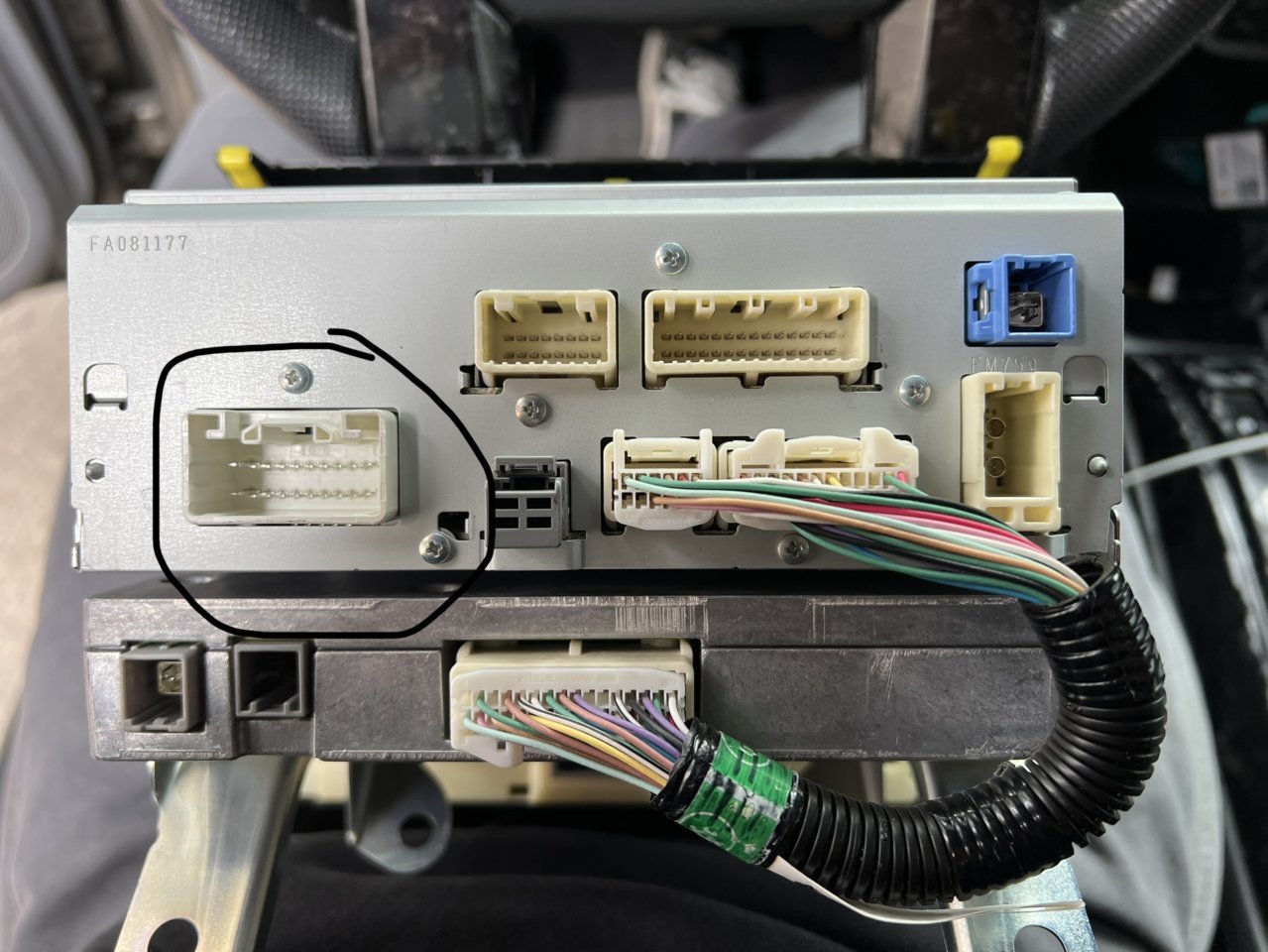

    I ordered my Seicane unit and it was delivered last night. I managed to get it installed enough for use. I seem to still have 1 connection on the truck side that is not used and I do not have steering wheel controls. Any possible insight? I have attached a picture of the connector that I do not have plugged in (stolen from this thread because I don't have my own picture and I'm too lazy to go get one while I'm at work :p. I have a '10 non-jbl for what it's worth. Untitled.png

    #257030
    464
    I sorta recall having extra unused connectors both from the unit and truck and everything worked fine.

    #1200
