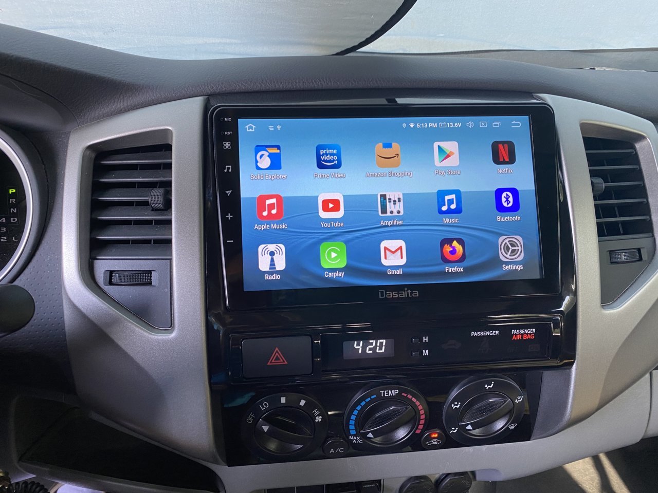

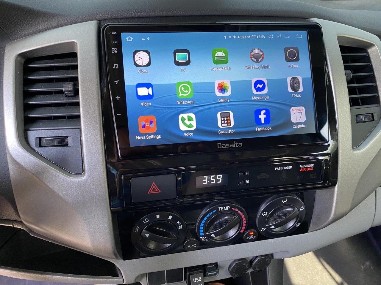

    There are so many pages and threads, I thought I'd give back a bit after all the research I had to do and provide shortcuts for those trying to install Dasaita on 2012 and up where the hazard and clock don't fit the trim. This stereo is really great and after demoing the laggy as hell 1000 dollar pioneer units I really made the right choice.

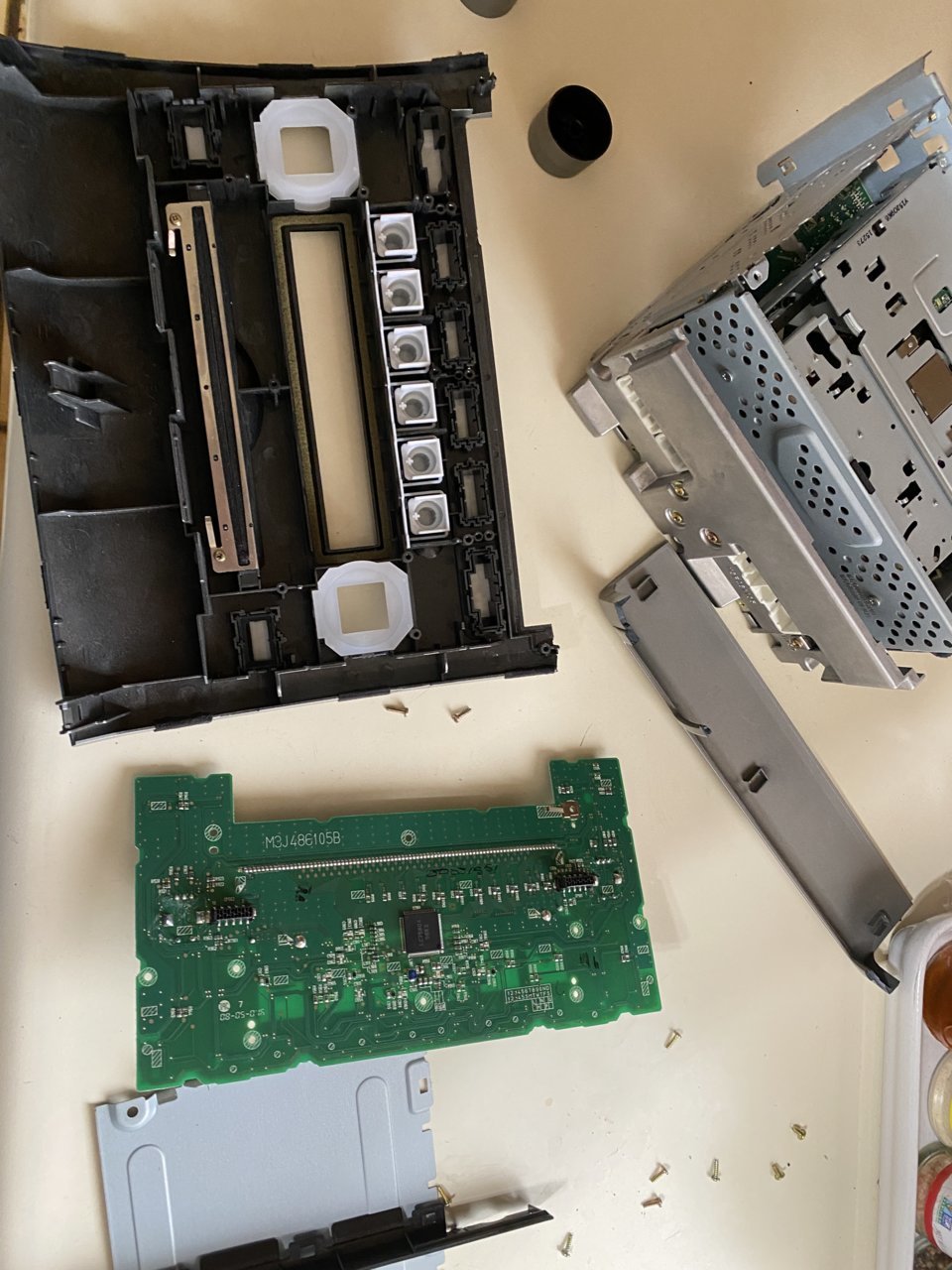

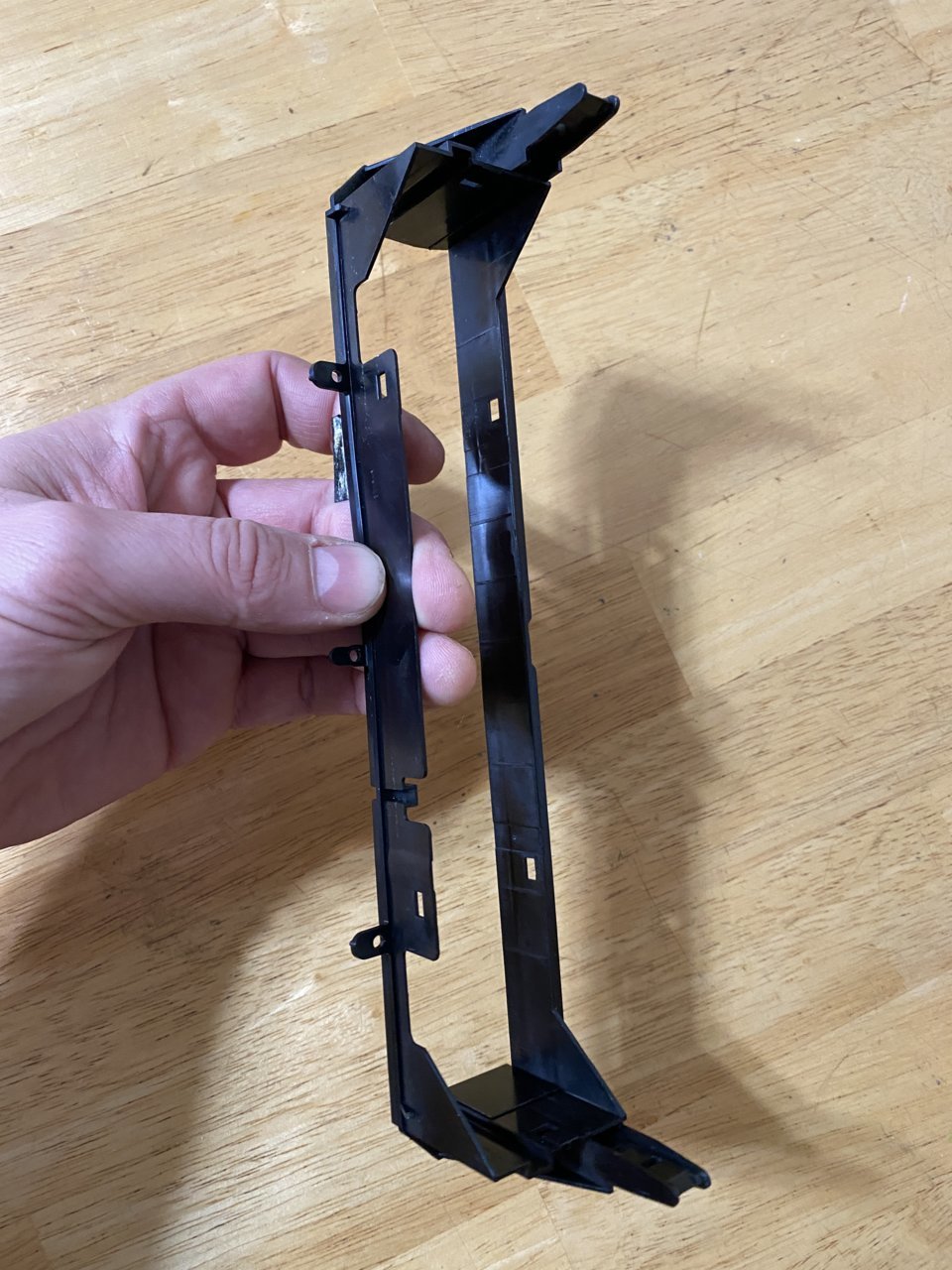

    OEM Radio (for bezel to secure hazard clock)
    Look on offerup or craigslist
    for a 2005-2011 OEM radio broken for parts. There are tons of them. You just need the clock hazard bezel pictured below. I got a 2005 for 20 bucks. be careful taking apart the bezel. it's easy to break. You will need to take apart the entire radio as pictured below to get it. Take your time and don't force it. Break off the left and right tabs and leave the center one. You will need to trim that one slightly as well. Use the screws from the oem radio and secure it with one screw on top and 2 on side posts. it's tricky to get in but will fit. You don't really need the factory bracket now because with the 5 clips it's secure due to it being pretty light

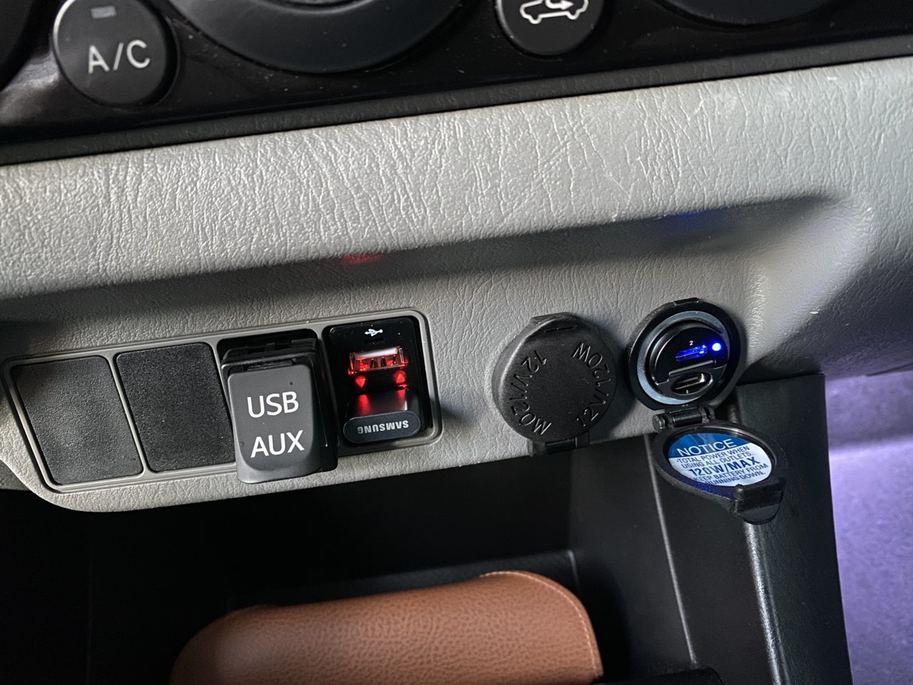

    Factory style duel usb port male to female
    Here is some useful option stuff for a clean usb dual port install. I connected the grey usb female to the factory usb and the 2 blue 3.0's to the dual port.
    https://www.crutchfield.com/p_074USBDKIT/Beuler-USBD-Kit.html
    the factory usb port is sticking out because i hadn't plugged it back in yet.
    Flush mount usb c quick charge (optional but useful cig lid closes over it)
    https://www.amazon.com/gp/product/B08G1LJ1M6/ref=ppx_yo_dt_b_asin_title_o02_s00?ie=UTF8

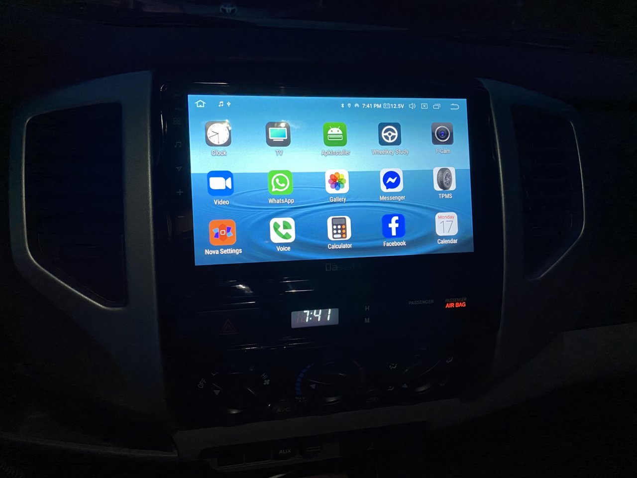

    Icon Pack
    Dasaita icons were ugly to me so I made a pack
    installing nova launcher will be helpful to apply them. Set grid to 3x5 to get bigger icons. and set icon slider to 150%

    with 3 plastic clips up top and 2 down the bottom it's secure it's really light.
