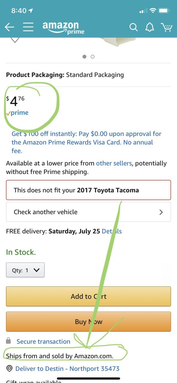

    Swing by BestBuy and grab another one. Have them price match Amazon. Make sure you click the one shipped and sold by amazon.
    TacoWdrd[QUOTED][OP] likes this.

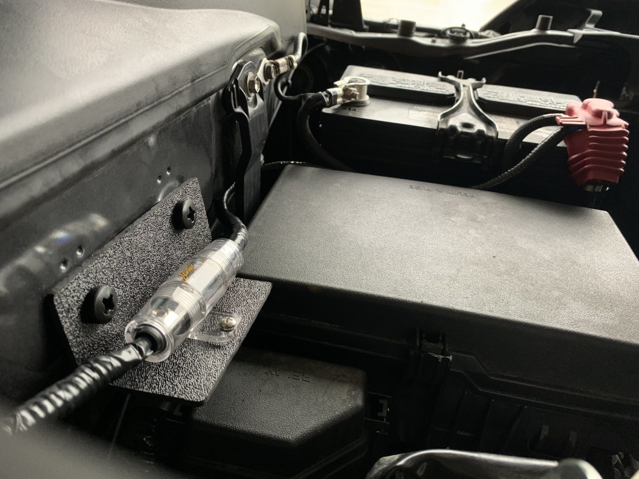

    Well had to Amazon Prime it. No one carries the male end :notsure: be here tomorrow. But I did get the rest of the wiring done and fuse bracket made.

    Aww man I didn’t realize it was the male side. Fuse holder looks good though

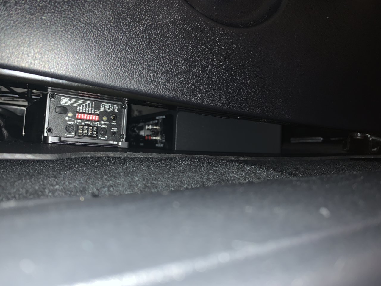

    So It just occurred to me that plug is the rears and had nothing to do with the subs as I have a T-harness for the key and had to foresight to wire in the interconnects and remote turn on when I build it.
    Set the gain at 4/5’ish, Punch EQ at the mid point and 80Htz cut off. HOLY shit this thing hits :eek::drool:
    Going to the gym and going to listen to it a bit.
  5. Jul 23, 2020 at 11:18 AM

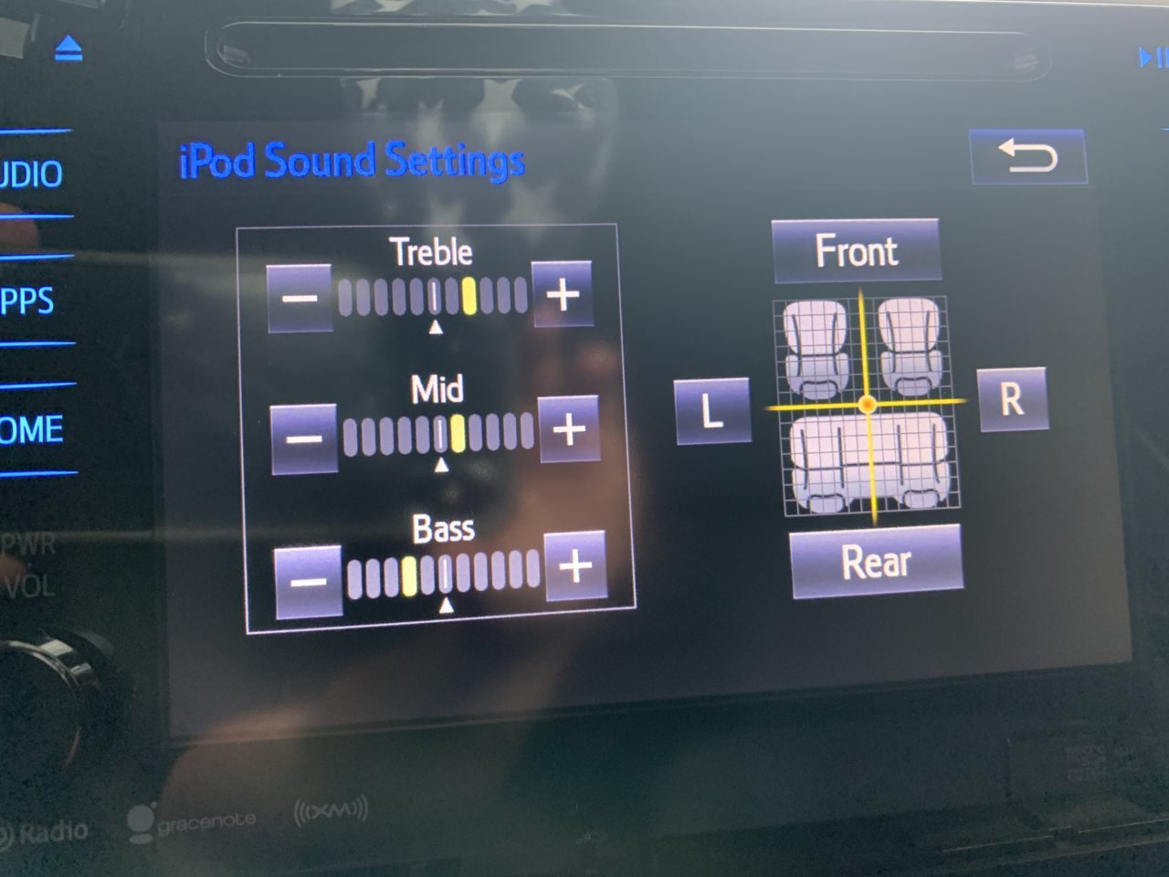

    So I fixed the harness and with the bass turned down I ran pink noise to re-adjust the gains on the key. Bass is what was making it clip before. Much louder and cleaner to match the subs. They were getting over taken.
    Left the RF amp gain at 5, 80Htz, and PunchEQ just below half. Maybe I’ll get bored and break out the multi meter one day to see what the output really is.
    For anyone wondering yeah it hits hard. For the $450’ish bucks I spent on the sub, amp, kit, and rack I built can’t beat it :thumbsup:

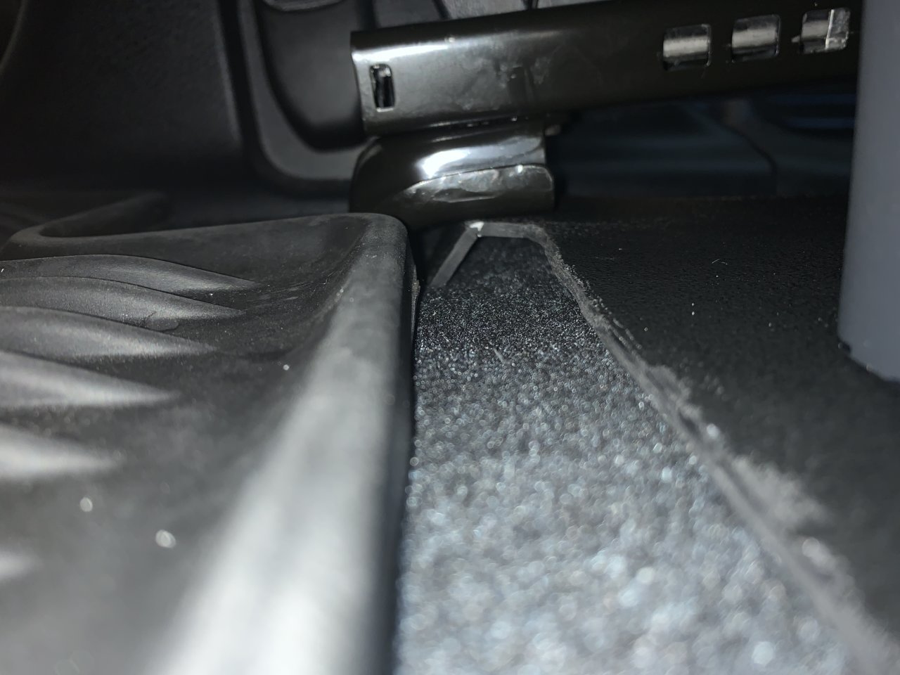

    Where did you get the spacers for your seat and is it a noticeable difference in height?
