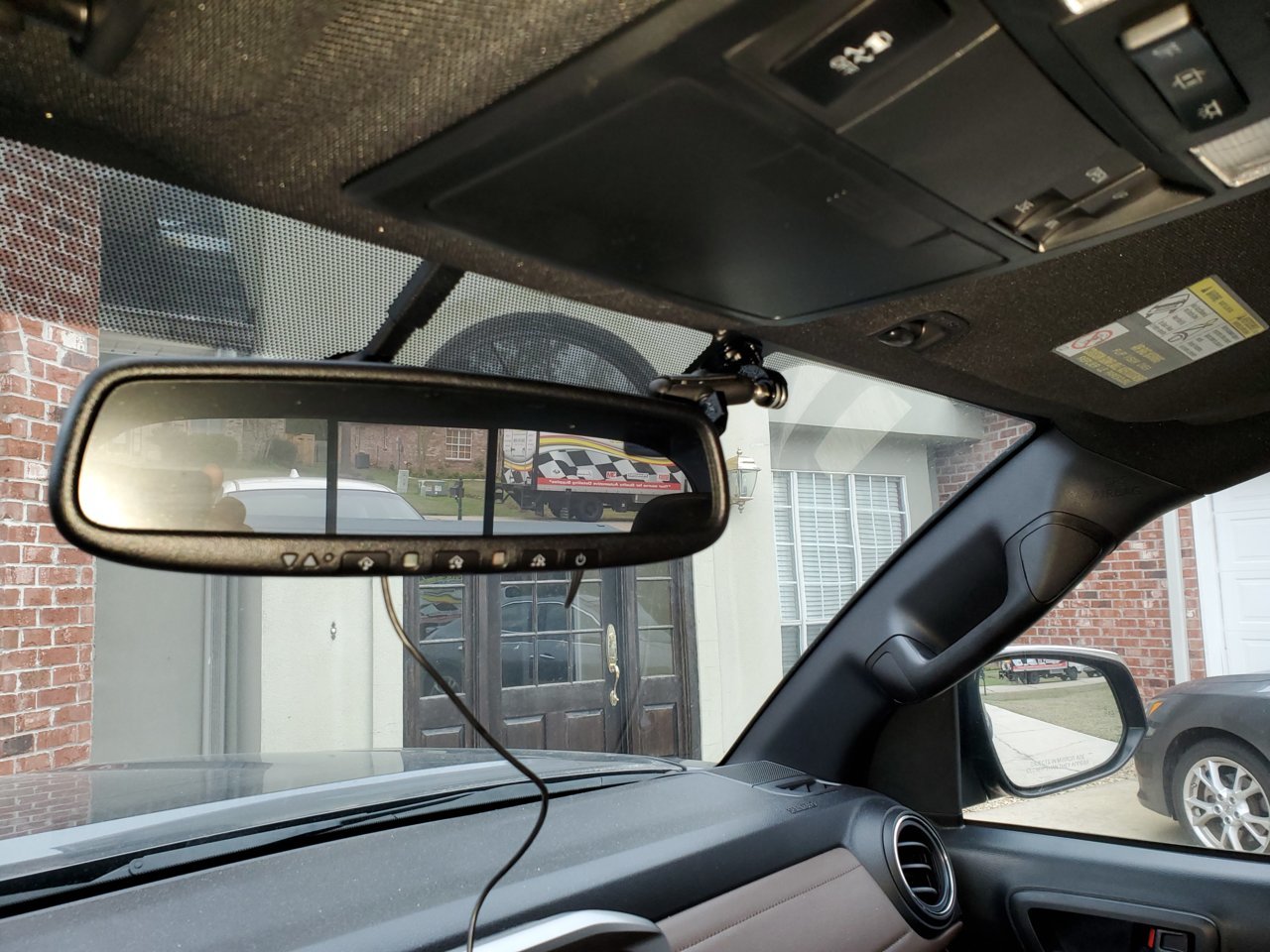

    Well I'm not quite there yet... still waiting on one part. But I have most of the rest of it assembled.
    I'll probably end up painting the bright parts black...

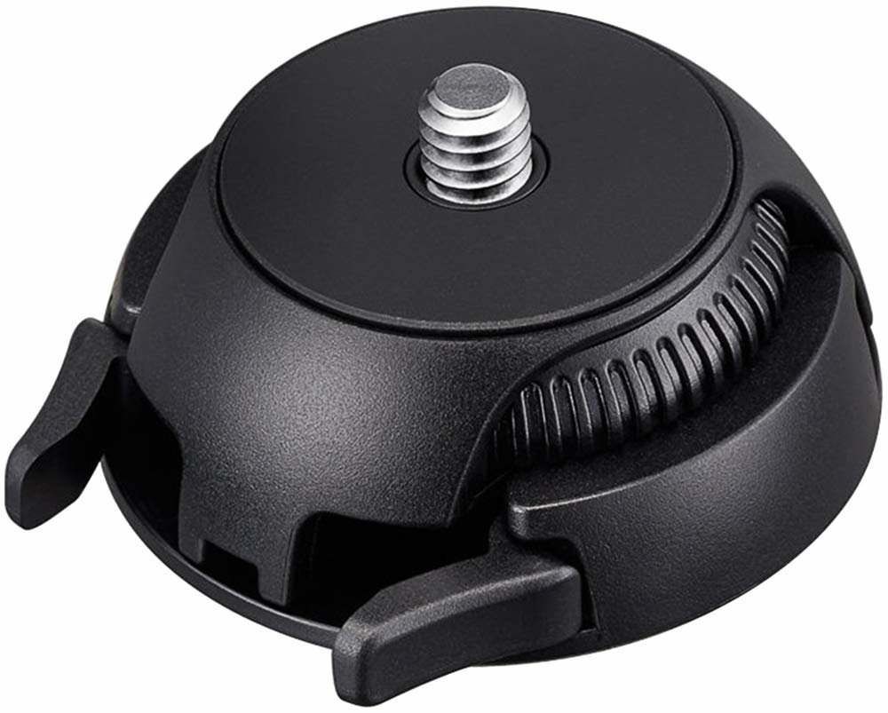

    And this is the part I'm still waiting for . . .
    EDIT: Forget about using the part below!!! The threaded part of it DOES NOT FIT the OEM mount in the Tacoma!
    "Plan-B" uses a different part, that I have confirmed will fit. See post #72 below.

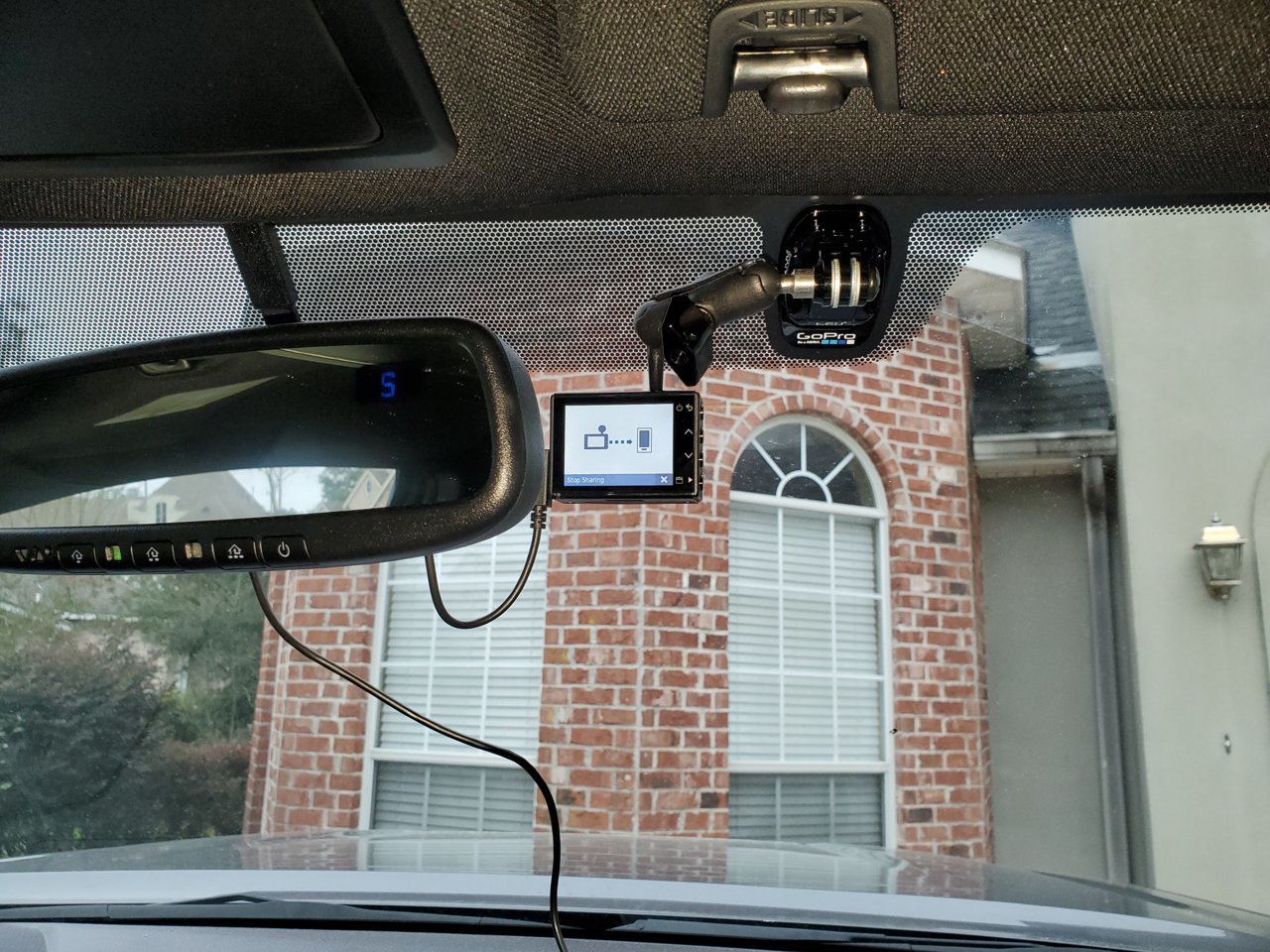

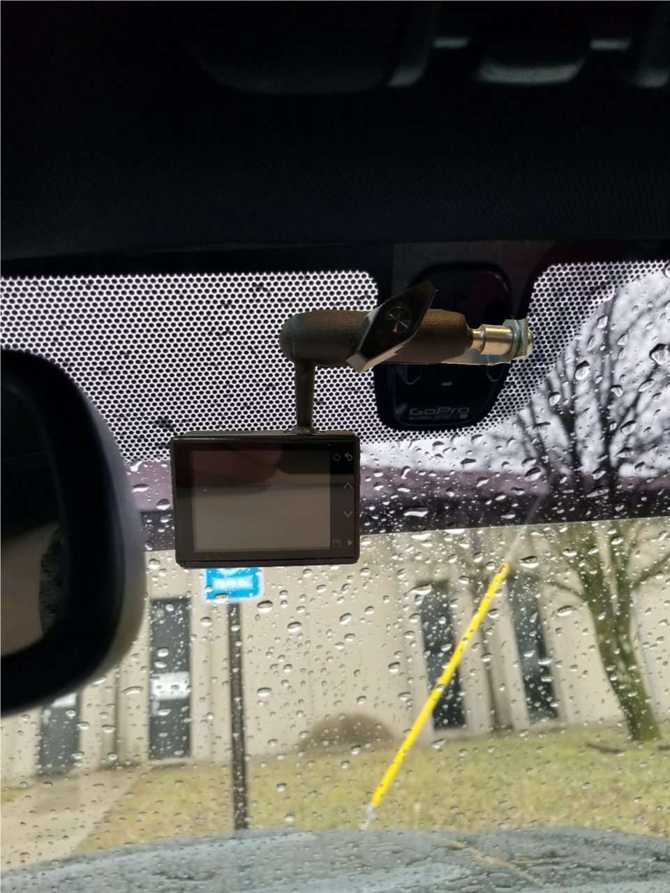

    EDIT: Newly available GoPro-to-Garmin mount shown in this post . . .

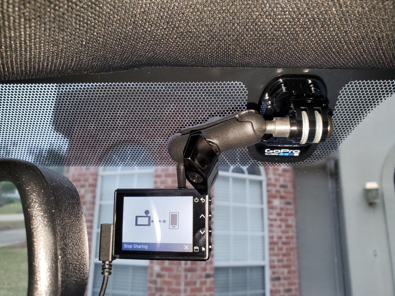

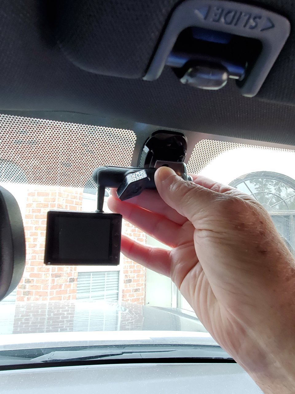

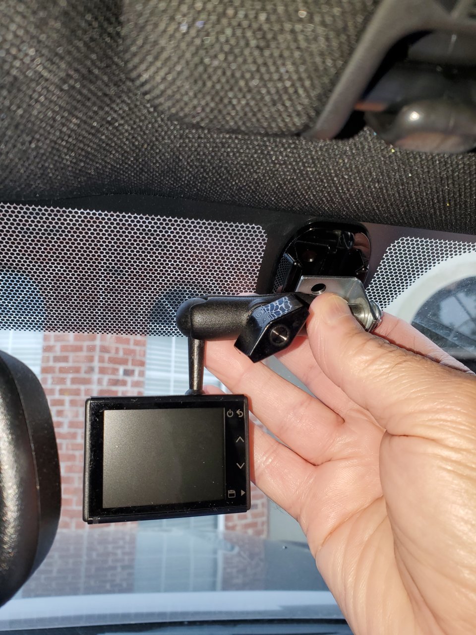

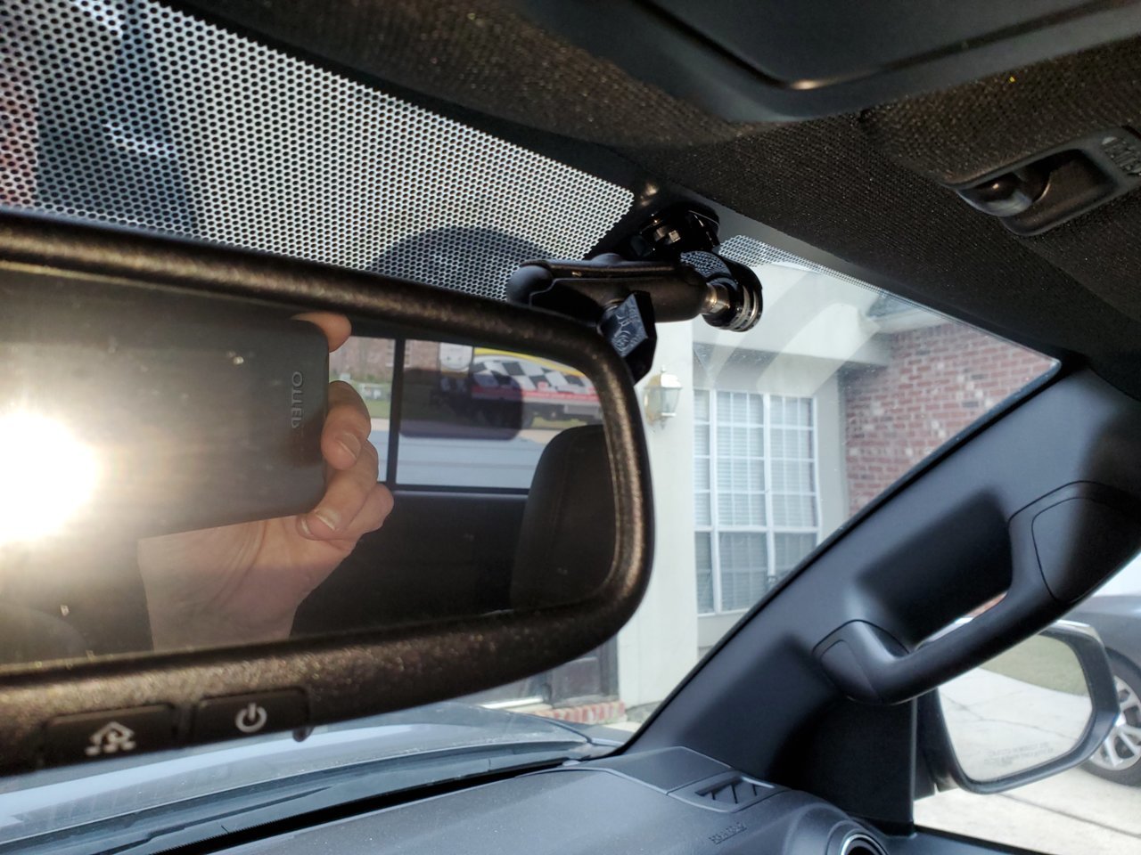

    As of this afternoon I finally have something that works. My SimpleUSB adapter won't come until tomorrow. See pics of mounting hardware below.
    Almost everything is out of the field of view of the driver, and the little bit the driver can see is in front of the darkened portion of the windshield anyway.
    If anybody wants more details, just ask...
    View from Passenger Seat
    Closeup View
    View from Driver Seat

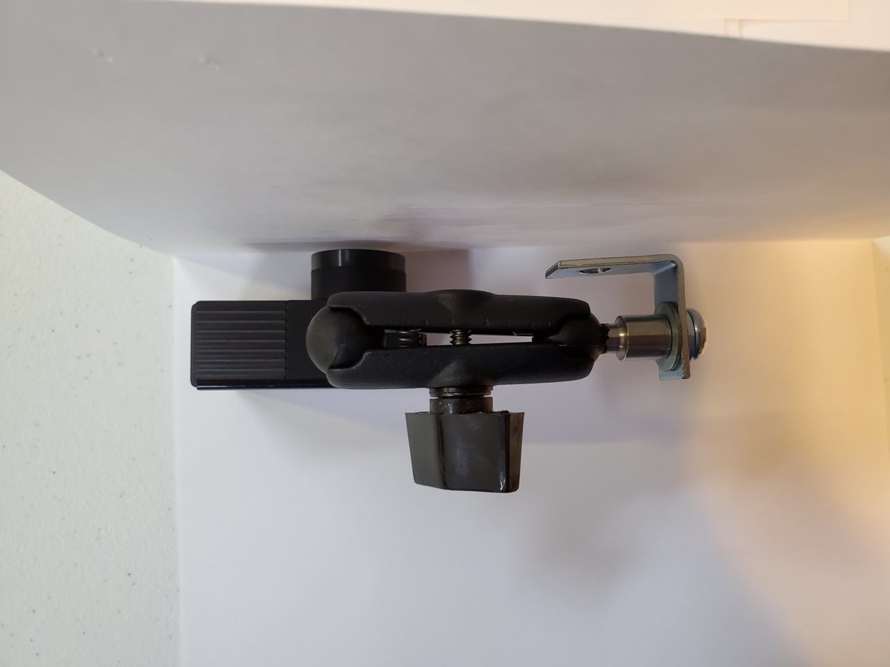

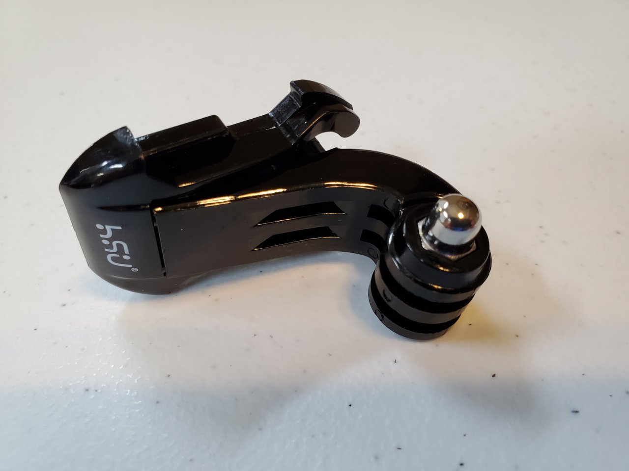

    That was on this piece . . .
    I drilled the existing hole all the way through to upsize it to 1/4" diameter, to accommodate the 1/4-20 machine screw.
    I also shallow-drilled just the side facing toward the driver to 3/8" to recess the ball-mount into it.
    I removed the chrome nut that's shown in this picture, and then used a 3/8" drill to round-out the hex shaped indentation where the nut had been. I didn't drill completely through the plastic finger,
    but just enough to make a clean seat for the 1/4-20 RAM Mount Ball. So I drilled away maybe 3/32" to 1/8" of plastic.... what I called "shallow". Effectively removing all of the hex indentation.
    I did all of the drilling on a drill press, making it easier and more accurate than a hand drill.
