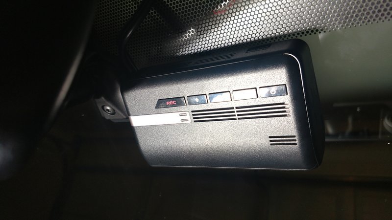

    So I have my Thinkware F770 and add a circuits, just waiting until the weekend to install it. The documentation in the boxes is horrible, so I downloaded the manual and I'm reading through it. One of the first things I look for is the operating temperature, and it's 140 F. Maximum storage temp is 158. I'm sure it gets hotter than 158 inside of our vehicles in the summer here in Phoenix. My truck is garaged most of the time, but sometimes it has to be in the sun. Anyone in Phoenix have any issues with theirs in the heat?

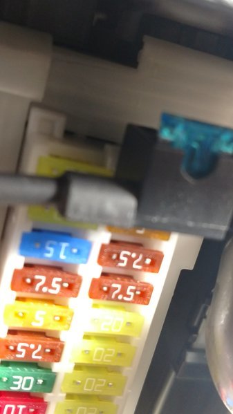

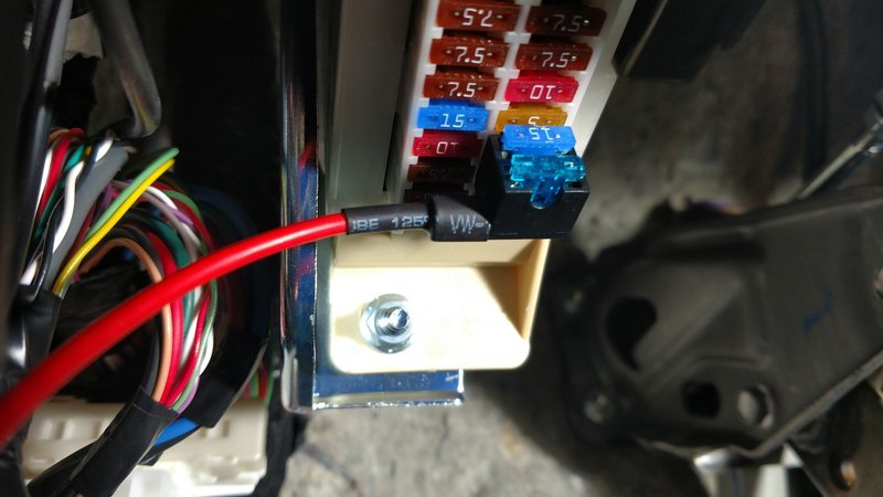

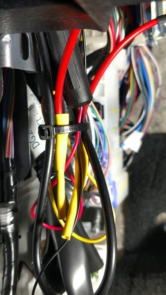

    I installed it this weekend. I hope I did it right, it was my first time with add a circuits. I did Yellow to the empty slot, (last one on the left) and red to the 3rd down on the left, the 15 amp labeled P/Outlet 1. I soldered and put heat shrink on instead of crimping. I tested continuous and parking mode and it all works.

    Looks good, @Jeffaz1! Photos display fine in my browser here. Yeah, their documentation leaves a bit to be desired. :) It also doesn't help that Thinkware seems to be semi-random as to whether red goes to ACC and yellow to +12VDC or vice-versa. At least they label the wires, so you're okay if you pay attention. One thing to note is it seems the ACC is used just for signalling and the camera draws power from the +12VDC. This means selection of the ACC input is a little more flexible.

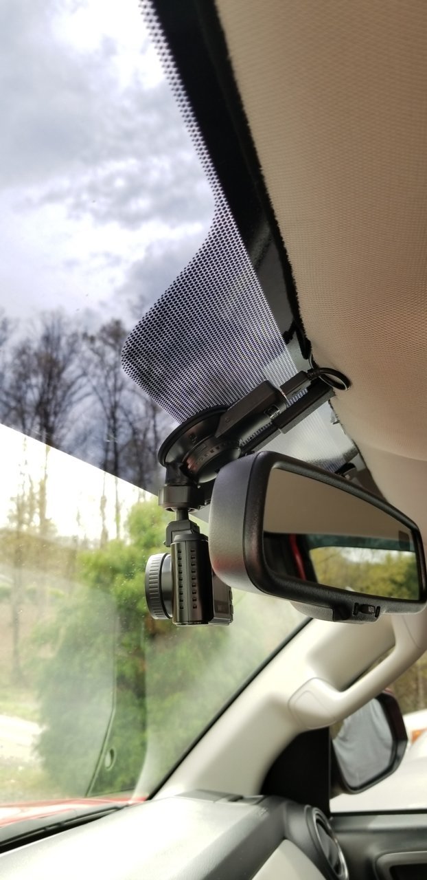

    I have a Vantrue N1 Pro Mini. It was a Black Friday impulse purchase and I bought it mostly because it was really cheap. I had flirted with the idea of having a dashcam, but hadn't given it any serious consideration.
    I've been really happy with it. It's fairly small, and has good video quality. I only have it set to come on with the ignition, but it has options for park mode with motion and collision detection. I hardwired it and ran the cable under the A-pillar, which as others have said is quite easy to do. Fits nicely in front of the rearview mirror.
