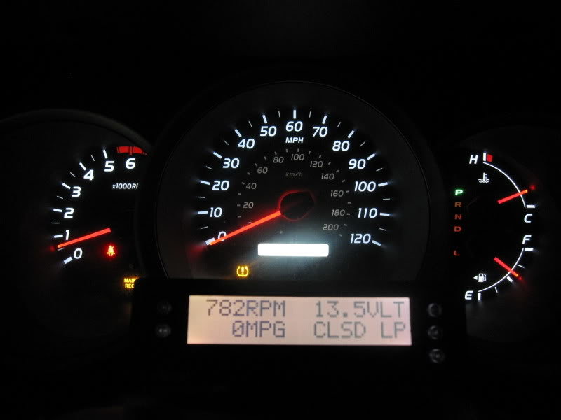

    Whats that 782 RPM and 0 MPG thing ya got goin on?
  11. Nov 8, 2012 at 9:34 PM
    #371
    Jon850FL
    Jon850FL is Lurkin'
    Aug 1, 2011
    #60972
    2,390
    Jon
    DFS, FL
    scangauge.
