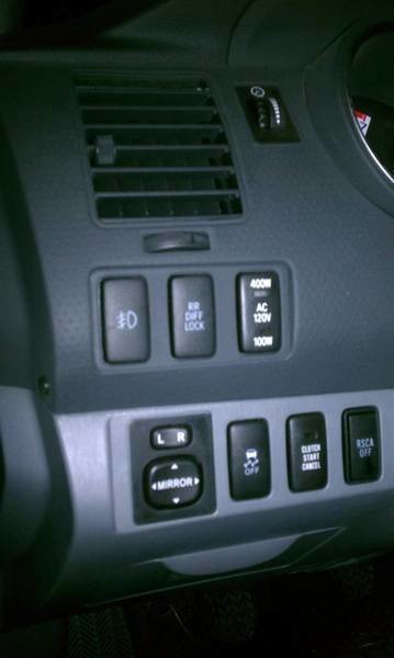

    I just bought a 2005 Tacoma trd o/r and noticed when I drive at night none of the push button switches to the left of the steering wheel light up. Is this normal or are they supposed to light up? I cant imagine all of the bulbs are bad
    fog switch
    clutch start cancel
    r diff lock
    AC power
    this isn't my image but these are basically what I'm referring todashboard1.jpg

    The fog and RR diff lock are supposed to light up when the dash lights come on. The inverter only lights up when used. Cant speak to the bottom three as I don't have them and your mirror switch doesn't light up. Pop the switches out of the dash and there's tiny little light bulbs that twist into the sides of them. They are likely burned out. They were all burned out on my 08 when I got it last year as well as the ones in my climate control. They are a pain to find anywhere but Toyota in my experience and are a couple bucks each from the dealer. Call ahead as they don't usually keep them in stock and will have to special order them.

    I second the instructions above. I got the bulb from ELMORETRDTOYOTAPARTS.COM for $7.88 ($4.01 for the bulb and $3.52 for shipping and some tax) it was the cheapest I could find. Part number 90011-01058 Bulb W Cap.
