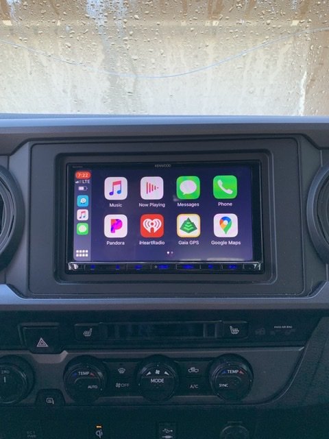

    One last question ? what dash kit did you use and does it sit flush like the oem head unit or is it sunk in like most of them. Got a picture ?
  14. May 15, 2020 at 9:01 PM
    cosmic65charlie
    cosmic65charlie Consumer of good times.
    Dec 17, 2018
    #276095
    467
    Colorado
    2019 TRD OR AC
    Offroad stuff, Audio stuff, Cooler full of beer
    I used the Metra kit. It does not sit totally flush. Ordered 3 different ones and the Metra looked the best. The finish is pretty nice too. I know a lot of people try to keep stock since it fills out the dash better but I don’t mind the look at all. After a few days I didn’t even notice. Will snap a pic tomorrow when it’s light out.

    Looks great ! Just ordered the same dash kit and a kenwood dmx907s. Should sound great when I'm done. Also got the idatlink maestro with harness and all the connectors to keep factory sat ,antenna and stuff
