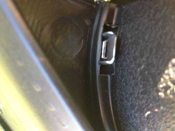

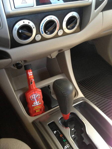

    Unscrew 10mm bolt by gas pedal
    Take out change container
    Take out lower plastic and stop once you hear its out.

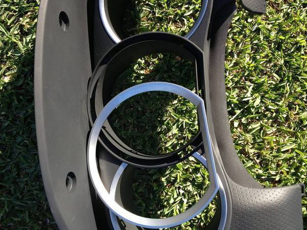

    Remove 2 screws in upper plastic, I didn't take pics, but they are just above the steering wheel.
    Pop out rings with a flat head screw driver, don't snap the rings!
    Finished product
