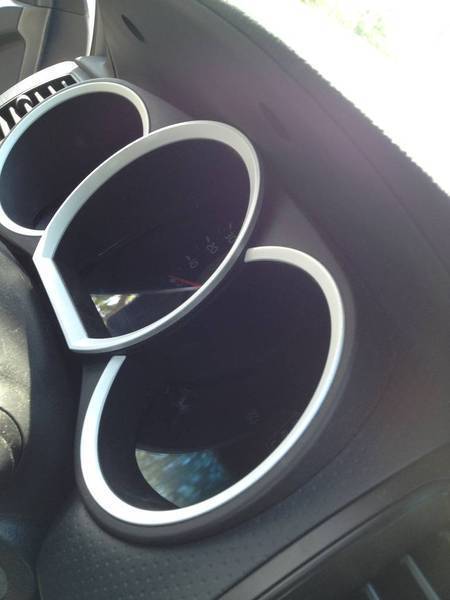

    I did mine in white, pics inbound

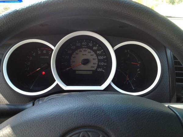

    Here is how mine turned out. It took maybe an hour including the time for letting the paint dry between coats.

    What'd you guys do for prepping them to paint? I'm redoing mine soon, they didn't hold up as well as I'd hoped. Hard to tell if that is metal or plastic.

    They are plastic, I sanded them out and then used fusion primer then a flat black for mine.

    It is plastic, I did nothing to prep, I just went down to autozone and got paint that's sticks to plastic. I forgot the brand name, or else I would give it. Just ask at autozone

    I lightly sanded it and then baked it for about 15 minutes after I painted it.

    Nice!!!! Looks great!

    Baked before painting? Why for? open up the pores of the plastic?

    No, Painted and then baked. Helps the paint cure.

    I also did mine cant figure out how to post a pic from me phone but I prepped mine as if I was painting my grill because I wanted to see how close I could get the paint to match my impulse red.. It patched perfect with duplicolor paint so next project is getting rid of that ugly chrome grill

    You can use the sun too if its out, rotate them into the sun and then shade I do it 3 rotations and it dries really solid
