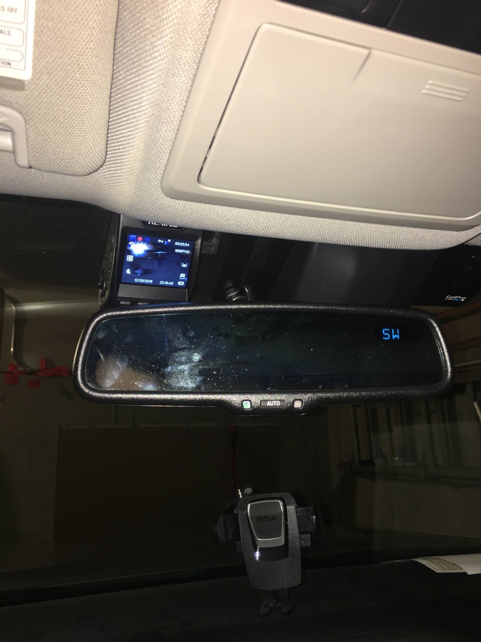

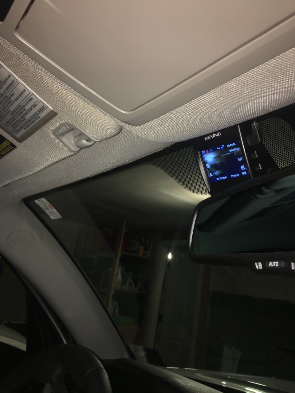

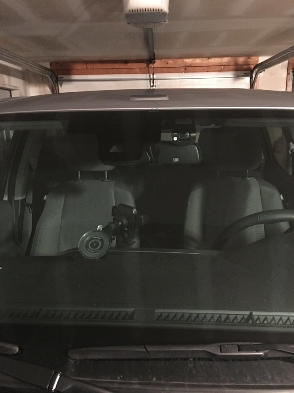

    how did you mount the shapeways to your windshield?

    ok so tell me about the rear view mirror? nice job btw

    It clips into the OEM GoPro mount.
