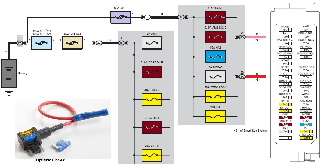

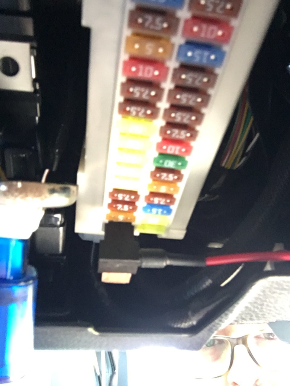

    others will tell to to "splice" into a power wire....however, you can use a "add-a-fuse" and route it to the engine bay fuse box...attache to the INJ 1 fuse or the ENG 1 fuss....both are red 10a fuses....if you don't want to go there, go to the cabin fuse box.....there is a 15a fuse , 3rd down on left......all of them will have power when the engine is turned on and goes off when engine is turned off.....

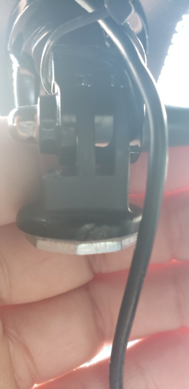

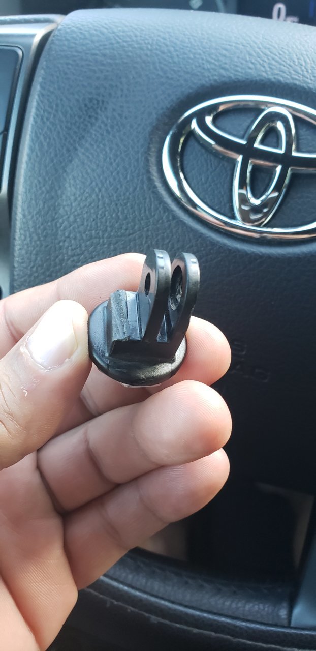

    I use a Gopro adapter, the one with the 3 prongs. I ended up cutting one of the prongs so it could fit in the Tacoma Gopro mount.
    I then glued the magnet that came with the Garmin 45 to the mount.
    But I might change the location of the Dash cam to the drivers side of rearview mirror. Easier to access the dashcam's menu instead of leaning to the passenger's side to setup the camera.

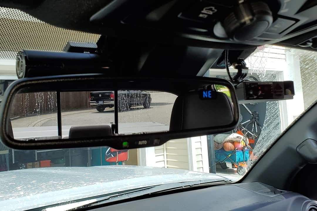

    Integrated my V1 and dashcam harness. Zero splice/wire tapping. 2 pins insert into the back of the mirror switched power and ground wires

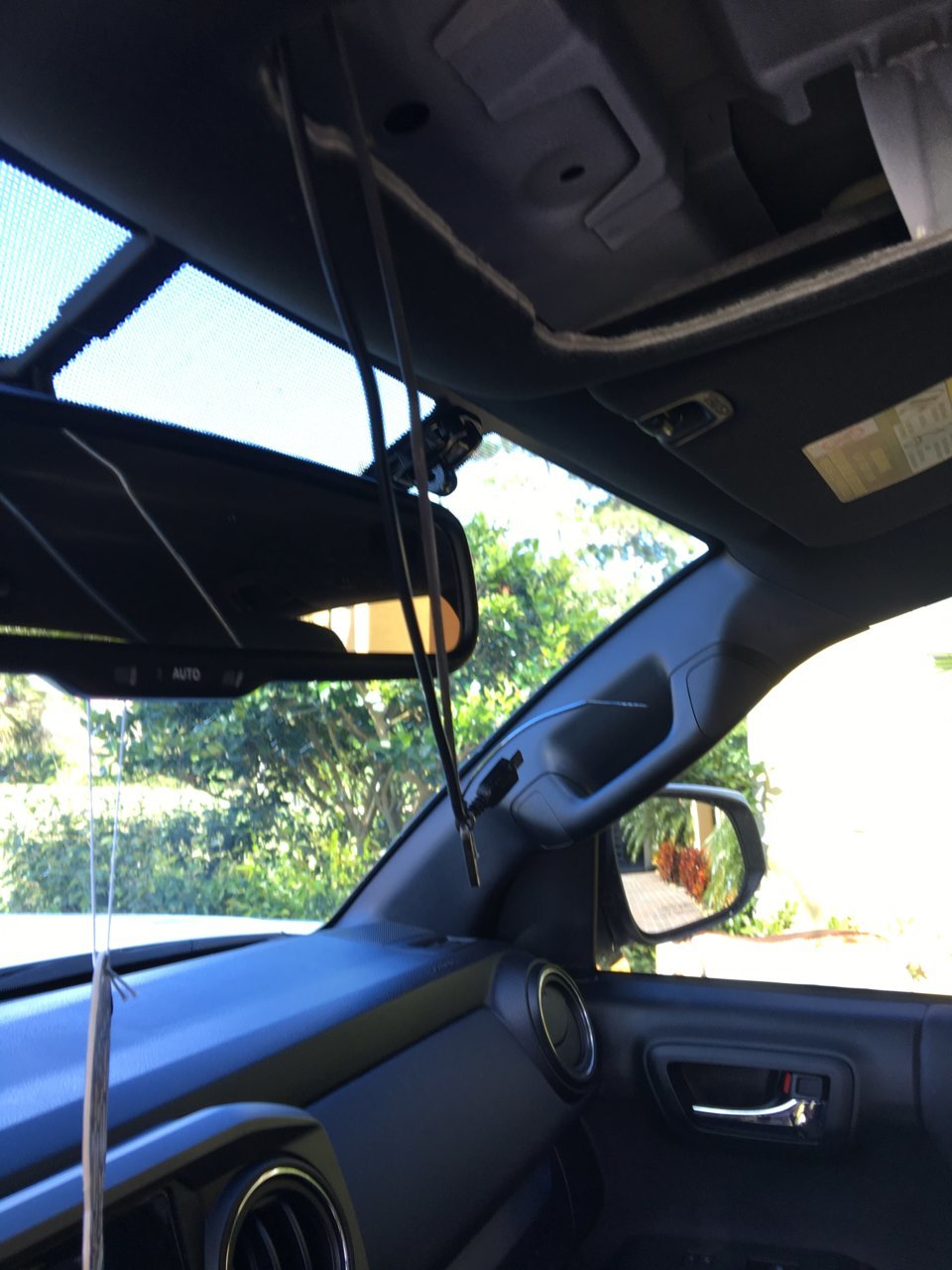

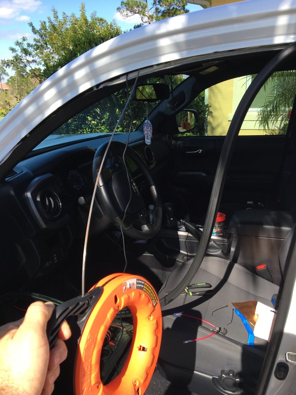

    I too tapped into my fuse box with an add a line... I pulled the driver door weatherstripping back and ran the wire up along the front of the door jam. I then used a fish tape and ran the wire across the top of the headliner across to the center console area. Popped it out (4 screws) and then finished my camera install. No pulling the A pillar cover or pushing the wire into the front of the headliner.
    Just glad to see so many Taco owners using dash cams.

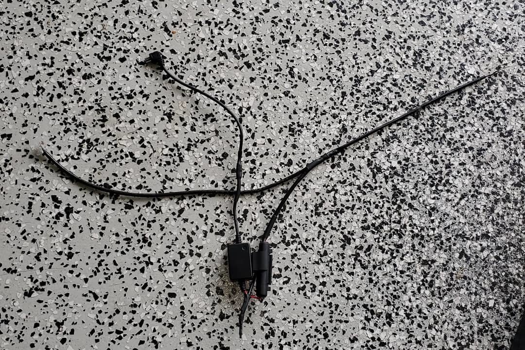

    [​IMG]IMG_4531 by Mike M, on Flickr
    This is my solution. Please disregard the potato quality shot.
    The camera is an Aukey DR-01. It's a bit chunkier than some, but had decent reviews and I find the video quality to be more than sufficient. The box to the right is part of the Aukey hardwire kit. It's the motion sensor feature. The neat thing is that the camera receives power via the OBDII port. The motion sensitivity is quite good, I can hear it turn on when I walk into the garage from my house. I've had rainstorms trigger it as well. The beauty is that it's a true no-cut solution, no add-a-fuse or anything. I purchased an OBDII splitter and am still able to run my ScanGauge as well. The only downfall is that anytime the OBDII port is accessed, you lose the camera. It shouldn't be an issue for most services as far as capturing anything inappropriate the dealer does, but there is that problem. I took the truck for a state inspection today and when they brought it back out everything was unplugged. I expected them to unplug it so they can put their reader on the machine, but I'm disappointed that they didn't reinstall, but that's small potatoes all things considered.

    Window tint (15% sides, 5% rear) Bull bar Bed mat (modified horse stall mat) 265/75 Falken Wildpeaks Hondo Garage radio knobs Better Built slimline toolbox LED replacements for interiors, reverse, and license plate Derped the stock steelies Tinted tail lights and third brake light Faux Pro Grille "Raptor Style" Lights 20" behind grill light bar 2" wheel spacers Cup holders and bottle opener in bed rail Custom bedside stickers and tailgate letters (CBoy808)
    So I just purchased a Thinkware FA200 with the front and rear cameras. I would like to use the GoPro mount up front but I’m not sure what to use as I have zero experience with GoPro or their mounts. How did you modify your mount to fit into the GoPro?
