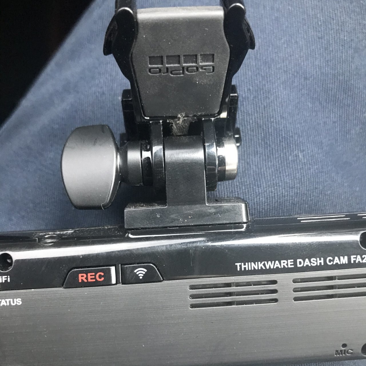

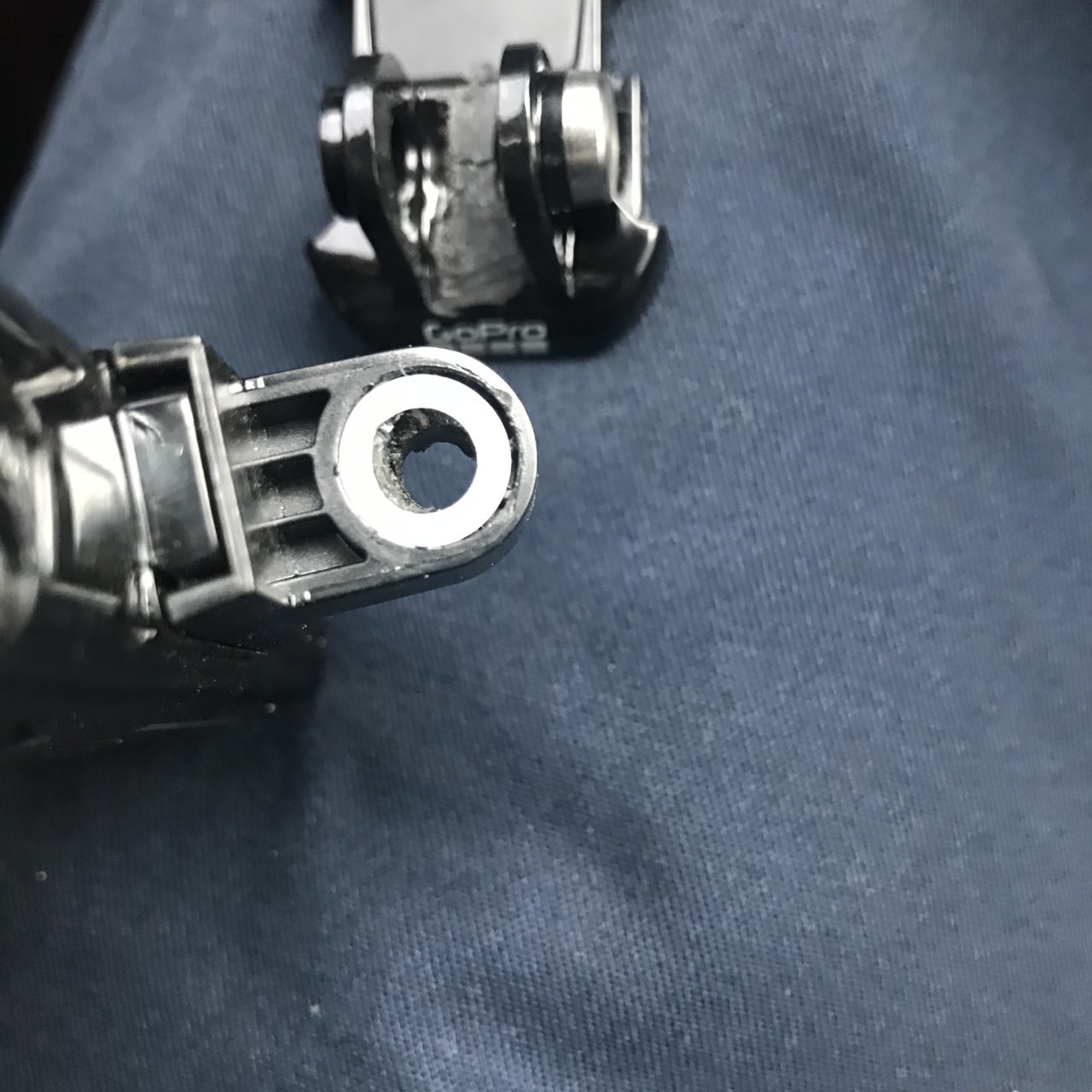

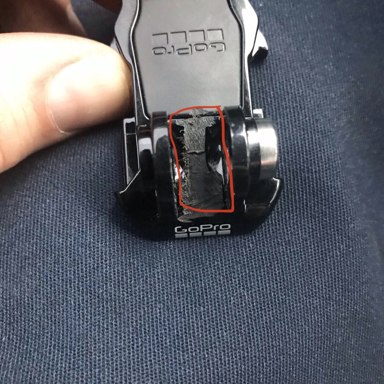

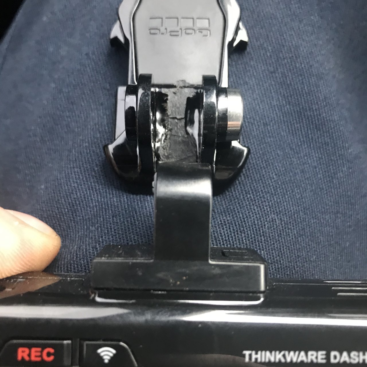

    If I remember I’ll grab some pics in the morning. I basically modified the mount that came with the camera so that it would fit into one of the GoPro mounting pieces. It was a bit of a pain but it worked and it’s sturdy. I just purchased one of those GoPro mounting kits from Walmart for like $15 so I had multiple options for mounting parts and quick releases. Below is a link to the kit I purchased but I picked it up locally not at this site.

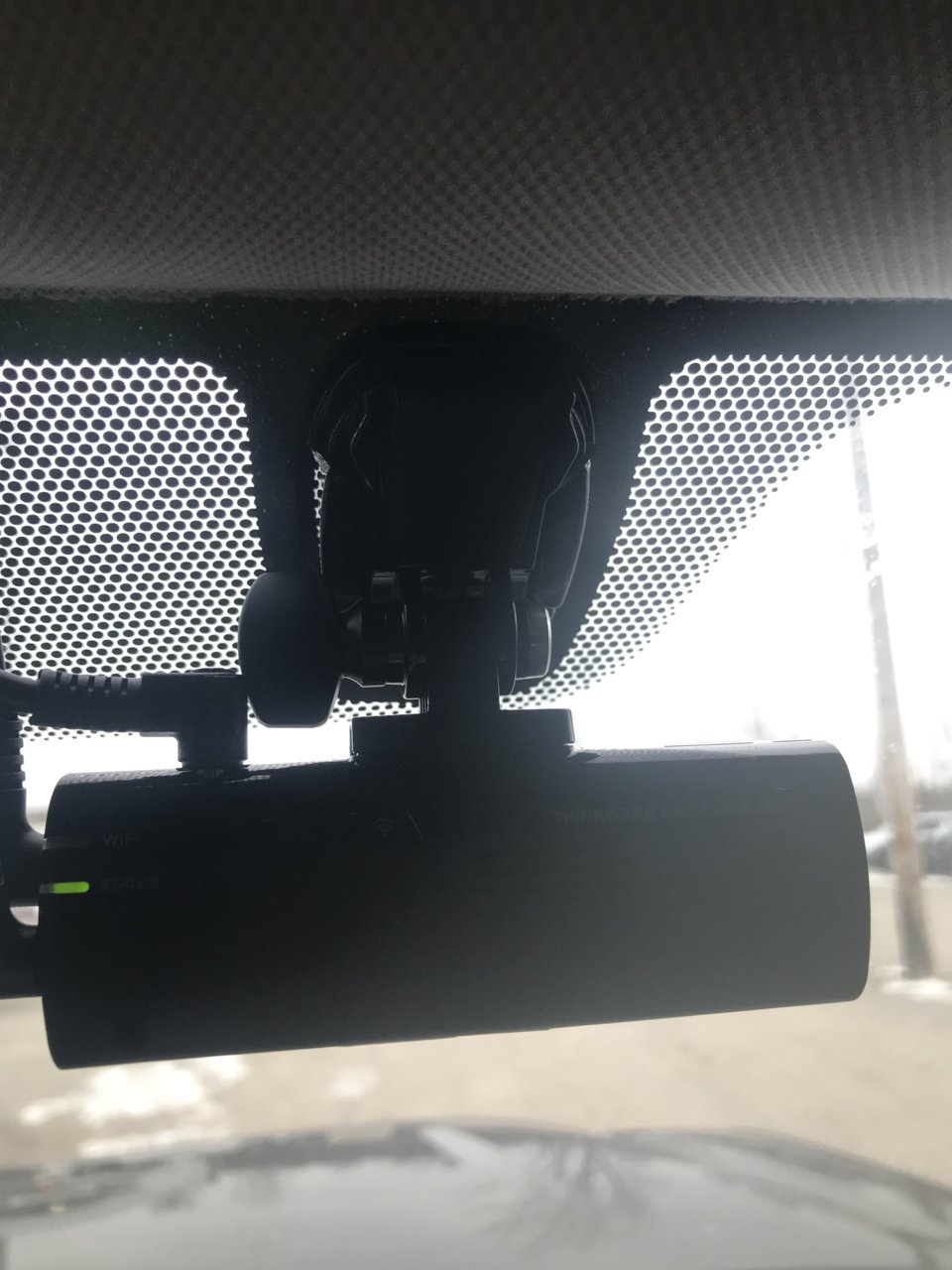

    Here are the pictures I took. You can see the middle section of the quick mount that I crudely cut out with a dremel. It gets covered up by the dash cam mount anyway and I was out of patience. Depending on what you have to mount this could work. I had to drill out the hole a little on the dash cam mount so the screw could go through too. I used the turn screw and quick mount from the GoPro kit and mounted it up. It’s worked out well for my application and doesn’t vibrate around so I get a nice clear video. With the sun I couldn’t get as clear of a picture as desired of it mounted but you can see how it sits. Let me know if you have any questions and I’ll help if I can.

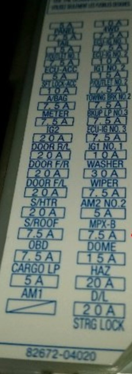

    I have a vantrue n1 pro that I'm using connected to the same location under the AM1. I know very little about these fuses so I just quickly threw in the spare red 10 amp fuse into the empty slot in conjunction with the already supplied orange 5 amp fuse. I was wondering if that 10 amp is fine as it is or should I use a higher or lower amp fuse. Specs of the vantrue hardwire kit

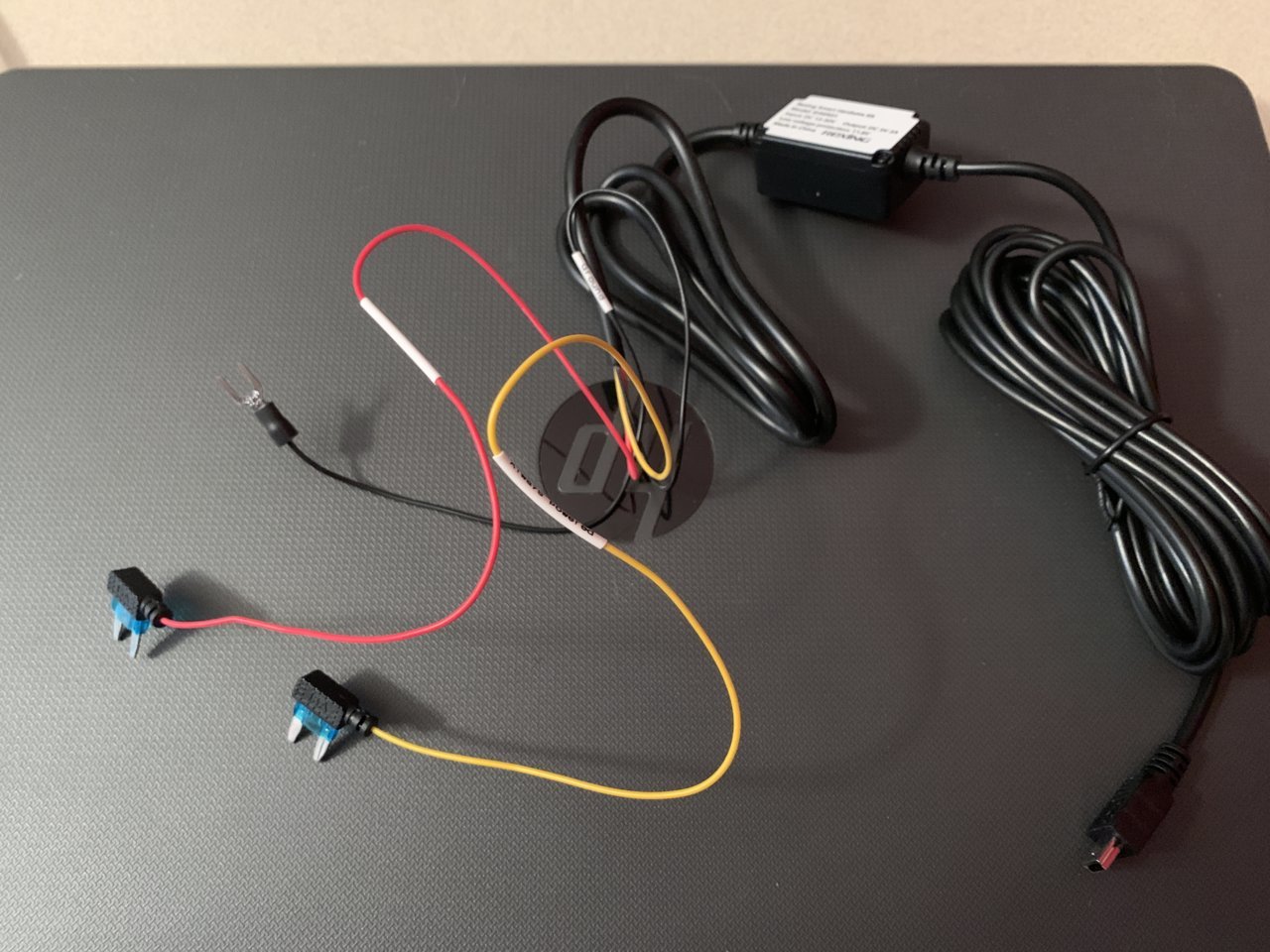

    Ok so I have a question. I got the Rexing V1 4K with parking mode for Christmas. Not sure I want to use parking mode since right now I don’t drive a lot with being in school. I got the Rexing install kit as seen in the picture. The red wire is labeled as Alway on, Yellow as Car On/Off and the black as ground. I know I have to change out to a low profile mini fuse, but what do I do with the fuse option (red) that I don’t want to use right away? For example... I want to have the dash cam on only when the truck is running and later down the road convert to using the parking mode.

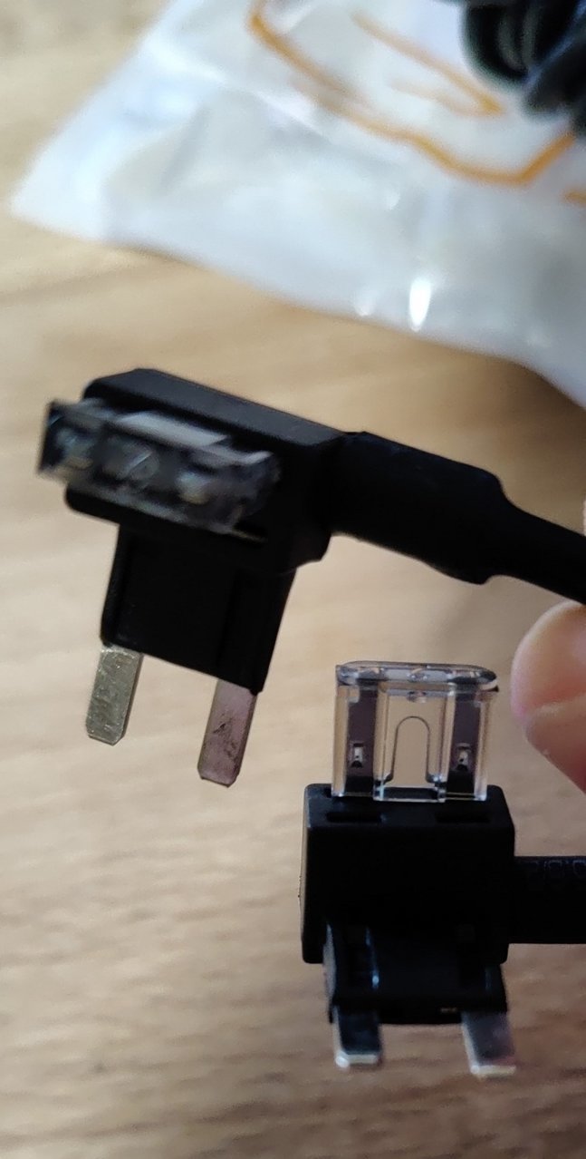

    Got my Rexing Smart Hardwire Kit from Amazon today. Mine already has the mini plugs and as the picture shows, the fuses are added on the end. So can replace them easily. Installing my Rexing V1P Max next week.

    Which always on fuse is recommended for the 3rd gen? And which ignition fuse is recommended?
