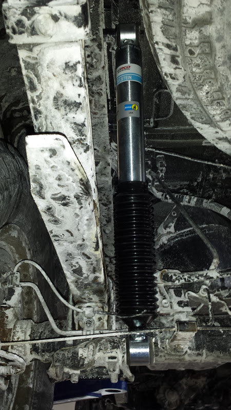

    • Lift- ToyTec Ultimate 95-04 Toyota Tacoma lift with Bilstein shocks with 2” rear shackals : http://bilsteinlifts.com/shop/95-04-toyota-tacoma/ultimate-toyota-tacoma-lift-with-bilstein-shocks/

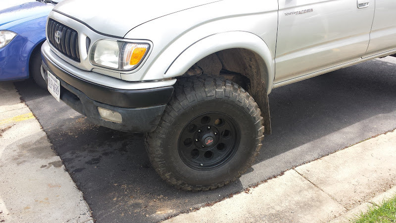

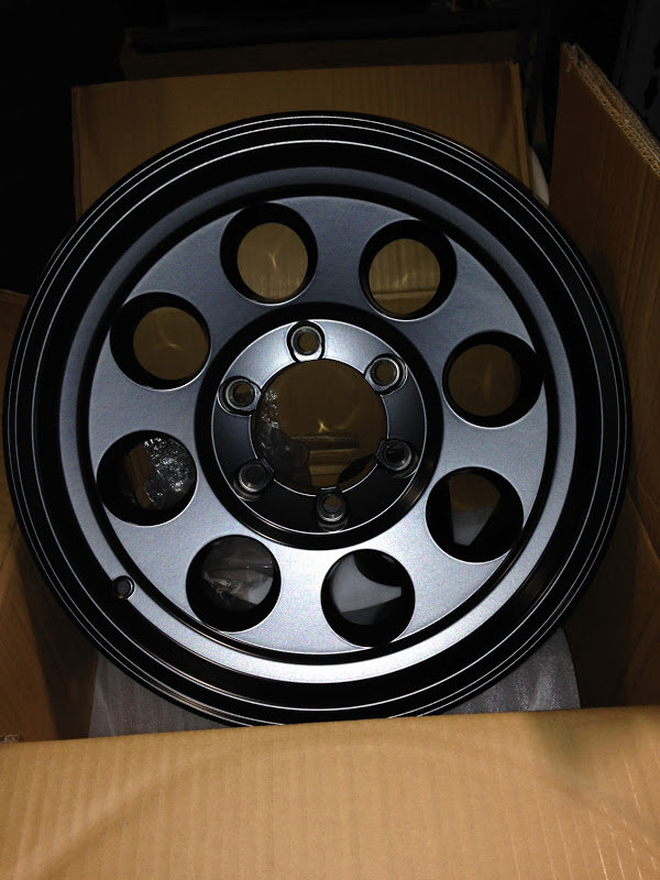

    • Wheels- Level 8 Tracker alloys, black, 16X8 -12 offset 4” backspacing 6x5.5 lug pattern : http://www.level8wheels.com/wheels/tracker

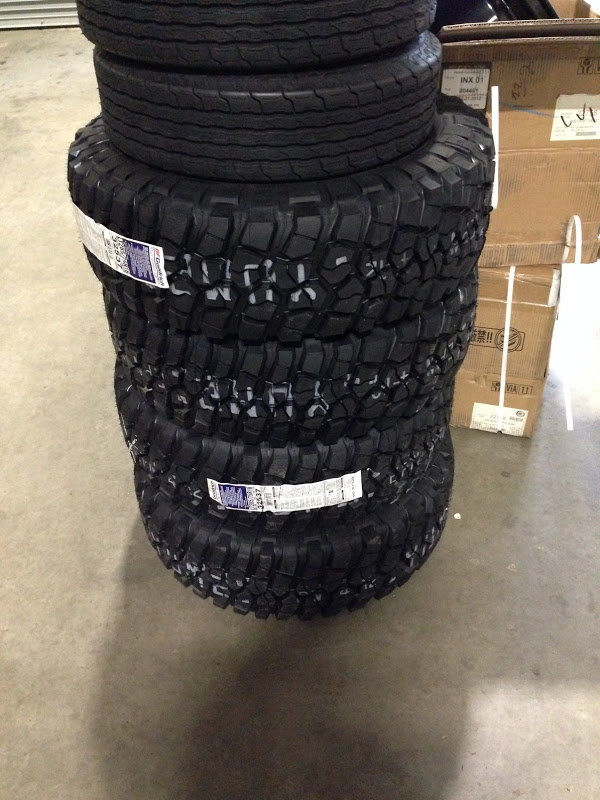

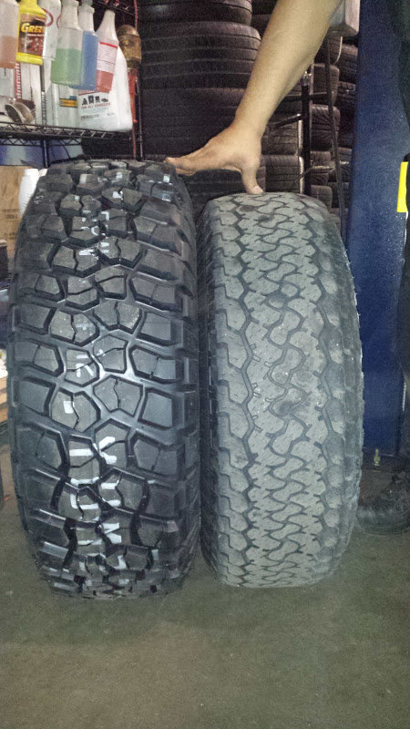

    • Tires- BFGoodrich Mud terrains 285/75R16 (32.8X11.2)

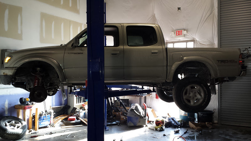

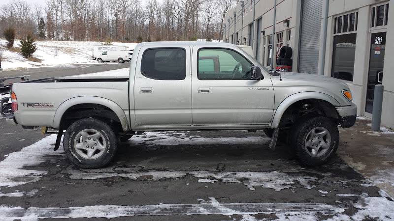

    Time for a Lift!

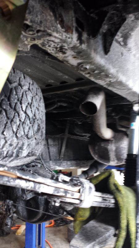

    Forgive the Pics, I should have washed the salt off the undercarriage, this was right after a huge snow storm and in VA they cover everything in salt.

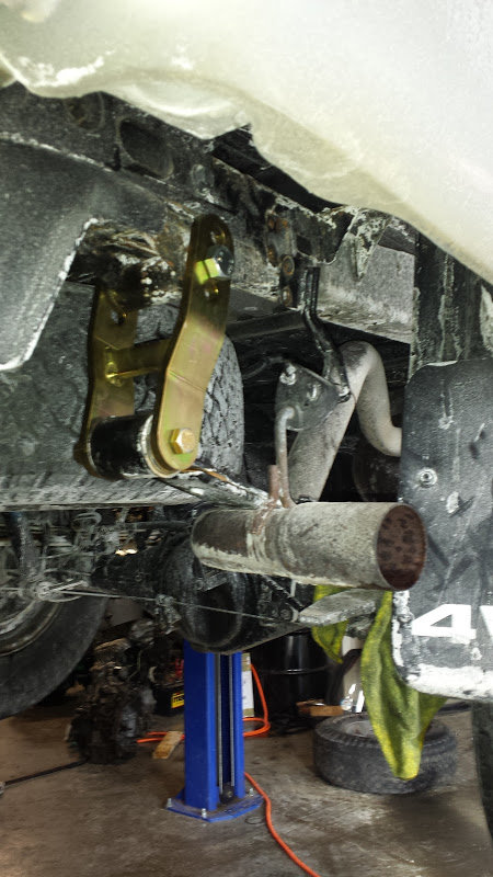

    I cut the exhaust pipe and will shorten it by 2" later so it hangs under the leaf spring.

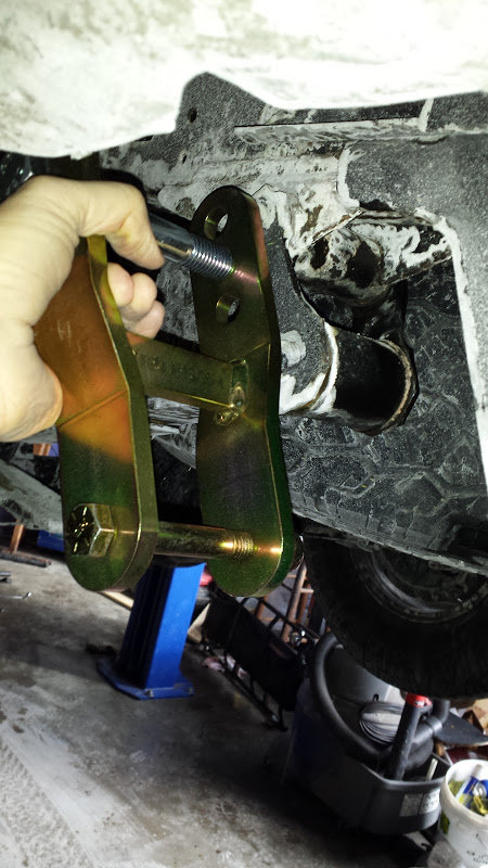

    Shinny new shackle!

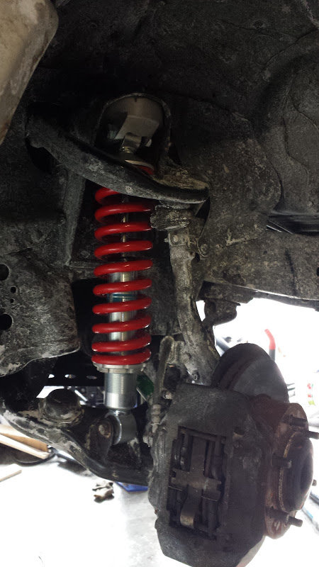

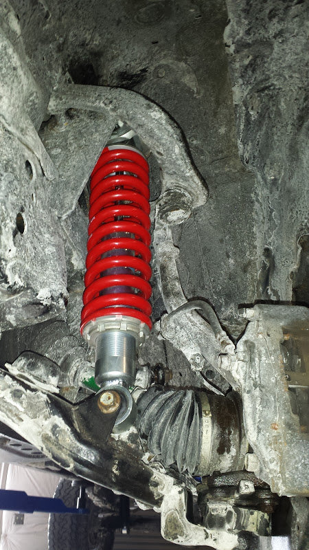

    Old and New Coil-overs.

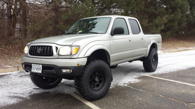

    This was the final product. Next up, Tires and Rims.

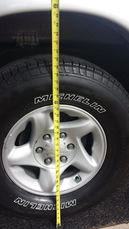

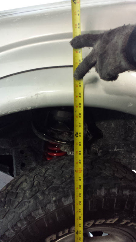

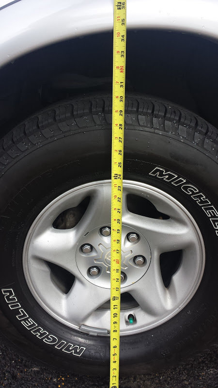

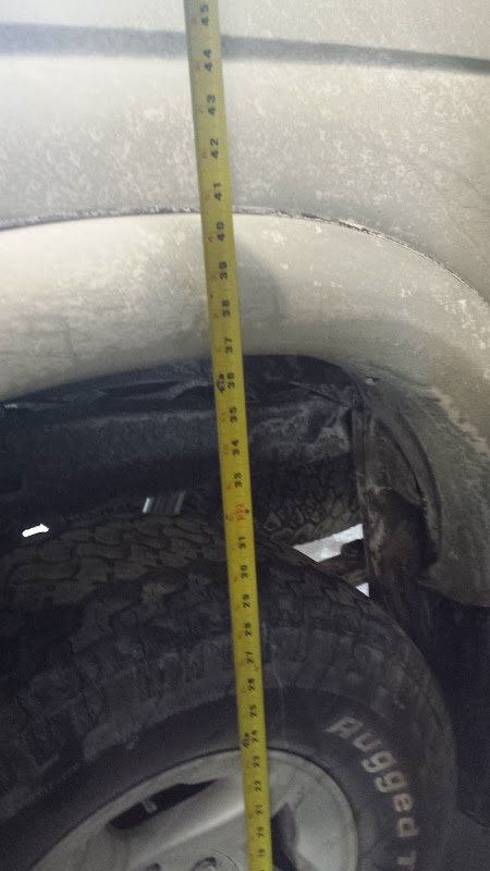

    Stock front from ground to wheel well:
    Stock rear:
    Post Lift front:
    Post lift rear:

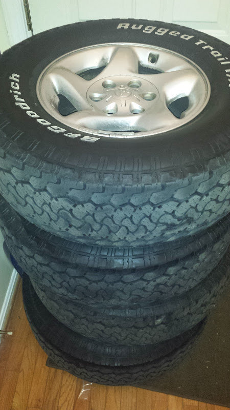

    Sold these for 250$:
    Bought these for a grand:(
    …along with these:

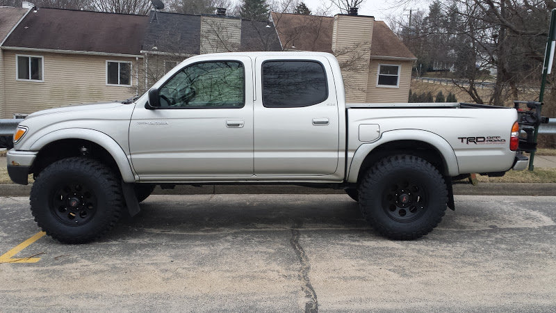

    YESSSSSSSSS!!!

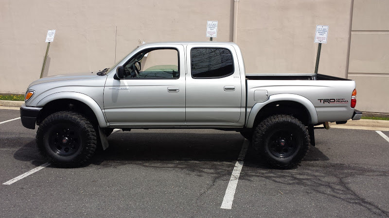

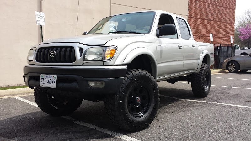

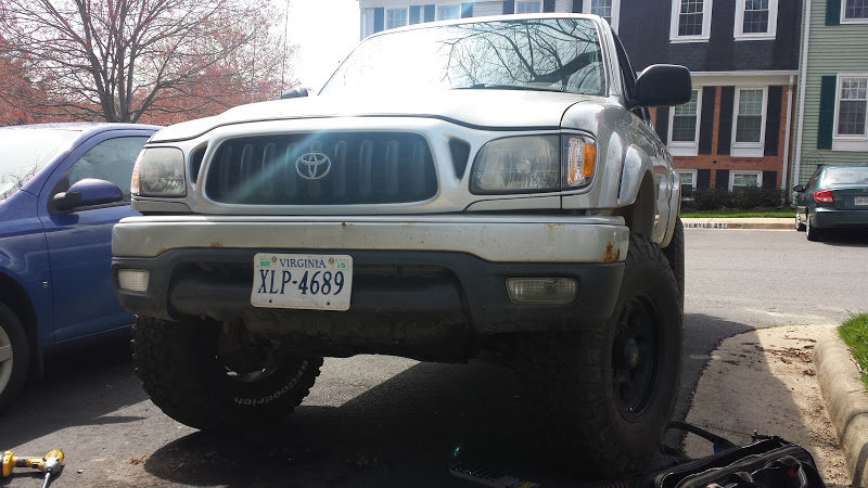

    WOW, what a difference!
    It's still a bit low in the back but just added 2" blocks in the rear and now she sits level. Took her out two days ago, what a blast… I can't believe the things this truck is capable of with very minimal mods!

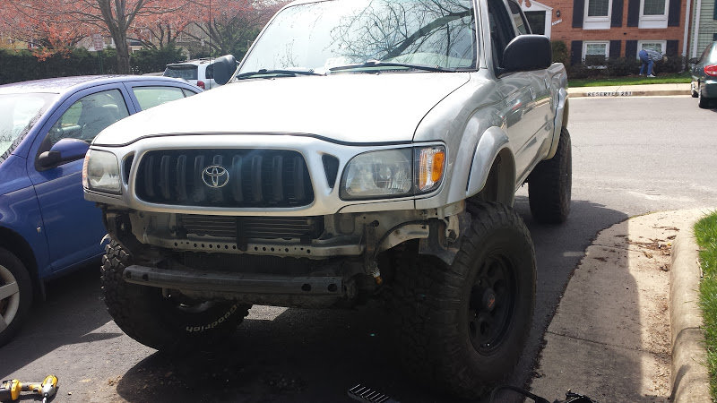

    The weather is finally warm! …and I had the day off, so I broke out some tools and got to work removing my rusty old front bumper.
    I Ordered the new bumper on Amazon for 60$. It came in black and shipping was free. Maybe I'll paint it later, I haven't decided if I like the black or not yet. I plan to replace it with a tube bumper and winch later in the summer, but for now I just couldn't stand looking at a rust hole in my truck:D 6 bolts later the bumper was off…
    Tadaaaaaaaaaaaah….

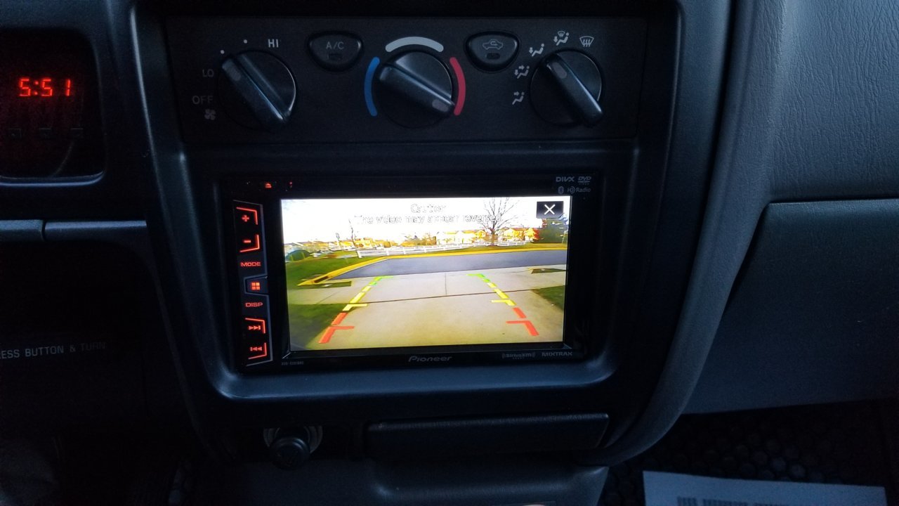

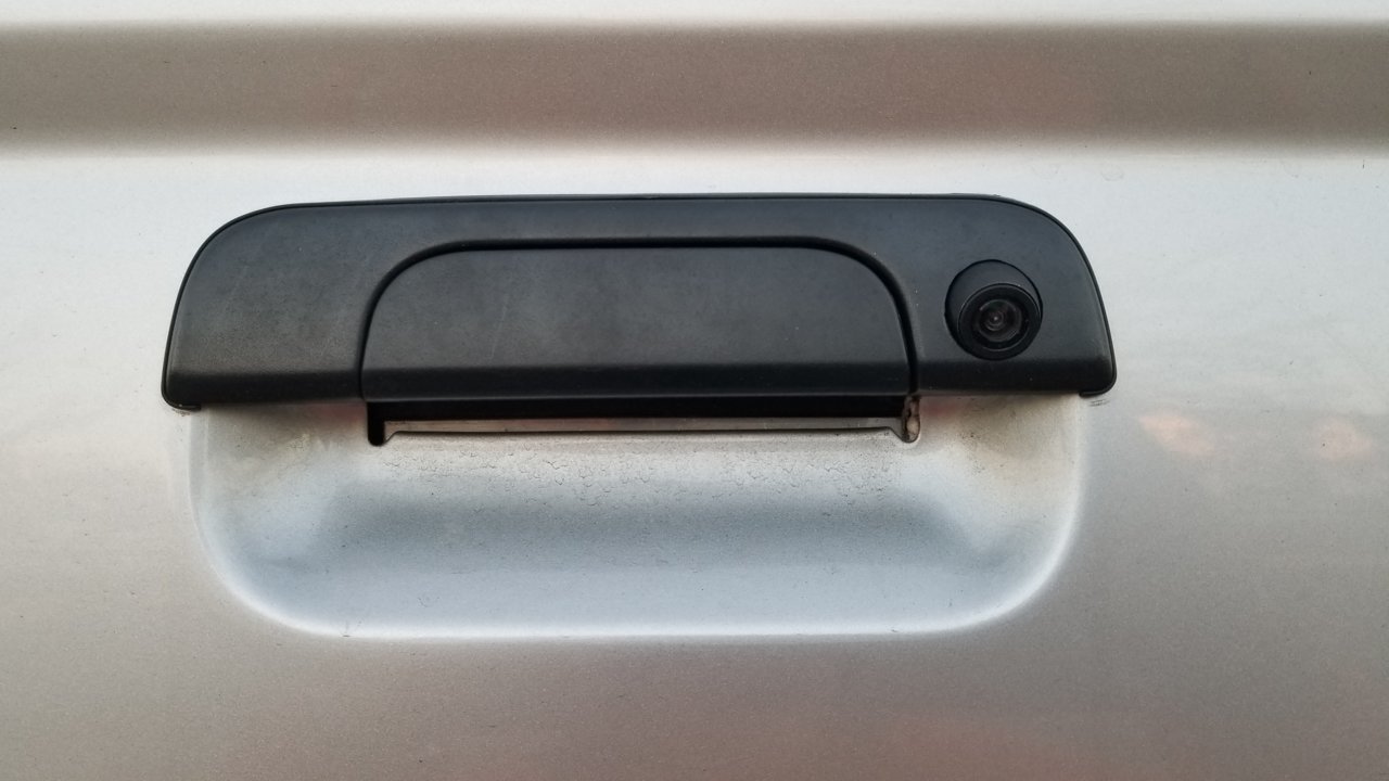

    Lets start with a new stereo! Pioneer 391BHS... this unit surprised me. For $250 it's amazing what it can do. Also got a rear view cam (Finally!!!) for 20$ on Amazon and mounted that in the rear gate handle. It turned out well, but it took some rigging...

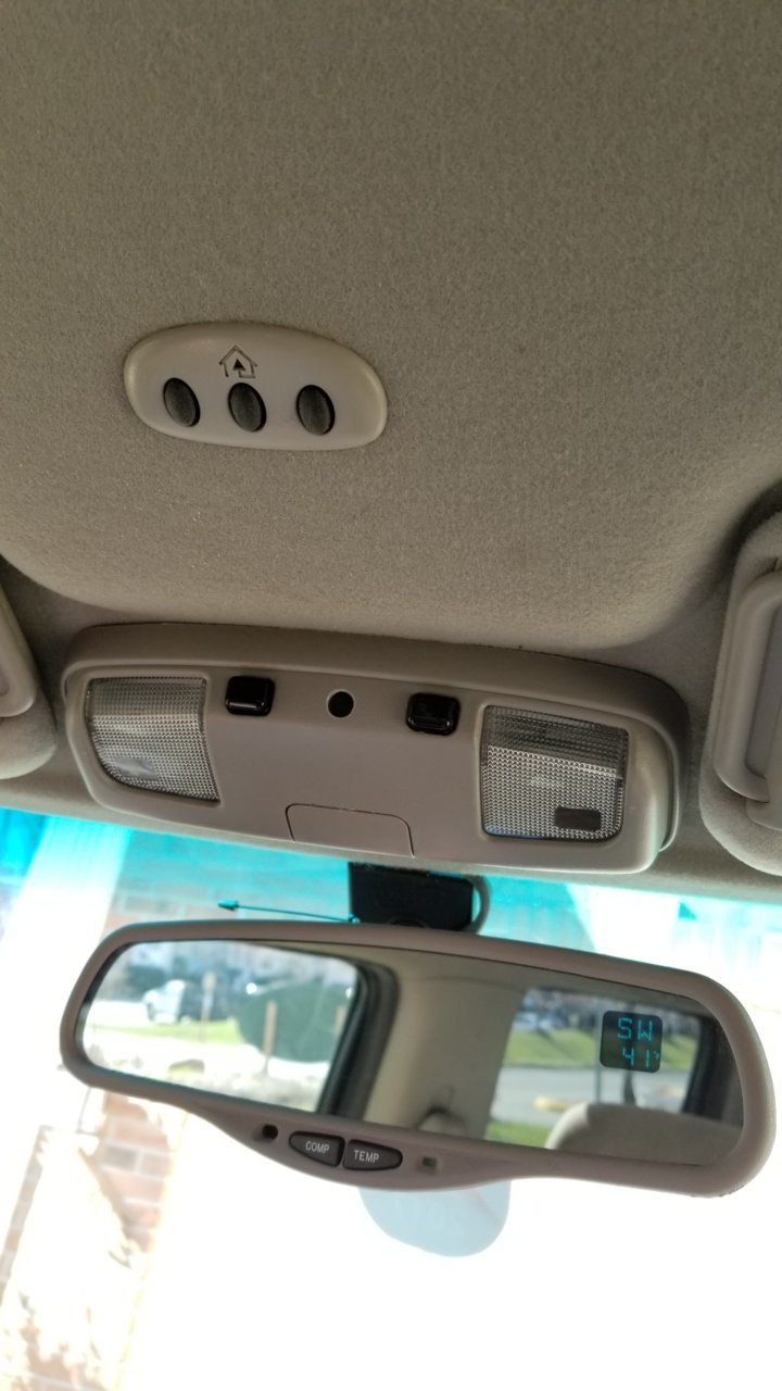

    Next mod, Gentex mirror from eBay with outside temp and compass. Also wired up a $13 homelink module (also from eBay). I painted the mirror and wired both up to ACC so homelink only works with the key. The hole in between the two map light buttons is for the blue tooth mic.

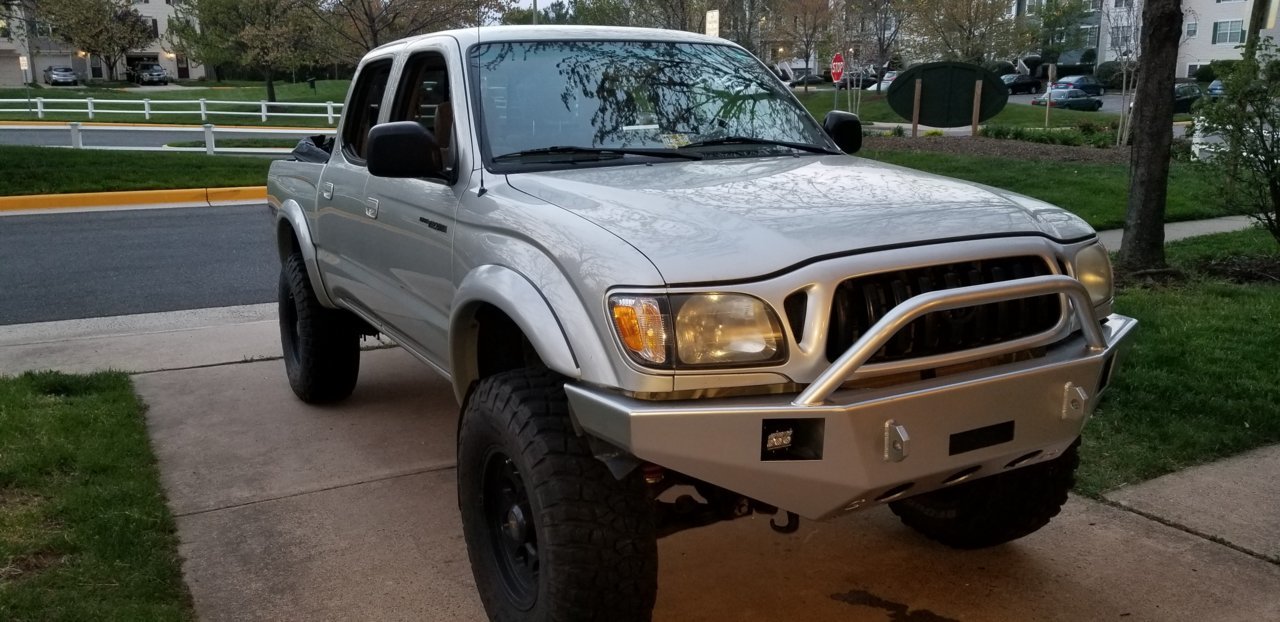

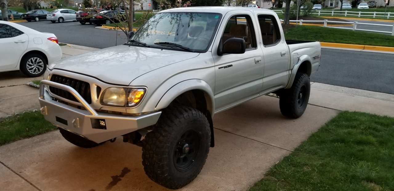

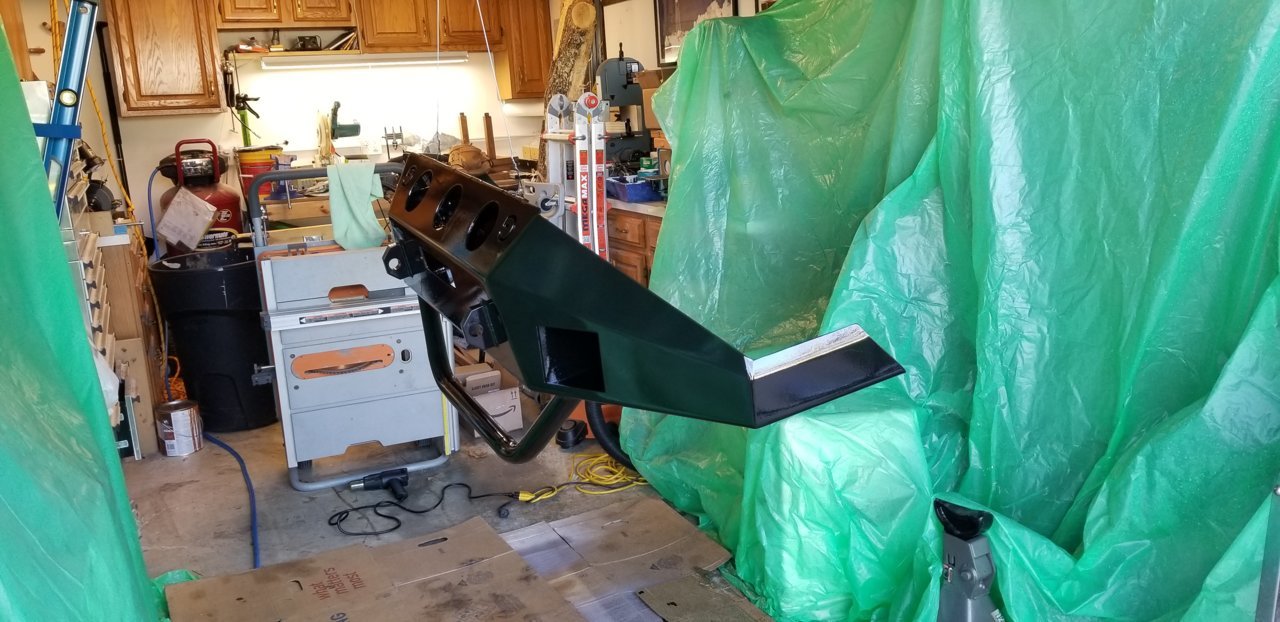

    Bumper Time!
    Decided to go with Grizzly metalworks cause I like the look of their bumpers and they are not guady looking. I also knew that I wanted to keep it as clean and seamless looking as possible by color matching instead of the traditional black. I had the bracket fitted and welded to the frame (Thank you NOVA Speed Shop) and now the bumper just bolts on to that. Here it is hanging in my garage ready for paint. First coat was POR15 because this thing was rusting after just 1 day out in open air.
    Second coat was an etching primer and then on to the base coat. I hesitantly chose duplicolor because it was easy to apply (and touch up later on) and so easy to match, however coming from a rattle can, the paint is soft and goes on thin. I probably should have bought more and applied a few more coats, but who has that kinda time? I topped it off with a two part clear cote so hopefully it will dry nice and hard. I will never be a great painter, I'm way too impatient. The finished product looks fantastic! If you look closely, yes, you will see drip marks and blemishes, but what do I care it's a winch bumper!
    Black D Rings and fog light wiring coming soon... Oh I forgot to mention the turn signals are now in the corner lamps! I did not take pics, but I hogged out the back of the light and used an LED switch back bulb that is a constant white with an amber signal. They look great, but now my headlights look like shit. Hmmm... I wander what's gonna be next...

    Yeah this took a lot of reading for me to understand as well, basically, all you need to worry about is backspacing. The backspacing is the distance from the mounting surface to the back (inside lip) of the rim, so as long as it's not more than 4" it won't hit any suspension parts. The tire width will then determine how much offset the rim will have because it's relative to the width of the rim. …so just get a rim with 4" of backspacing and you'll be fine.

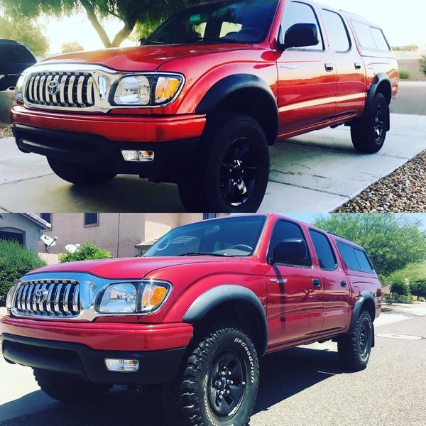

    My truck as it sat before and after the 255, 85 R16s
