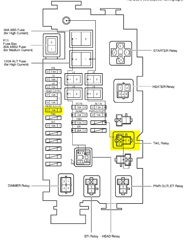

    I can not find a fuse for these "marker lights". Any ideas what else it might be called?
    I have no marker lights working. Both front and rear. They have recently stopped working. My headlights, white reverse lights and my break lights all work, but just not my marker or running lights (What ever they are called).
    And I can not find a fuse. Any help would be greatly appreciated.

    Fuse will be marked Tail.

    First check the 10A "Tail" fuse located in the fuse box in the engine compartment (next to the battery). If it is OK, then you may check if the "Tail Relay" is clicking - in the same fuse box.
    It's strange what you are saying. If the fuse is out (or no power via Tail Relay) then you will not have license plate light and none of dash/instrument panel lights (any light that is dimable).

    Thanks for all the help. It turned out to be a bad relay that worked and didn't work. I've fully replaced it and the problem has been fixed.
